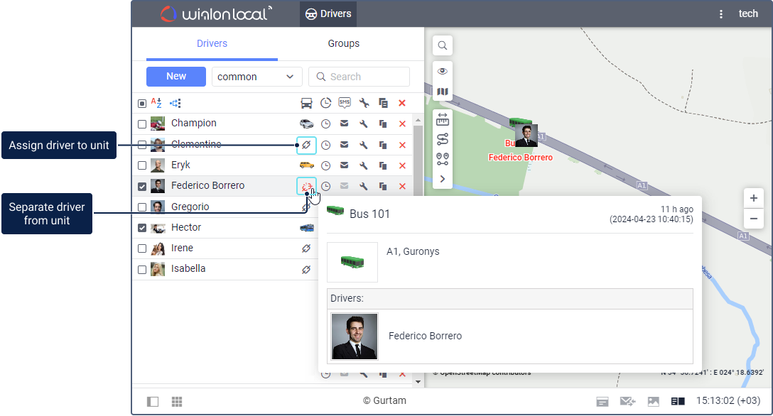

You can assign or separate a driver from a unit manually in the Drivers or Groups mode on the Drivers tab using the icons  and  respectively.

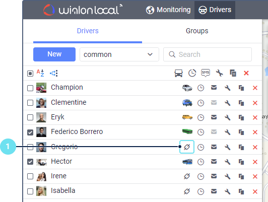

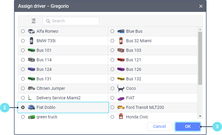

To assign a driver to a unit manually, follow these steps:
  1. Click on the icon opposite to the required driver in the list of drivers or their groups. If you don’t have the Create, edit and delete drivers access right to the resource, the icon is inactive ().
  2. In the open window, select the unit to which you want to assign the driver. Here you can see the units from the work list on the Monitoring tab. To see all units to which you have the View object and its basic properties access right, click on the icon  to the left of the search.
  3. Click OK.
After that, the icon of the selected unit is shown in the driver row.
To separate the driver from the unit, point to the unit icon in the driver row and click on the icon . You can also separate the drivers by registering new shifts for them or deleting their assignment (see more).

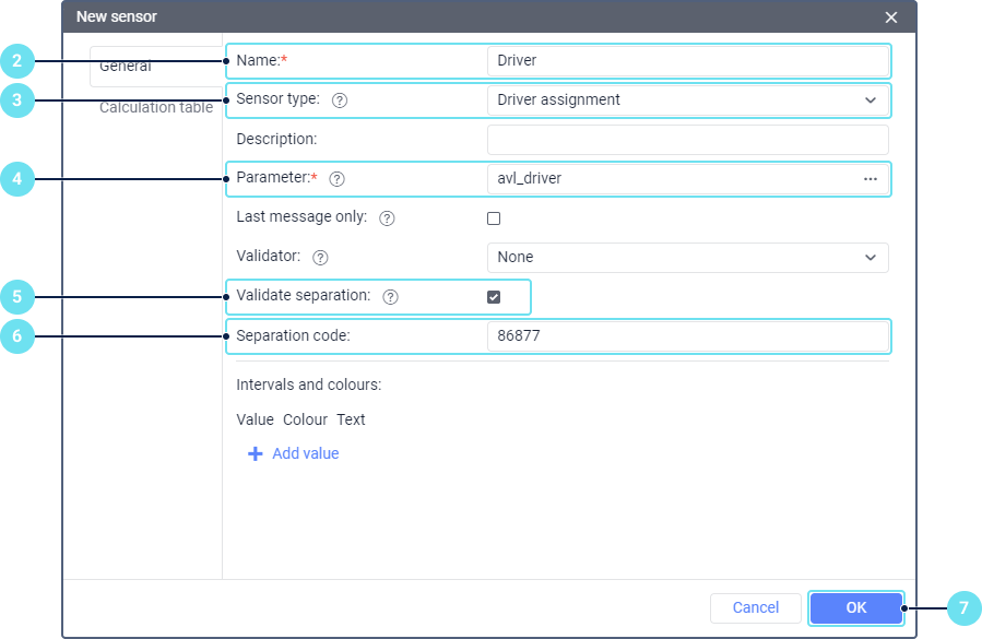

Sensor of the “Driver assignment” type

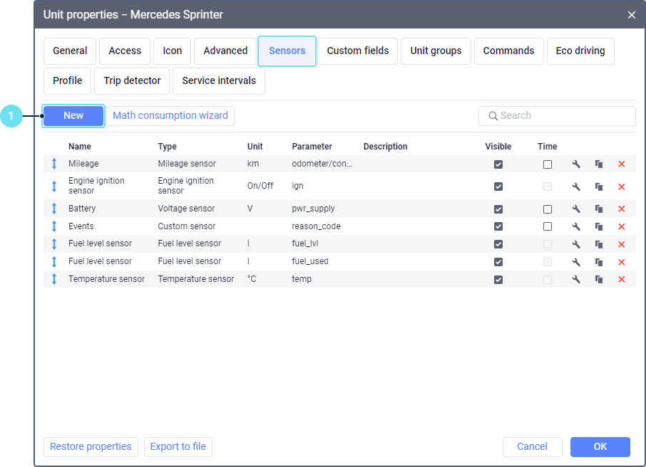

To create a sensor, follow these steps:
  1. Click Create on the Sensors tab in the properties of the required unit.
  2. Specify the sensor name.
  3. Select the Driver assignment type.
  4. Specify the sensor parameter according to the settings of the equipment. For example, avl_driver.
  5. If necessary, enable the Validate separation option. It may be useful if you want to create several sensors of the Driver assignment type with different parameters in the properties of one unit. If the option is activated, a driver assigned to the unit can be separated from it automatically only if an empty value or a separation code comes from the same parameter as the one used for assigning the driver. If the option is disabled, the empty value or the separation code received from any sensor leads to the separation of all the drivers assigned to the unit.
  6. If necessary, specify the separation code.
    Only text or integer parameter values (including after conversion) can be used as a separation code. In other cases, the sensor value is rounded and automatic separation doesn’t work.
  7. Click OK.

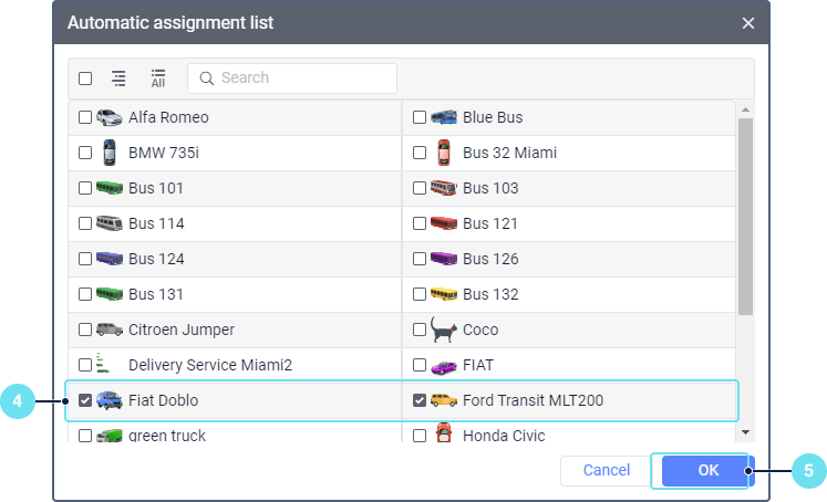

Automatic assignment list

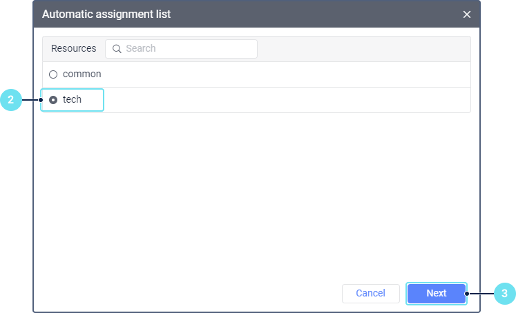

To create an automatic assignment list, follow these steps:

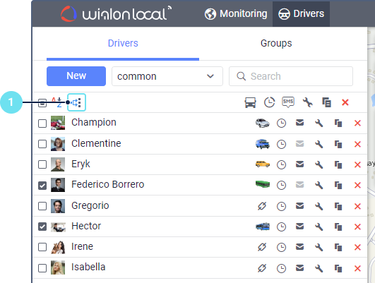

  1. Click on the icon  above the list of drivers.
  2. Select the resource for the drivers of which you want to configure automatic assignment. To find out which drivers belong to a certain resource, apply filtering by resource to the driver list (displayed to the right of the Create button). If only one resource is available to you, it is selected automatically.
  3. Click Next.
  4. Select the units or unit groups to which the drivers of the selected resource should be assigned automatically. To switch between the lists of units and their groups, use the icon /. For more information about the unit selection, see Creating jobs.
  5. Click OK.

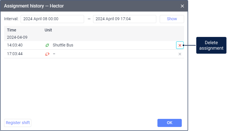

The Assignment history feature allows you to view the history of assignments, add records of assignments manually (register work shifts), and delete them if necessary. To perform these actions, click on the icon  to the right of the driver’s name.
To view the assignment history, specify the required interval and click Show. In the list of assignments, you can see the name of the unit, the date and time of the driver assignment and separation from it.
You can delete an incorrect assignment or separation by clicking on the icon  at the end of the row. If an assignment is deleted from the history, it is not shown in reports either.
You can’t delete the last registered assignment or separation.

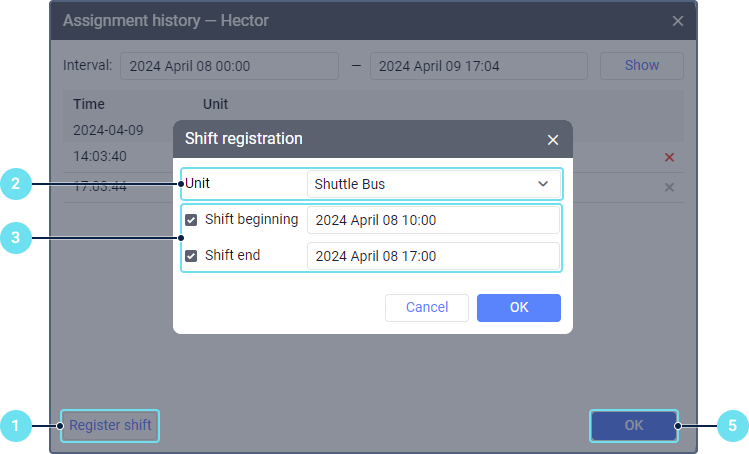

Registering shifts
To create a record of the driver assignment in the past, follow these steps:
  1. Click Register shift.
  2. Select a unit in the drop-down list.
  3. Specify the time of the shift beginning and/or end. To enable the Shift end field, put a check mark near it.
  1. Click OK.
