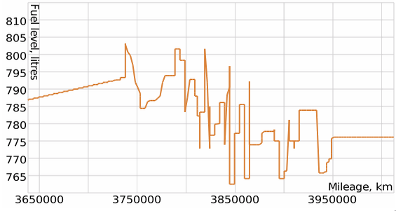

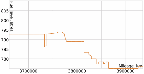

The images below show fuel level charts with median filtration turned off and on.
Chart with the disabled filtration Chart with the disabled filtration
Chart with median filtration enabled with a value of 10 Chart with median filtration enabled with a value of 10
