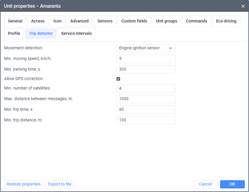

Movement detection methods
The selected movement detection method determines the way the trips are detected. The following methods are available:
Method Description
Speed This method can be used for all types of devices which send speed values determined by GPS or another source. If you select this method, a trip is detected when both of these conditions are met:
GPS coordinates This method can be used for devices which don’t send speed values, but transmit location data determined by GPS. If you select this method, a trip is detected when both of these conditions are met:
  • the coordinates in the received message are different from the ones in the previous message;
  • the parameters of the Allow GPS correction option are met (the option is enabled by default).
Engine ignition sensor This method is available only if the unit has a sensor of the same-name type. A trip is detected when these three conditions are met:
  • the engine ignition sensor is on;
  • the unit speed is higher or equal to the value from the Min. moving speed field;
  • the parameters of the Allow GPS correction option are met (if this option is enabled).
A trip is terminated if the engine ignition sensor is off or the speed value is less than the minimum one. The trip also ends if the timeout specified for the sensor is exceeded.
Mileage sensor This method is available only if the unit has a sensor of the same-name type which sends absolute mileage values. A trip is detected when these three conditions are met:
  • the mileage sensor value has increased;
If the speed value is invalid or unavailable, the unit movement is detected according to the increase in the mileage sensor values.
Relative odometer This method is available only if the unit has a sensor of the same-name type which determines the distance travelled by the unit since the last message. A trip is detected when these three conditions are met:
  • the relative odometer value is greater than zero;
If the speed value is invalid or unavailable, the unit movement is detected according to the non-zero values of the relative odometer.
Movement parameters
After you select the movement detection method, specify values of parameters which should be taken into account in trip, stop and parking intervals.
ParameterDescription
Min. moving speed
The minimum speed value which should be considered as the beginning of movement. It is specified so that the outliers of GPS coordinates and device errors are not considered as movement when the unit is parked.
Min. parking time
To detect parking intervals, specify the minimum number of seconds during which the unit should be motionless in order for the system to consider it as parked. If the unit has been parked for less than the specified time, it is considered as a stop within the trip.
If during a trip the time between two successive messages is greater than or equal to the specified value, the trip ends.
If the Allow GPS correction option is enabled, the minimum value of this parameter should be 10 seconds.
The Allow GPS correction option is always enabled for the Speed and GPS coordinates movement detection methods. If you use another method, you can disable this option. If the option is enabled, you should specify the values of the following parameters:
Min. number of satellites
Specify the minimum number of available satellites to detect a trip. The recommended number is at least four.
Max. distance between messagesSpecify the maximum distance between two messages after which the current movement interval should be stopped and a new one started. This value should be indicated in meters.
Min. trip timeSpecify the minimum movement time in seconds which should be considered as a trip. This is required to exclude false detections of trips, for example, during short movements in a car park or a traffic jam. This parameter is applied to a sequence of messages.
Min. trip distanceSpecify the minimum distance in meters which the unit should travel so that its movement is considered as a trip. This is required to exclude possible equipment errors when determining the unit location. This parameter is applied to a sequence of messages.
