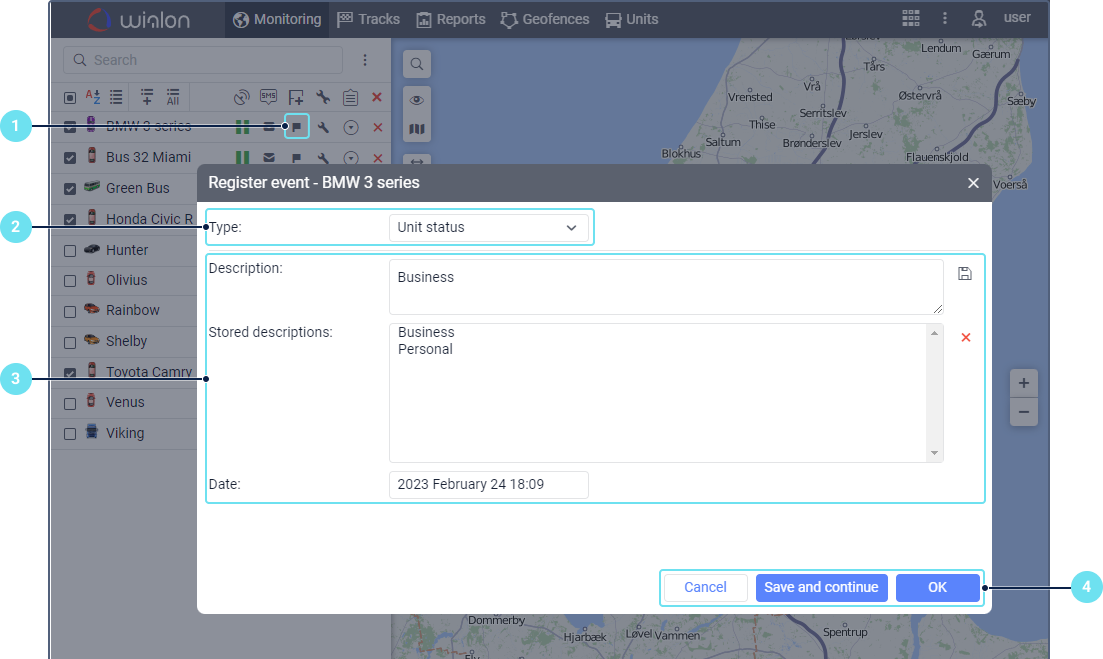

The Event registration option on the Monitoring tab allows you to make records in the unit log and register events for the unit in order to see them later on the Messages tab and in reports. This option allows you to register the following types of events:
To make a record in the unit log or register an event for the unit, follow the steps below.
  1. Click on the icon   opposite the required unit in the work list of the Monitoring tab. If there is no such icon, enable the Event registration option in the customizer of monitoring options.
  2. Select the type: a record in the unit log or one of the available events.
  3. Fill in the rest of the fields. They depend on the selected type (see below).
  4. Click Save and continue to register a record or an event and proceed to adding the following one, or click OK to save the changes and close the window.
The units of measurement used in the event registration window depend on the system of measurement used for the unit.
You can’t edit the registered events and records. You can only delete them from the unit history on the Messages tab. This requires the Delete messages access right to the unit.

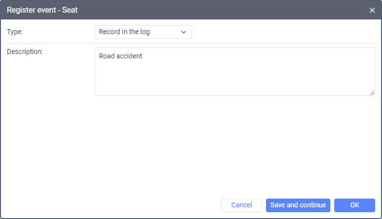

Record in the log
Select this type to make a record of any kind in the unit log. It is saved as a custom record with the indication of its creation time.
You can see the registered records in the messages of the Log type and in the report table of the same name.

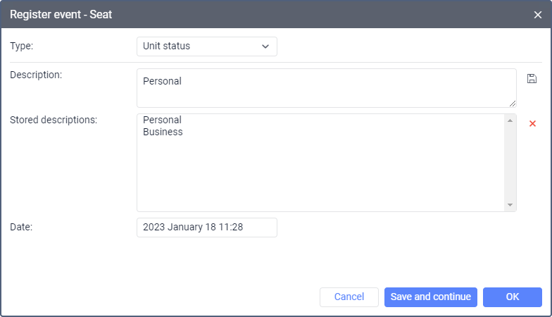

Unit status
Select this type to register any unit status, for example, personal or business use of the vehicle.
To register a status, specify the following parameters:
Parameter
Description
Description
The name and/or description of the status. You can save the entered description to be able to use it later when registering statuses for this or other units. To save the description, click  to the right of its field.
To use the saved description, select it in the list. To delete the saved description, select it and click on the icon .
Date
The date and time of the event. You can specify it using the calendar. The current date and time are shown by default.
The statuses can be registered automatically by means of notifications with the Register event status notification action (for example, when entering a geofence).
You can see the registered statuses in the Events and Chronology report tables. Also, the Status column is available in the Trips, Unfinished trips, Trips between geofencesEngine hours, and Parkings report tables.

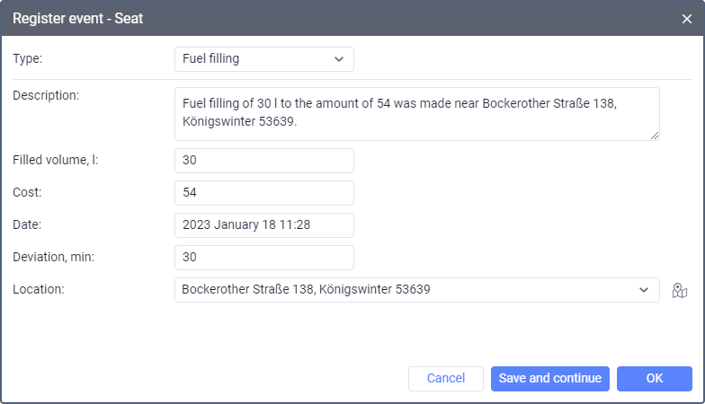

Fuel filling
Select this type to register a fuel filling for the unit, including data on its volume and cost. If a fuel level sensor is configured for the unit, you can compare the specified volume data with the sensor readings in the Fuel fillings report.
To register a fuel filling, specify the following parameters:
Parameter
Description
Description
The information about the fuel filling. By default, this field shows a text to which the filling volume and cost values are automatically added when you specify the parameters below. You can edit the description if necessary.
Filled volume
The volume of the filled fuel. Fractional values (to the nearest hundredth) are allowed. Use a dot as a separator.
Cost
The cost of the filling. Fractional values (to the nearest hundredth) are allowed. Use a dot as a separator. For example, to register a cost of 77 dollars 88 cents, enter 77.88.
Date
The date and time of the filling. You can specify it using the calendar. The current date and time are shown by default.
Deviation
The possible deviation from the specified filling time in minutes.
Location
The place where the vehicle was refuelled. You can specify it in the same way as for a custom event.
The registered fuel fillings are displayed in the following report tables: EventsFuel fillingsUtilization costChronology.

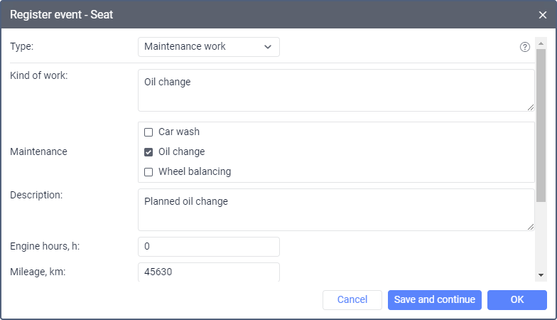

Maintenance work
Select this type to register a maintenance service for the unit and specify its cost. This allows you to record maintenance costs and reset service intervals so that the system starts the countdown to the next service based on these intervals again.
To register a maintenance service, specify the following parameters:
Parameter Description
Kind of work The name of the service. You can enter it manually or select from the Maintenance list (if available).
Maintenance A list of services generated based on the service intervals created in the unit properties. Select the services that have been carried out so that they are automatically inserted in the Kind of work field. The corresponding service intervals in the unit properties will be reset and the countdown of days, engine hours and/or kilometers to the next service will be restarted.
Description The description of the service.
Engine hours The value of the engine hours counter. The current value is shown by default, but you can edit it.
Mileage The value of the mileage counter. The current value is shown by default, but you can edit it.
You can’t specify a value which is greater than 2147483 km.
Cost The cost of the service.
Duration The duration of the service. You can select days, hours or minutes in the drop-down list.
Date The date and time of the service. You can specify it using the calendar. The current date and time are shown by default.
Location The place where the service was carried out. You can specify it in the same way as for a custom event.
The registered services are displayed in the following report tables: EventsMaintenanceUtilization costChronology.
