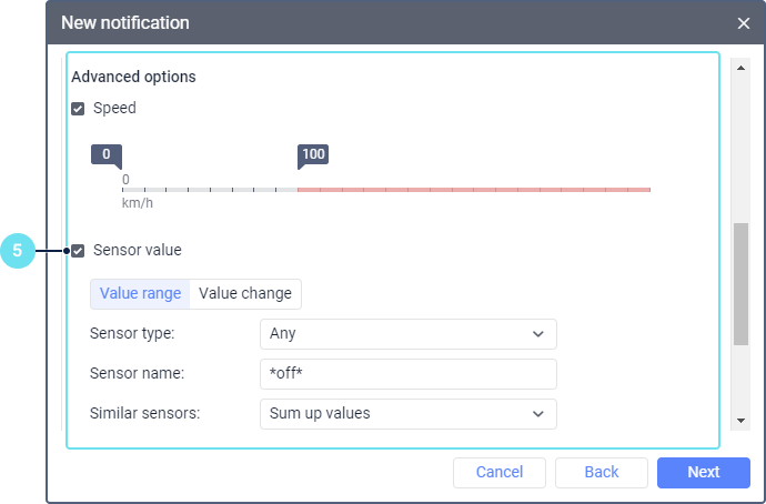

Sensor value
If this option is enabled, there is an additional condition for triggering the notification: a specific sensor value. The option is configured similarly to the notification type of the same name.
Speeding can’t be detected on the basis of a message with Wi-Fi or LBS data, as the speed value in such a message is considered to be zero.

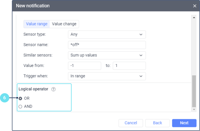

  6. Select the logical operator on the basis of which the notification should be triggered if several geofences are selected. The OR and AND operators are available.

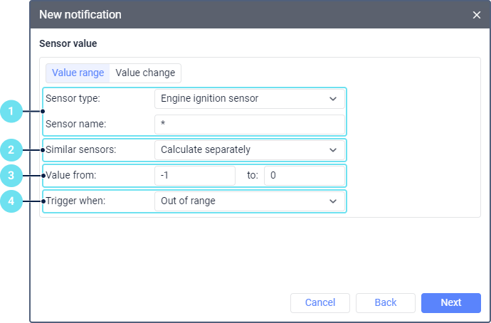

Sensor value
For a notification of this type, two control methods are available:
  • Value range. Allows specifying a range of sensor values to control whether the received values fall in it or not.
  • Value change. Allows specifying one value to control whether the received values exceed it or not.
This notification can’t control the values of the sensors which use parameters from previous messages. In this case, the notification won’t be triggered.
For the Value range method, follow these steps:
  1. In the drop-down list, select the sensor type and/or in the Sensor name field, specify the name mask using special characters (* and ?).
  2. In the Similar sensors drop-down list, select one of the available options:
    • Sum up values. The values of all sensors of the selected type and/or sensors with the same name mask are summed up. Thus, the sum of all values is taken into account before the notification is activated.
    • Calculate separately. The values of all sensors of the selected type and/or sensors with the same specified name mask are controlled separately.
  3. Specify the minimum and maximum values of the sensor.
  4. Select the activation type:
    • In range. The notification is activated when receiving values which fall in the specified range, including the values specified as minimum and maximum ones.
    • Out of range. The notification is activated when receiving values which don’t fall in the specified range.
For the Value change method, open the same-name tab on the right and follow steps 1 and 2 from the instruction above. In the Delta field, specify a difference when exceeding which the notification should be triggered. The sensor values can be increased or decreased because the specified delta is compared with the module (for example, |12 − 10| = 2 and |10 − 12| = 2).

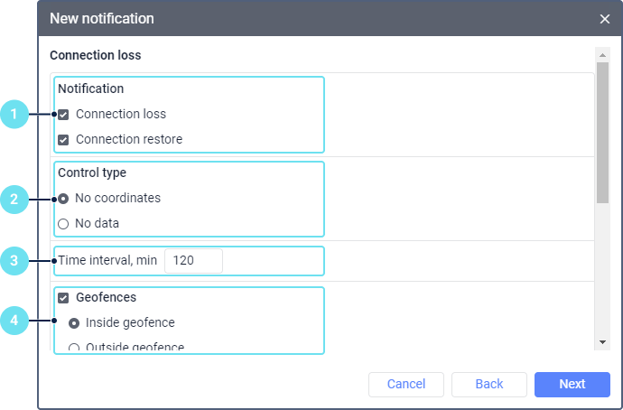

Connection loss
To configure a notification of this type, follow the steps below:
  1. Select when the notification should be triggered: when the connection is lost or restored. You can select both options.
  2. Select in what way the connection loss should be detected:
    Control typeDescription
    No coordinates
    If this option is selected, the connection loss refers to the absence of coordinates in the unit messages or the absence of the messages themselves.
    It may happen that messages with sensor data are sent but they don't contain data on the unit location (for example, if the GPS antenna is closed).
    No dataIf this option is selected, the connection loss refers to the absence of any messages from the unit.
  3. In the Time interval field, specify how long the connection loss should last in order for the notification to be triggered. The maximum allowed value is 999,999 minutes.
  4. If necessary, specify if the unit should be inside or outside a certain geofence as an additional condition for triggering the notification. To configure the Geofences option, follow steps 1–4 from the guide on configuring the notification of the same name.

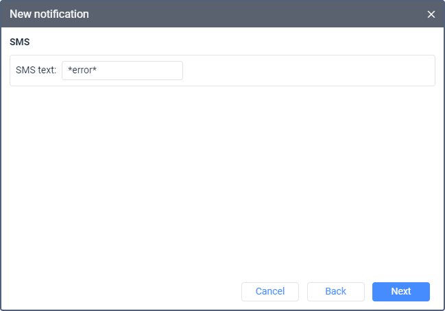

SMS
A notification of this type informs the receiver of getting an SMS message. An asterisc (*) is specified in the SMS text field by default, which means that the notification works for any SMS message. You can specify a mask of a message text so that the notification is triggered only if an SMS message contains the specified text. This may be useful, for example, if the device sends an SMS message with a certain content in case of malfunction.

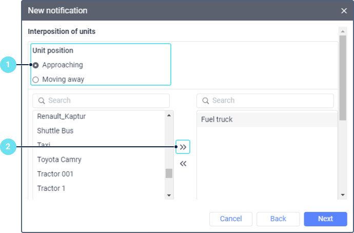

Interposition of units
Using notifications of this type, you can monitor whether the units are approaching or moving away from one another.
To configure a notification, follow the steps below.
  1. Select when you want to receive the notification: when the unit is moving away from another unit or approching it.
  2. Move the units you want to monitor to the right part of the window. To find the required unit, use the dynamic filter above the list.
  3. In the Radius field, specify the distance between the units upon the reduction or increase in which the notification should be triggered.
The system checks the distance between the units only on the basis of their latest messages.

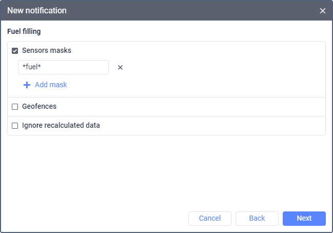

Fuel filling
A notification of this type allows you to monitor fuel fillings.
In the Sensor masks option, you can specify one or several masks of the sensors that should be used for detecting fuel fillings and their volume.
The notification is triggered for each fuel level sensor individually. The Calculate fuel consumption by sensor option in the sensor properties doesn’t influence this notification type, that is, if the option is disabled, notifications continue to be triggered.
If the Ignore recalculated data option is enabled, the notification is received only once after a filling is detected.
If the Geofence option is enabled, it is an additional trigger condition whether the unit is inside or outside a certain geofence during the filling. To configure the option, follow steps 1–4 from the guide to the same-name notification type.

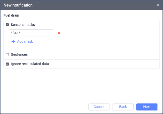

Fuel drain
A notification of this type allows you to monitor fuel drains.
In the Sensor masks option, you can specify one or several masks of the sensors that should be used for detecting fuel drains and their volume.
If the Ignore recalculated data option is enabled, the notification is received only once after a drain is detected.

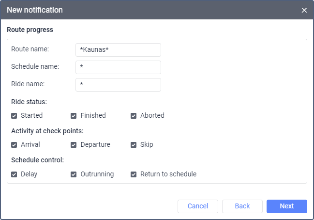

Route progress
Notifications of this type are used to monitor the unit movement along the route. You can receive notifications related to the following route changes:
  • Ride status (started, finished and aborted);
  • Activity at check points (arriving, departing and skipping a check point);
  • Schedule control (delay, outrunning, and return to the schedule).
Additionally, you can specify the name mask of the route, schedule and/or ride.

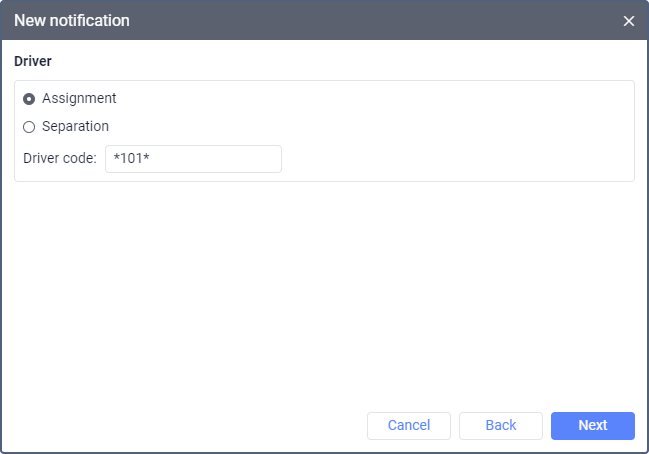

Driver
Notifications of this type allow you to monitor when drivers are assigned to the units or separated from them.
The Driver code field is available only for notifications about assignments. Here you can specify the driver code or its mask to receive notifications when this driver is assigned to a unit. You can enter several codes or code masks separated by commas without spaces. If an asterisk (*) is specified in this field, the notification is applied to all the drivers.
A notification about separation is triggered if any driver is separated from a unit.

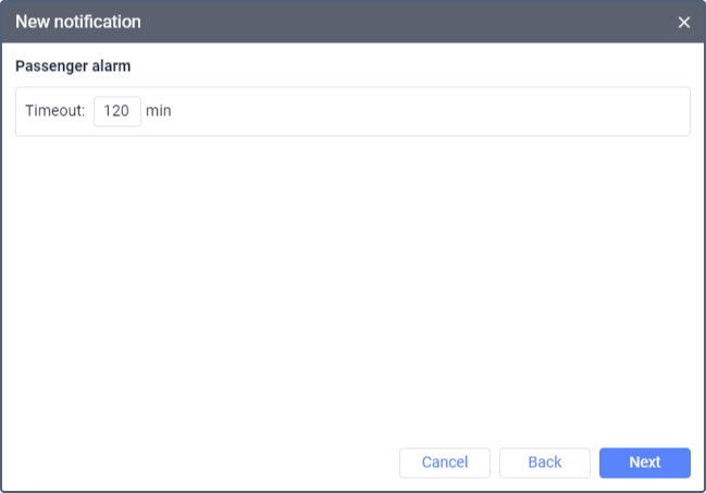

Passenger alarm
A notification of this type is triggered if any passenger of the seleted resource hasn’t got off the vehicle (that is, hasn’t been separated from the unit) within the specified timeout. The timeout is counted from the moment the passenger is assigned to the unit.

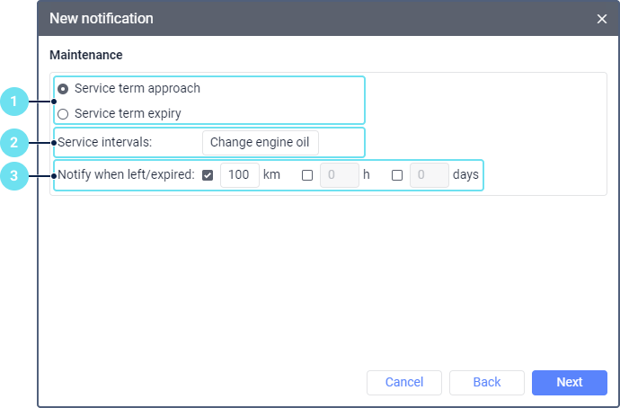

Maintenance
Notifications of this type are used for the services created on the Service intervals tab of the unit properties.
To configure a maintenance notification, follow these steps:
  1. Select when you want to receive notifications: before or after the service term (the Service term approach and Service term expiry buttons, respectively).
  2. In the Service intervals field, specify the name of the service for which you want to configure the notification. To specify several names, use the name mask. If the symbol * is specified in the field, the notification is applied to all created intervals.
  3. To be notified of the service term approach, specify how many kilometers, hours, and/or days should be left before the beginning of the service term so that the notification is triggered. To be notified of the service term expiry, specify how many kilometers, hours, and/or days should pass after the expiration of the service so that the notification is triggered.
    Example. Vehicle maintenance must be performed every 15,000 km, so a service interval by mileage with a value of 15,000 km has been created for the unit. Also, a notification of the approaching deadline with a value of 1,000 km has been configured. Assuming that the mileage is counted from 0, the notification will be triggered when the mileage is 14,001 km.
The maintenance notification is triggered only once when at least one of the conditions specified in step 3 is fulfilled. After performing maintenance work, register it using the event registrar or in the unit properties so that the notification term is counted again.
