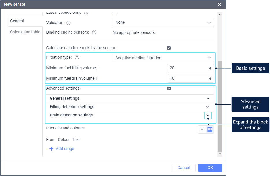

Basic settings
The basic settings of the fuel level sensor include three options.
Filtration type
This option allows filtering the sensor values to avoid data outliers (sudden changes in the fuel level: rises or falls). Filtration is taken into account in reports (in tables and charts when displaying smoothed lines), in jobs for sending fuel level information, and in notifications about fuel fillings and drains.
The drop-down list contains three items:

Minimum fuel drain volume
The minimum decrease in the fuel level which should be considered a drain. The value of this field should be greater than 0 and can be fractional.
Minimum fuel filling volume
The minimum increase in the fuel level which should be considered a filling. The value of this field should be greater than 0 and can be fractional.
Advanced settings
The system uses default values for the advanced settings, but you can change them if needed. To do this, activate the Advanced settings option and edit the values in the General settings, Filling detection settings, and Drain detection settings blocks. If the Advanced settings option is deactivated, the edited values are replaced by the default ones.

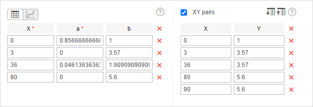

How to determine fuel consumption, if I know how much fuel the unit consumes within the city, and how much outside it?
Let us suppose that the fuel consumption in the urban cycle is 10 l/100 km and 7 l/100 km — in the suburban cycle.
  • Create an ignition sensor (as in the example above) and set 1 l/h for the consumption during idling.
  • The average consumption in the urban cycle is 36 km/h, in the suburban — 80 km/h.
  • The unit will cover a distance of 100 km driving at a speed of 36 km/h in 2.8 hours. 10 l / 2.8 = 3.57. Let us calculate the value of the increasing coefficient when moving in the city: 3.57 / 1 (idling) = 3.57.
  • As a result of a similar calculation for the suburban cycle, we obtain the coefficient equal to 5.6.
  • Create an engine efficiency sensor, taking into account the fact that the unit cannot consume less fuel than during the idling, and that it is stationary before the beginning of the movement. As a parameter we use the average speed (speed + # speed) / const2 and fill in the calculation table (manually or using the calculation table wizard):
Note that the last pair of points is how the system calculated before (the fuel consumption was considered constant for a speed above 80 km/h). You cannot use this method and change the set of points. Also ‘3’ in this example is the minimum speed from the unit’s trip detector, consequently, this parameter can be different for your unit.
Result: in our example, the average consumption has been calculated for the unit. It has been calculated relative to the speed and time between messages and taking into account the values of the vehicle operation.
