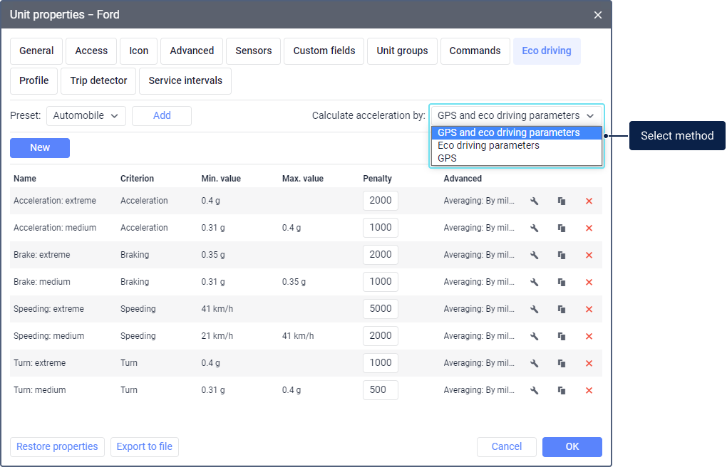

Calculating acceleration
Acceleration is the difference in the unit speed divided by the difference in time. The movement direction of the unit allows determining the acceleration type: speeding, turn, reckless drivings, etc.
When calculating acceleration, the following data is used:
  • unit location;
  • initial and final speed values;
  • travel time between two points;
  • unit movement direction;
  • values of special parameters sent by the device.
Three methods for calculating acceleration are available.
Method Description
GPS and eco driving parameters The acceleration is calculated both according to the data on the unit location, speed, movement direction and time and on the basis of special parameters sent by devices: wln_accel_max, wln_brk_max, and wln_crn_max. Then the system selects a higher value.
Eco driving parameters The acceleration is calculated by the device and is displayed in the device messages as special parameters which contain the maximum speed values for the period between two messages: wln_accel_max, wln_brk_max, and wln_crn_max. These parameters can be received only from some devices. The calculation method based on the eco driving parameters is more accurate because the calculation doesn’t depend on the frequency of sending data.
The messages in which the unit location is determined by LBS or Wi-Fi points are not taken into account when calculating acceleration.
GPS The acceleration is calculated according to the data on the unit location, speed, movement direction and time. For a more correct calculation, set the minimum possible interval of sending messages on your device, but not less than 2 seconds. It is advisable to use this method only if you can’t use the previous one.
By default, the acceleration is calculated according to the GPS and eco driving parameters method.
You can select the required calculation method depending on the type of equipment used.
The selected method is applied to all the configured criteria, except for the criteria of the Speeding and Custom types.

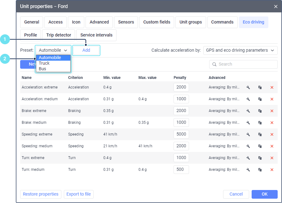

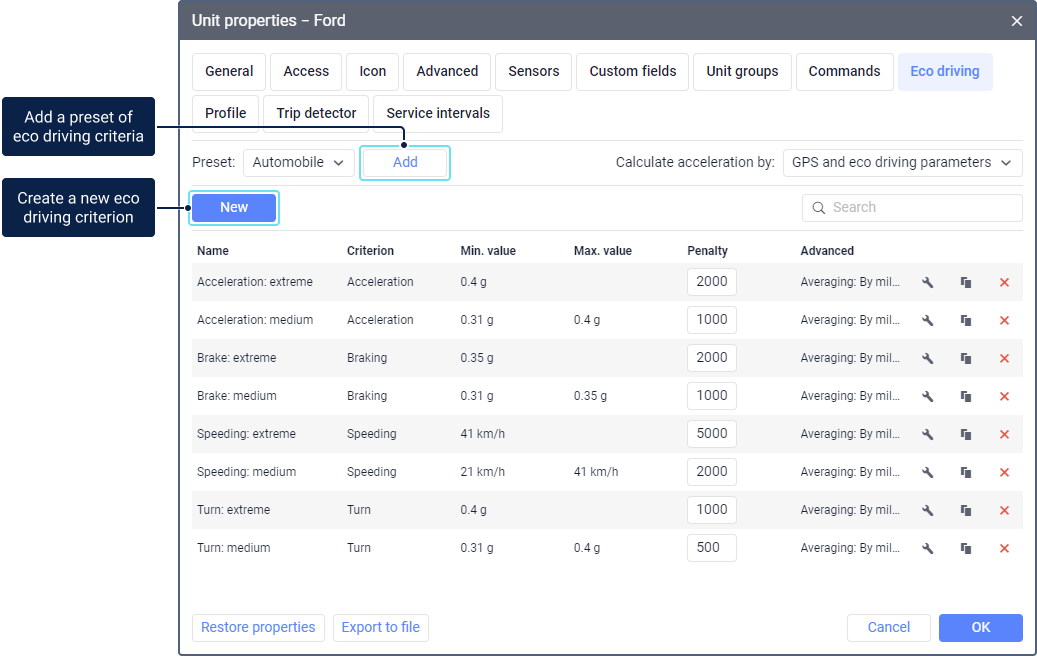

You can add eco driving criteria by applying a preset or create them manually.
Adding criteria using a preset
Depending on the vehicle type, you can add a list of criteria with the already configured parameters. To do this, select the required preset from the three available options (Automobile, Truck, Bus) and click Add.
The criteria of the selected preset are automatically added to the list.

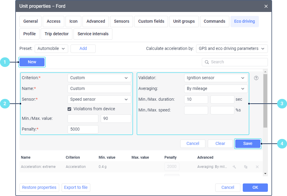

To create a new criterion manually, follow the steps below.
  1. Click New.
  2. Specify the basic parameters of the criterion.
  3. If necessary, specify the advanced parameters.
  4. Click Save to save the criterion. To discard the changes, click Clear. To cancel adding the criterion, click Cancel.
Basic parameters
To configure the criterion, specify its basic parameters. The required fields are marked with an asterisk (*).
ParameterDescription
Criterion*
Select one of the available criteria which should be used when assessing the quality of driving:
  • Speeding, km/h. Allows you to detect excessive speedFor this criterion, you should specify a value by which the speed can be exceeded. Speeding is detected according to road limits (provided that the road limit is higher than 30 km/h).
  • Acceleration, g. Allows you to detect sharp increases in speed.
  • Braking, g. Allows you to detect sharp brakings.
  • Turn, g. Allows you to assess the quality of performing turns, taking into account the unit direction and speed.
  • Reckless driving, g. Allows you to detect sharp increases in speed followed by sharp brakings. According to the specified parameter, the system determines the largest violation values and the intervals at which they were determined. If several criteria of the Reckless driving type with different parameters are added, the system selects the most appropriate criterion for each violation. After that, advanced parameters are taken into account, if specified.
  • Custom. Allows you to detect violations using the values of the selected sensor.
Each violation is fined by adding the number of penalty points specified in the Penalty field.
Name*Specify the name of the criterion.
Sensor*
The parameter is available only when the Custom criterion is selected. In the drop-down list, select one of the created sensors the values of which should be used when detecting violations.
If a digital sensor is selected, the Violations from device option is available. If you activate this option, the violation duration coincides with the interval of the sensor operation.
Min./Max. value
Specify the minimum and maximum values of the selected criterion which should be considered a violation. If the received value of the criterion falls in the specified interval, a violation is detected.
The interval doesn't include the value that you specified as the maximum one.
For the Speeding criterion, the values are specified in km/h; for the Acceleration, Braking, Turn, Reckless driving criteria, in g. For the Custom criterion, the values of the selected sensor are specified.
Penalty*
Specify the number of penalty points which should be added for each violation according to the selected criterion.
The intervals of all criteria, except for the Custom one, can be combined. For example, if one violation is followed by another one based on the same criterion within 10 seconds, these violations are combined.
Advanced parameters
If necessary, specify the advanced parameters of the criterion.
Validator
In the drop-down list, select one of the created sensors you want to use as a validator for confirming or rejecting the received values of the selected criterion. If at least one positive value of the validator is received, a violation is detected.
After selecting the validator, the Multiplier option is available. If you activate it, the number of penalty points for the violation is multiplied by the value of the selected sensor. For example, if you want to monitor speeding when transporting goods, you can create a weight sensor, select it as a validator, and activate the Multiplier option. If the vehicle is not loaded with goods, the sensor value is zero; if loaded, the value is greater than zero. In this case, if the speed is exceeded when transporting goods, the number of specified penalty points is multiplied by the validator value.
Averaging
Select one of the available options to calculate averaging:
  • By mileage. The total number of penalty points added for the trip is divided by the number of kilometers travelled during the trip. Therefore, the system determines the average number of penalty points for each kilometre of the trip.
  • By time. The total number of penalty points added for the trip is divided by its duration. Therefore, the system determines the average number of penalty points for each minute of the trip.
If the averaging is disabled (the None option), all the penalty points of the trip are summed up.
Averaging by mileage and by time doesn't apply to trips the duration of which is less than a minute.
Min./Max. durationSpecify the duration range of the criterion in which violations should be detected. If the criterion duration exceeds the specified minimum value, a violation is detected. If the criterion duration exceeds the specified maximum value, the number of penalty points is multiplied by the number of maximum values of the criterion for the violation interval.
Min./Max. speed
Specify the speed range at which violations should be detected. The system determines the maximum speed at the violation interval and compares it with the values specified in these fields. If the speed falls in the specified range, a violation is detected.
For example, you can specify only the minimum speed here. This allows not taking into account violations (speedings, accelerations, brakings, etc.) when moving at a speed the value of which is less than the specified one.
