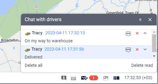

The driver can also send SMS messages to the operator to the monitoring system using their mobile phone. To do this, the driver’s phone number should be specified in the driver properties in the monitoring system. The operator’s phone number depends on the modem used in the service for sending SMS. The easiest way to find out this number is to send a message to the driver from the monitoring system.
Messages sent by the driver are shown in the log and in the Chat with drivers window in the same way as commands sent from the device. In this window, you can reply to the driver’s messages by clicking on the icon .
The driver’s and operator’s SMS messages are also shown in the SMS messages table of the advanced report on drivers.
