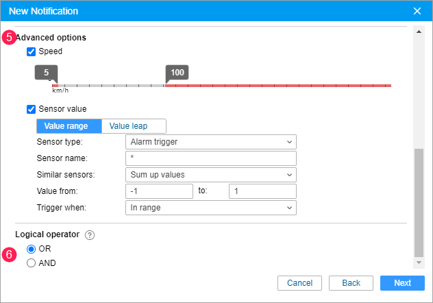

In the Advanced options section, if necessary, specify the additional conditions under which the notification should be triggered. It can be the range of speed values (the Speed option), and/or the range or the difference of the selected sensor values (the Sensor value option).
Select the logical operator on the basis of which the notification should be triggered if several geofences are selected. The OR and AND operators are available.

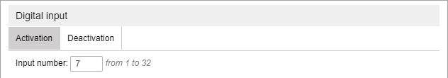

Digital input
Specify the number of digital input and the control type: trigger in case of its activation or deactivation. If the message does not have the I/O parameter, the io_n parameter is analysed.

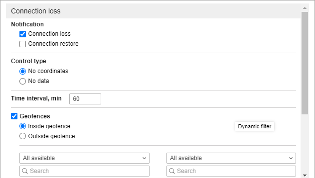

Connection loss
The notification can trigger when the connection is lost or restored. Select the required option in the Notification section. You can select both options at once.
Then select the control type.
Control type | Description |
No coordinates | There are also cases when all sensors are active and their values are known, but it is impossible to locate the unit (for example, someone has covered the GPS aerial). |
No data | It can be a simple connection loss when no messages are received from the unit during a period of time. |
Set the loss time of data/coordinates (in minutes), after which the notification should trigger.
Using the Geofences option, you can monitor connection loss in regards to specific geofences or groups of geofences. Specify the control type: trigger inside or outside a geofence. Select the resource whose geofences should be shown in the list (select All available to view the geofences of all available resources). Select the geofences or groups of geofences (shown in the square brackets), for which this notification should work.
Note that the geofences should be created in advance. For the search convenience, you can use the dynamic filters above the lists.

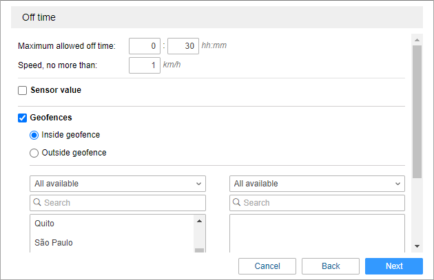

Off time
A notification of this type is used to monitor vehicle off time.
In the Max allowed off time field, you should specify for how long a vehicle can be parked; and in the Speed, no more than field, you should indicate what speed shouldn’t be exceeded during off time.
The maximum value for the Max allowed off time field is 47 hours 59 minutes.
To avoid situations where the notification is triggered because of the device inaccuracy, it is advisable to specify a speed value of more than 0 km/h, for example, 1—5 km/h.
If the Sensor value option is activated, the notification is triggered only if all the specified conditions are met: off time duration, speed, and the sensor value. For example, you can receive notifications when the unit is parked with the engine or attachments running. This option is configured in the same way as the notification type of the same name.
Also, whether the unit is inside or outside a certain geofence can be an additional condition for triggereng the notification. For this purpose, enable the Geofence option and configure the settings described in steps 1—4 in the same-name notification type.

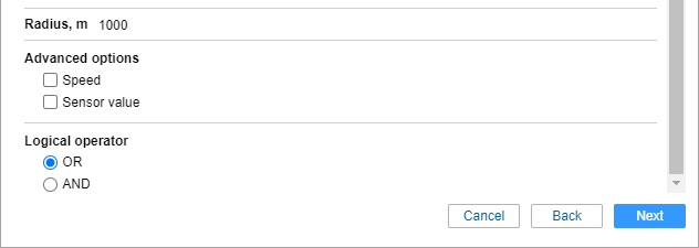

Interposition of units
This notification allows you to control the interposition of units: their approaching and moving away from each other. Select the criterion (approaching or moving away) and transfer from the left list to the right one the units whose approaching or moving away should trigger the notification. You can use the dynamic filter above the list to search.
Specify the settings described below.
Setting | Description |
Radius, m | The distance between the units with decreasing or increasing of which the notification should be triggered. |
Advanced options | Filters for speed and sensor value. |
Logical operator | The value on the basis of which the notification is triggered. If OR is selected, the notification is triggered when the unit approaches or moves away from any of the selected units. If the logical operator AND is selected, the notification is triggered when the unit approaches or moves away simultaneously from the marked units. |
The interposition of units is checked by the system using the latest messages only.

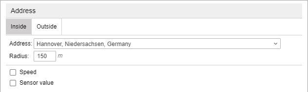

Address
This type of notification is similar to geofence control. It allows you to control the entrance/exit or being in or out of a particular place. Enter some address parameters (e.g. city, street, and house) and then select the most appropriate option from the found addresses. Also, specify the radius of the point. In addition, filters for the sensor and speed can be applied.

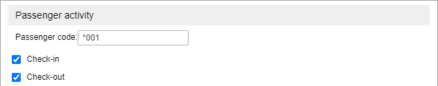

Passenger activity
To receive notifications of passenger’s activity, choose the control type (check in/check out) and enter the passenger’s code or code mask. You can add several codes or code masks separated by commas without spaces. If you leave the asterisk sign (*) in the field, all the passengers will be controlled.

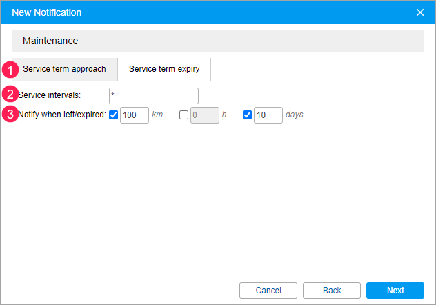

Maintenance
Notifications of this type are used for services created on the Service intervals tab of the unit properties.
To configure a maintenance notification, follow these steps:
Select when you want to receive notifications: before or after the service term (the Service term approach and Service term expiry buttons, respectively).
In the Service intervals field, specify the name of the service for which you want to configure the notification. To specify several names, use the name mask. If the symbol * is specified in the field, the notification is applied to all created intervals.
To be notified of the service term approach, specify how many kilometers, hours, and/or days should be left before the beginning of the service term so that the notification is triggered. To be notified of the service term expiry, specify how many kilometers, hours, and/or days should pass after the expiration of the service so that the notification is triggered.
The maintenance notification is triggered only once when at least one of the conditions specified in step 3 is fulfilled. After performing maintenance work, register it using the event registrar or in the unit properties so that the notification term is counted again.
Notifications of this type are not triggered if:
- a unit with an already expired service interval is selected when creating a notification;
- the unit for which the notification is created doesn’t have any positional messages.
