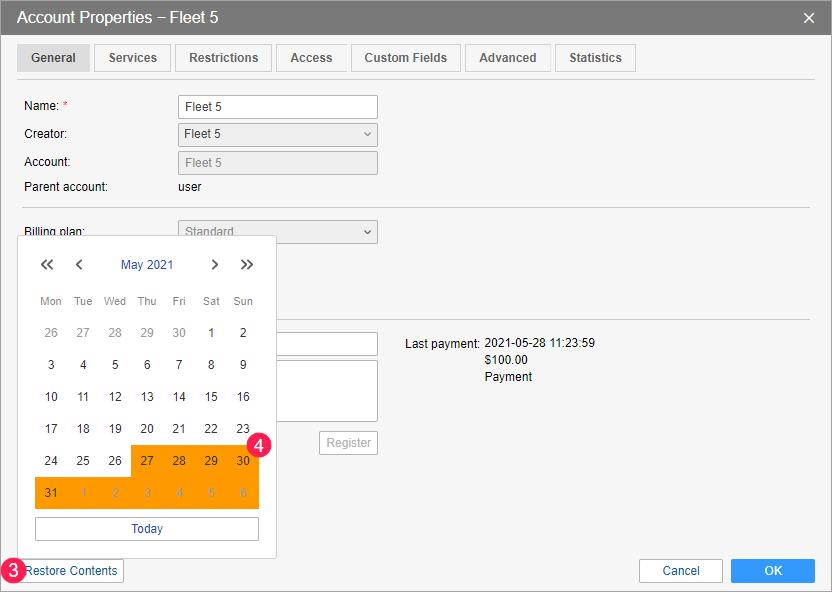

- Open the Accounts section in CMS Manager.
- Click on the name of the required account or resource. To open the list of resources, activate the Resources switch in the Search block and click on the Search button.
- Click on the Restore contents button.
- In the calendar, select the date for which you want to restore the resource contents. The dates with the available saved changes are highlighted in orange.

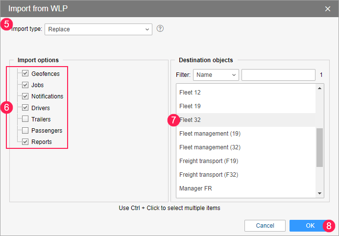

- In the import window that opens next (the mechanism of restoring is similar to import from WLP), select the import type.
- Select the objects you want to restore.
- In the Destination objects section, select the resource to which you want to add the restored objects. The initial resource is selected by default. To select several resources, hold down Ctrl. If necessary, use the filter and dynamic search.
- Click OK.
