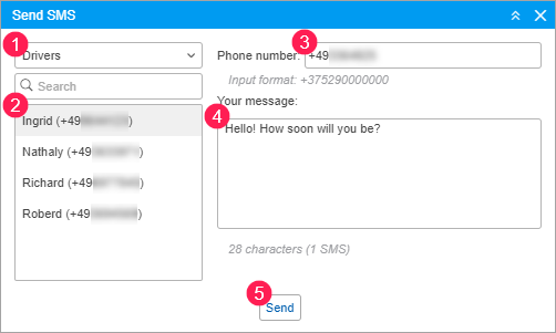

To send a message using the SMS tool, follow these steps:
  1. In the drop-down list, select the recipient type: Drivers or Units.
  2. In the list below, select the recipient. The recipient’s phone number is shown in brackets next to the name. Units with two phone numbers are shown in the list twice. To quickly search for the recipient, use the dynamic filter.
  3. If you want to send the message to a number which is not in the list, specify it in the international format in the Phone number field to the right. By default, it shows the phone number of the recipient selected in step 2.
  4. Enter the text of the message. Below the text, you can see the number of characters and the number of SMS into which the entered text will be divided. If you enter the text in Latin letters rather than Cyrillic, one SMS can contain more characters.
  5. Click Send. After sending the message, the corresponding record is shown in the log.

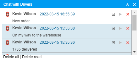

Sending messages by the driver
The driver can also send SMS messages to the operator to the monitoring system using his mobile phone. To do this, the driver’s phone number should be specified in the driver properties in the monitoring system. The operator’s phone number depends on the modem used in the service for sending SMS. The easiest way to find out this number is to send a message to the driver from the monitoring system.
Messages sent by the driver are shown in the log and in the Chat with drivers window in the same way as commands sent from the device. In this window, you can reply to the driver’s messages by clicking on the icon .
The driver’s and operator’s SMS messages are also shown in the SMS messages table of the advanced report on drivers.
