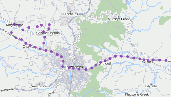

Indicate the thickness of the track in pixels (from 1 to 15). A track can be represented as unconnected points (the points from which the messages were received). If you need this option, select the Points only option.

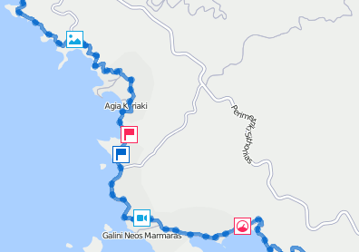

To highlight important events on the track, you can enable the display of markers.
You can use markers only if you have access to reports.
The set of available markers is the same as in reports:
  •  fuel thefts;
  •  speedings;
  •  fuel fillings;
  •  events (violations are identified by the marker );
  •  images from messages;
  •  video from messages;
  •  parking places;
  •  stops;
  •  initial and final positions (final positions are identified by the marker ).
You should enable markers before mapping a track. To do this, click on the icon of the required icon to make it coloured. If you enable at least one marker, additional options become available:
  • numbering;
  • grouping.
Markers on tracks are drawn and used in the same way as in reports.

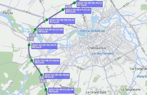

Indicate whether you want annotations to be displayed. Annotations are hints which are attached to each point of the track to show the date and time when the message was received, as well as the speed of the movement of the unit at that time. Annotations are rather informative but they make the visual perception of the track more complicated. That is why sometimes it is reasonable to switch them off. Full information about any point of the track can be obtained from the tooltip that appears when you hover the cursor over a point.
The system of measures in the annotations depends on the settings of the current user, not on the settings of the unit.
