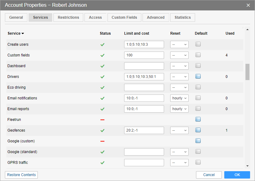

This tab displays all the services available for the account. The list of services depends on the billing plan selected for the account. Here you can enable and disable services for the account as well as set their limit and cost.

Column
Description
Service
The name of the service. See the full list of services and their description here.
Status
The state of the service: enabled () or disabled (). Click on the icon to disable or enable the service, respectively.

Limit and cost
In this column, you can specify the values of the service quantity (limit) and cost. For example, if you specify number 100 for the Units service, this means that no more than 100 units can be created in the account.
To specify the limit, enter the required number in the field. To specify the cost, put a colon after the limit and enter the cost value. For example, if you specify 5:10 for the Units service, this means that the user of the account can create 5 units at a price of 10 c. u. each. If you specify 1:0;5:10;20:5, then no fee is charged for the first unit, the cost of the second to the fifth unit is 10 c. u., and 5 c. u. of the sixth to the twentieth. If the user shouldn't be able to create more than 20 units, add -1 at the end of the line, for example, 5:10;20:5;-1

Reset
Here you can select how often the specified service limit should be reset: every hour, day, week, or month. For example, if you specify 10 SMS messages per day, then the user of this account cannot send more than 10 messages a day.
Default
A gray icon in this column means that the status of this service and restrictions on it are taken from the billing plan assigned to the account. If the status or restrictions are changed, that is, redetermined for the account individually, the icon becomes active (). Click on it to set the default values, that is, the values from the billing plan.
Used
This column shows how many objects (units, drivers, etc.) are already created in the account. For uncountable types of services, such as SDK, eco driving, and so on, nothing is shown in the column.
