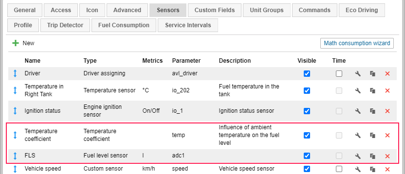

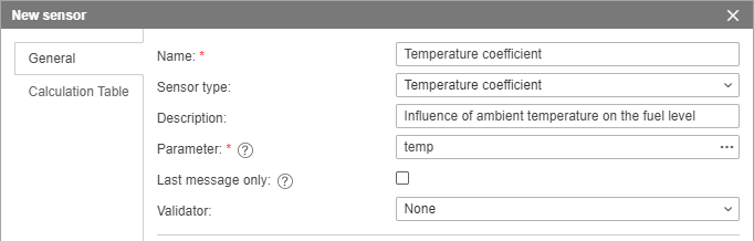

The temperature coefficient sensor, as well as other sensors, is created in the unit properties on the Sensors tab. Press New and fill in the required fields. The type of sensor is Temperature coefficient, name and description are any of your choice. Unit of measurement is not obligatory. Be sure to clearly indicate the parameter that sends the temperature data.

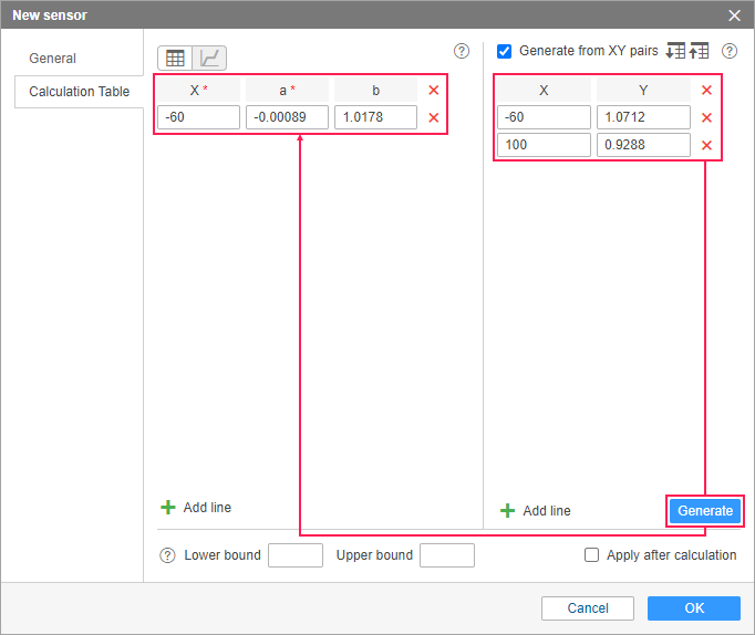

Afterwards, switch to the Calculation table tab and using the Wizard enter the coefficient values — the maximum and minimum temperature coefficient. Beforehand, some preliminary preparations should be done:

Now enter the data found for the minimum and maximum temperature values into the fields of the Calculation table wizard and generate a calculation table.
