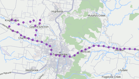

Indicate the thickness of the track in pixels (from 1 to 15). A track can be represented as unconnected points (the points from which the messages were received). If you need this option, select the Points only option.

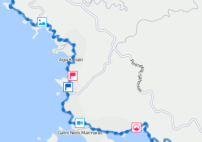

Markers
You can enable markers to highlight the places of significant events on the track.
Markers can be used only if you have access to reports.
The choice of possible markers is the same as in reports:
  •  fuel thefts,
  •  speedings,
  •  fuel fillings,
  •  events (a violation is identified by the marker ),
  •  images from messages,
  •  video from messages,
  •  parking places,
  •  stops,
  •  initial and final positions (a final position is identified by the marker ).
Select the markers before building a track. To activate a marker, just click on its icon to make it colorful. If at least one kind of marker is selected, additional marker options can be applied:
  • numbering,
  • grouping.
Markers in tracks are drawn and used on the same principles as in reports.

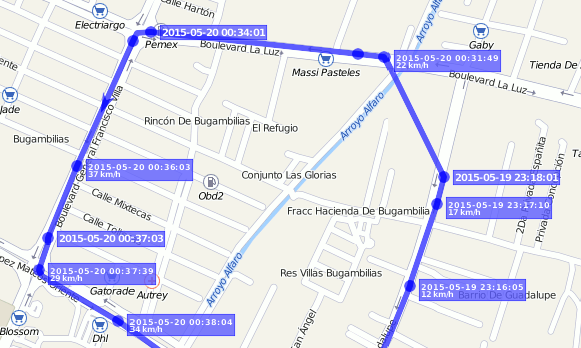

Annotations
Indicate whether you want annotations to be displayed. Annotations are hints which are attached to each point of the track to show the date and time when the message was received, as well as the speed of the movement of the unit at that time. Annotations are rather informative but they make the visual perception of the track more complicated. That is why sometimes it is reasonable to switch them off. Full information about any point of the track can be obtained from the tooltip that appears when you hover the cursor over a point.
The system of measures in the annotations depends on the settings of the current user, not on the settings of the unit.
