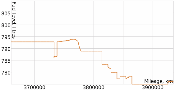

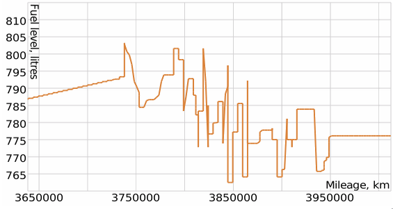

Filtering should be used when it is necessary to remove erroneous values, significantly larger/smaller than the remaining values. During filtering, median smoothing is used.
The value 0 in the Filtration level option is not the zero filtering, but the minimum possible filtering for three messages since this is the minimum amount of data required for median smoothing.
To disable the filtration completely, disable the Filter fuel level sensors values option.
The chart with the disabled filtration:
The chart with the enabled filtration:
