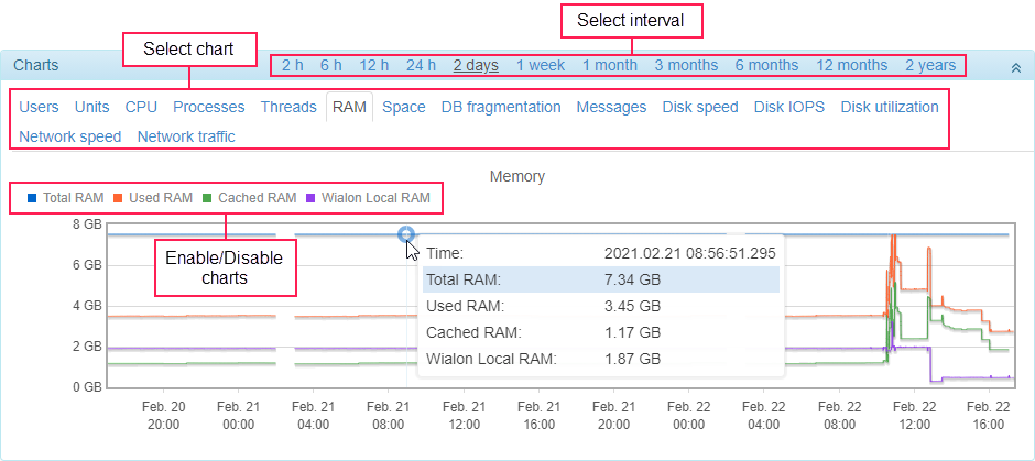

Charts
The Charts block displays visual information on various characteristics. The time interval is selected in the upper right part of the block.
The table below lists all the charts and the curves available for them.

To enable or disable the display of any curve, click on its name above the chart.
The gaps in some sections of the curves indicate that the wlocal service was stopped at the time intervals to which the curves correspond (for the Users/Units charts, it signals that Wialon was stopped).
When you hover the mouse cursor over the point of the chart, tooltips appear.
