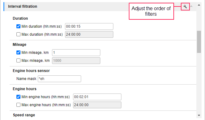

You can use the filters separately and in combination with one another. The filters are applied to the data in the order in which they are located in the Interval filtration section of the table settings. You can change the order of filters by clicking on the icon .
All filters except the mileage filter work only with integer values.

Duration
In the filter, you can specify the minimum and/or maximum duration of the interval.
Engine hours
The minimum and/or maximum duration of engine hours. In addition, the engine hours sensor mask can be specified in the Engine hours sensor filter.
Engine hours sensor
In this filter, you can specify a mask for the name of the engine hours sensor. It affects the calculation of engine hours in the tables which have the corresponding columns, as well as the engine hours filter if it is turned on.

Mileage
In the filter, you can specify the minimum and/or maximum mileage within the interval. It can use both integer and fractional values. Use a period as the separator for fractional values.
