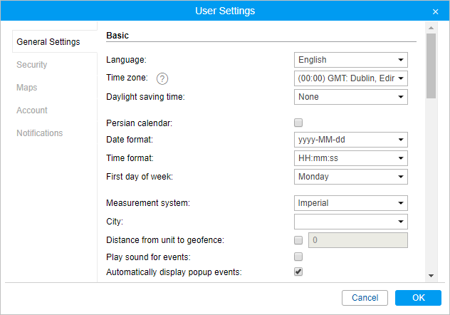

General Settings
The first tab of the User settings dialog contains general settings. Here you can indicate your time zone, change the password to enter the system, and set many other parameters.
Basic
Language
The language menu. Contact your service administrator to expand the list of available languages.
Time zone
The choice of time zone influences the time parameters that are displayed in all dialogs and panels.
Daylight saving time
Specify DST options if you use summer and winter time in your region — choose the most appropriate DST schedule on the dropdown list. None — summer time is not used.
Persian calendar
This option allows you to activate the Iranian calendar also known as the Persian solar calendar. It is used in Iran and Afghanistan. If the option is activated, the Persian calendar replaces the usual (Gregorian) calendar in the places where a user should indicate some time interval (to build a track, to query messages or a report, to set up a job or assign a route, etc.) Note that the Persian calendar can be used to indicate particular dates of an interval only (from-to). When working with quick intervals (today, yesterday, week, month, year), the Gregorian calendar is applied. If the interface is in Arabic, the calendar is in Farsi (the language spoken in Iran) and is shown from right to left. Otherwise, it is in English (in Latin characters and Arabic numbers) and is shown from left to right (see the details). Enabling/disabling the Persian calendar requires reloading the page.
Date and time format
Select the format of the date and time that is convenient for you. Depending on the entered mask, the data elements can be arranged in a different order and have a different appearance. A month, for example, can be displayed with a word or a number, a year with two or four digits, and so on. In addition, the day can also be included. The syntax instructions for each field are given in a tooltip. In the drop-down list, you can select one of the predefined masks. The table below shows some examples of formats.

First day of week
Select either Monday or Sunday as the first day of the week. This affects the appearance of the calendar and the manner of counting weeks in general.
Measurement system
Select one of the available measurement systems. The corresponding units of measurement are used in such tools as Distance, Area, Routing, Nearest Units. The measurement system also influences address processing, as well as the creation of routes. However, the earlier created units and resources (together with geofences, jobs, and notifications) possess the measurement system selected upon their creation. As for reports, their measurement system is set separately (refer to the Advanced settings of a report template).
City
In this field, you can indicate your city. It is used in the Nearest units and Address tools as the default city. Enter the name of the city. When you enter the first letters, the dropdown menu with the names corresponding to the request opens automatically. You can either continue typing in the name or choose it from the drop-down menu (there can be several cities with the same names in different countries).
In addition, this setting determines the position of the map when entering the monitoring system. However, if there are monitored units on the map, the map is scaled so that all of them are in sight.
Distance from unit to geofence
This option activates the calculation of the distance from a unit to a geofence when using the latter as the address. The maximum allowable value is 100 km or miles (depending on the selected system of measures).
Play sound for events
A sound can be played when an online notification is triggered or a driver’s message is received. In Windows OS, QuickTime Alternative can be used as a media player. If you use Opera, you may need additional adjusting, so that the request to play or save the sound does not appear.
Automatically display popup events
If this option is activated, the online notifications and the messages from drivers are automatically shown on the display. If it is deactivated, only a number in the red circle in the bottom panel of the program near the corresponding icon indicates that new events have been received.
