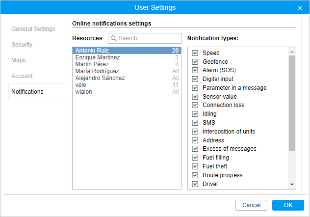

There are two lists on the tab. The resources are selected in the left list and the notification types in the right one.
Next to the name of the resource, the number of notifications selected for it is displayed, and in the tooltip of the digital indicator, their list.

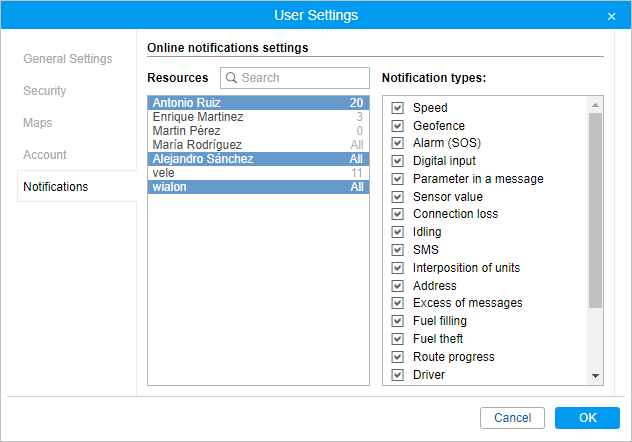

By default, all resources and all notification types for them are selected. To modify the list of notifications that should be received from a resource, select it in the list on the left. To quickly find a resource, use the dynamic filter. In the list of notification types, mark the ones you want to receive.
You can configure the notifications filtration so that it is applied to multiple resources at the same time. To do this, select the resources while holding the Ctrl key and mark the notification types in the list on the right. A black checkbox next to a notification type means that the settings of the selected resources differ (that is, for some resources, this type is marked and for the others, it is not).

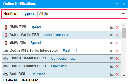

In the online notifications window, there is a filter by notification type which is available to the top-level users and to the users with dealer rights.
