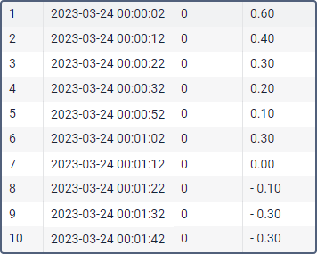

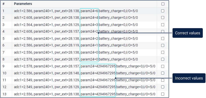

  1. Open the Messages tab.
  2. Request data messages. Raw data should be selected in the Parameters field.
  3. In the resulting table, find the required parameter and compare its values.
Let’s analyse the param24 temperature parameter in the image below. You can see that when the temperature drops and the threshold of 0 degrees is crossed, incorrect values are displayed.

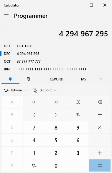

  1. Open the calculator and enter any of the invalid values in decimal mode (DEC).
  2. Switch to hexadecimal mode (HEX) and count the number of characters in the resulting value. If the number of characters is not 2, 4, or 8, then round it up (for example, 5 should be rounded up to 8). In the image below, the value consists of 8 characters.

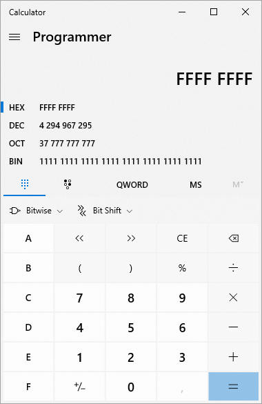

  3. In HEX mode, enter the letter F as many times as there are characters (after rounding up).
  4. Switch to DEC mode. The resulting number is the maximum value. Write it down.

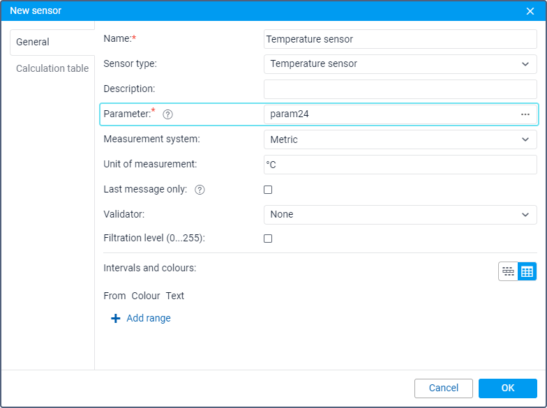

Creating a sensor with the required parameter
In order for the incorrect values to be converted to the real negative ones, you should create a sensor and configure the calculation table for it.
As a sensor parameter, specify the one the values of which you want to convert.

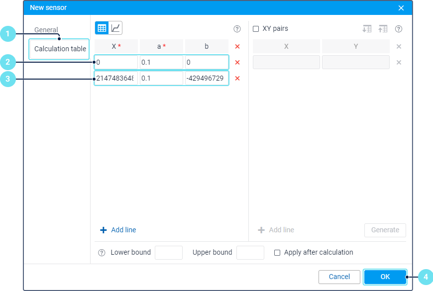

To configure the calculation table, follow these steps:
  1. Open the Calculation table tab in the sensor properties.
  2. Fill in the first row of the table as follows:
    ColumnValue
    X0
    a
    The coefficient specified for the parameter in the hardware specification. In our case, the coefficient 0.1 is used for the parameter param24, that is, if the value 6 is sent in the parameter, the actual temperature is 0.6 degrees.
    If no coefficient is used, enter 1.
    b0
  3. Fill in the second row of the table as follows:
    ColumnValue
    X
    To calculate X, divide the maximum value by 2 and, if the result is an integer, add 1 to it. If it is not an integer, round it up to an integer.
    In the example with param24, 4294967295 : 2 = 2147483647.5
    Therefore, X =2147483648.
    aCoefficient (see step 2).
    b
    Correction. To calculate b, add 1 to the maximum value and multiply the result by the coefficient. Enter the resulting value with a minus sign.
    In the example with param24, (4294967295+1)x0.1 = 429496729.6
    Therefore, b = -429496729.6.
  4. Click OK.

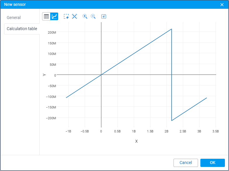

  1. View the chart on the Calculation table tab of the sensor properties.
