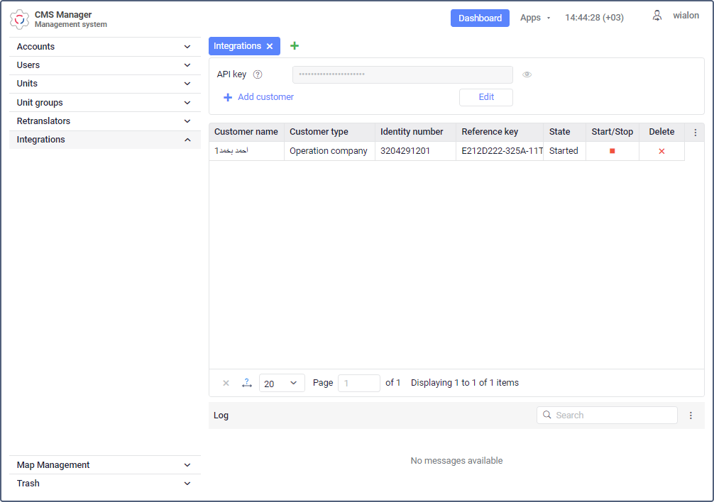

Specifying the API key
On the Integrations tab, specify the API key obtained after registering on the Wasl platform. To enter the key, click Edit, type it in the field, and click Save.
The specified key is used for all the customers you register.
Now you can proceed to register customers, drivers, and vehicles.
