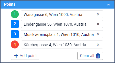

Route Points
In this section, you can add the route points and work with them. To plan a route, you should specify the addresses of two obligatory points: the departure point and the destination point. You can also add any number of waypoints to the route.
The following markers are used to indicate the added points in the list and on the map:
  •  : departure point;
  •  : waypoint;
  •  : destination point.
Each marker has a sequence number of the point. The numbers change automatically depending on how many points are added and in what order they are arranged.

MethodDescription
Entering coordinates
To add a point, follow the steps below.
  1. Click on an empty point row. If you want to add a new row, click Add point.
  2. Specify the coordinates separating them by a comma. The following formats are allowed:
    • degrees with a decimal and a sign can be used to indicate west longitude or south latitude  (for example, 45.49150, -73.61638 or 45.49150°, -73.61638°);
    • degrees with a decimal and the letters indicating the latitude and longitude (for example, N45.49150, W73.61638 or N45.49150°, W73.61638°).
  3. Select these coordinates in the drop-down list.

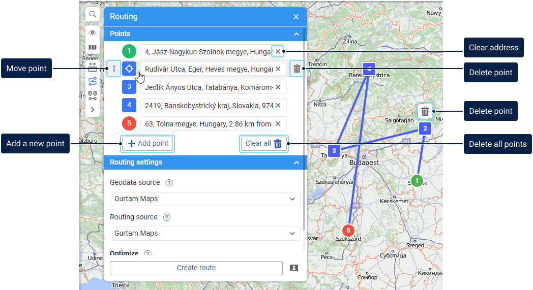

Working with points
You can work with the route points in the list and on the map. All actions are synchronized automatically, that is, any change in the list is also applied to the map and vice versa.
The following icons are available when working with points:
IconAction
Change the order of points. To do this, point to the row of the required point, click on the iconand move it to the required place holding down the left mouse button.
Centre the map on the route point. The icon is displayed when pointing to the point marker in the list.
Clear the point address.
Delete the point. The icon is displayed when pointing to the point row and after clicking on the point marker on the map.
When deleting the destination point, the last waypoint automatically becomes the destination point. When you delete the departure point, the first waypoint automatically becomes the departure point.
To delete all the added points at the same time, click the Clear all.
To change the order of points using the map, click on the marker of the added point and move it to the required location holding down the left mouse button.
When you zoom out on the map, the point markers that are close to one another are merged according to their order, for example: .
