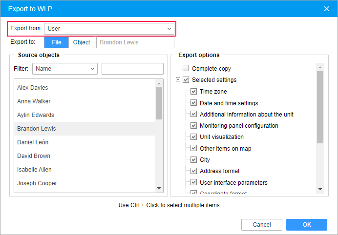

To export user settings, select the Export to WLP item in the user menu and select User in the Export from drop-down list. See a detailed guide here.

Exportable settings
Below are the settings you can export.
SettingDescription
Time zoneThe selection of the time zone and the daylight saving time.
Date and time settingsThe date and time format, first day of the week, and the Persian calendar.
Additional information about the unitThe settings from the Show additional information about the unit section. These settings influence the contents of the unit tooltip and extended unit information on the Monitoring tab.
"Monitoring" tab configurationThe columns selected on the Monitoring tab, secondary information settings and other monitoring options.
Unit visualizationThe settings from the Unit visualization section.
Other items on mapThe settings from the Other items on map section.
CityThe City field on the General settings tab. This parameter is used in the Address and Nearest units tools.
Address formatThe settings for displaying the address format from the Map tab.
User interface parametersThe state of the log (shown/hidden), shortcuts (on/off), settings for online notifications and messages.
Coordinate formatDegrees or degrees and minutes.
Map sourceThe map source selected by the user.
Geodata sourceThe geodata source selected by the user.
Routing sourceThe routing source selected by the user.
General propertiesThe state of the options from the General tab of the user properties and the host mask.
Custom fieldsThe custom and administrative fields from the user properties.
Presets of access rightsThe templates of access rights created by this user.
Custom message parametersThe Send custom message command settings.

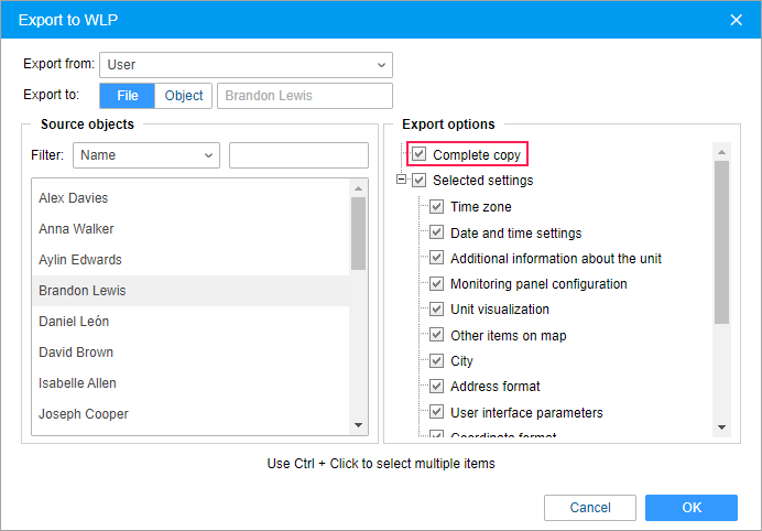

User complete copy
When exporting settings, you can also make a complete copy of the user. You cannot exclude any specific settings from the export. In addition to the settings listed above, the complete copy includes some hidden settings (for example, operational settings for applications).
The imported settings are applied after the user refreshes the page or logs in to the system.
