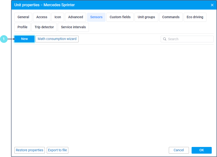

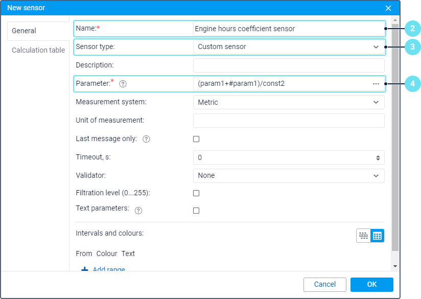

To create a sensor of the coefficient of engine hours, follow these steps:
Click New.
Enter the sensor name.
Select the Custom sensor type.
As the sensor parameter, specify the expression (param1+#param1)/const2, where param1 stands for the parameter which sends the value of engine revolutions. The parameter of the coefficient sensor is the arithmetic average of engine revolutions within the interval between two successive messages.

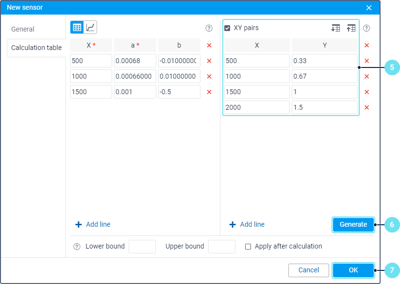

In the calculation table, enable the XY pairs option and configure them as follows:
X Y Explanation 500
0.33
One minute of operation at 500 rpm corresponds to 20 seconds of engine operation, which means that the coefficient is 0.33.
1000
0.67
One minute of operation at 1000 rpm corresponds to 40 seconds of engine operation, which means that the coefficient is 0.67.
1500
One minute of operation at 1500 rpm corresponds to 60 seconds of engine operation, which means that the coefficient is 1.
2000
1.5
One minute of operation at 2000 rpm corresponds to 90 seconds of engine operation, which means that the coefficient is 1.5.
Click Generate.
Click OK.
