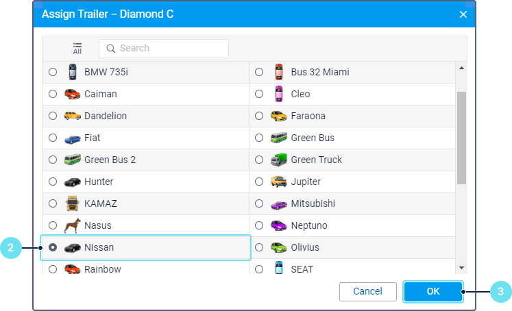

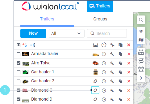

  1. Click on the icon   opposite the required trailer in the list of trailers or their groups. If you don’t have the Create, edit, and delete trailers access right to the resource, the icon is inactive ().
  2. In the open window, select the unit to which you want to assign the trailer. Here you can see the units from the work list on the Monitoring tab. If no units are displayed, click on the icon   to the left of the search. If still no units are displayed, it means you don’t have the View object and its basic properties access right to them.
  3. Click OK.

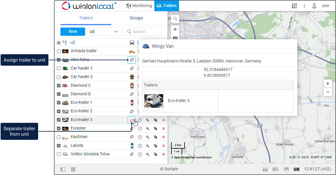

After that, the icon of the selected unit is shown in the trailer row.
To separate the trailer from the unit, point to the unit icon in the trailer row and click on the icon  .

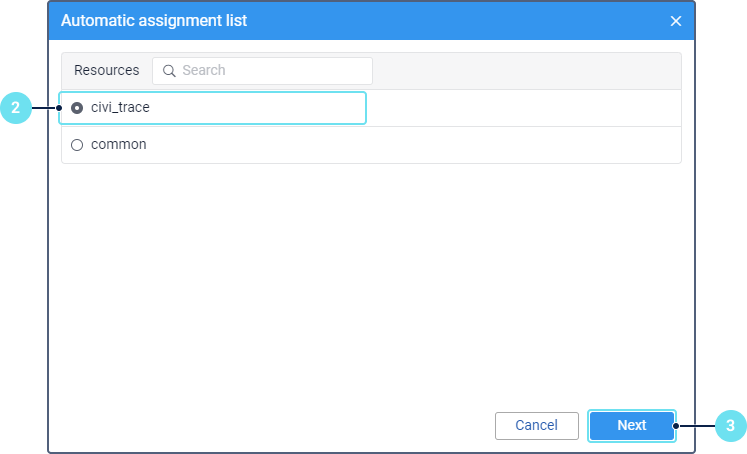

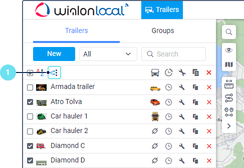

  1. On the Trailers tab, click on the icon  .
  2. In the list of resources, select the resource for the trailers of which you want to configure automatic assignment. To find out which trailers belong to a certain resource, apply filtering by resource to the trailer list (displayed to the right of the New button).
  3. Click Next.

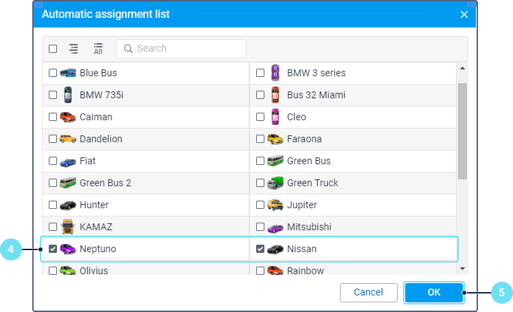

  4. Select the units or unit groups to which the trailers of the selected resource should be assigned automatically. To switch between the lists of units and their groups, use the icon /. For more information about the unit selection, see Creating jobs.
  5. Click ОК.

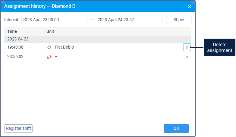

The Assignment history feature allows you to view the history of assignments, add records of assignments manually (register work shifts) and delete them if necessary. To perform these actions, click on the icon to the right of the trailer name.
To view the assignment history, specify the required interval and click Show. In the list of assignments, you can see the name of the unit, the date and time of the trailer assignment and separation from it.
You can delete an incorrect assignment or separation by clicking on the icon  at the end of the row. If an assignment is deleted from the history, it is not shown in reports either.
You can’t delete the last registered assignment or separation.

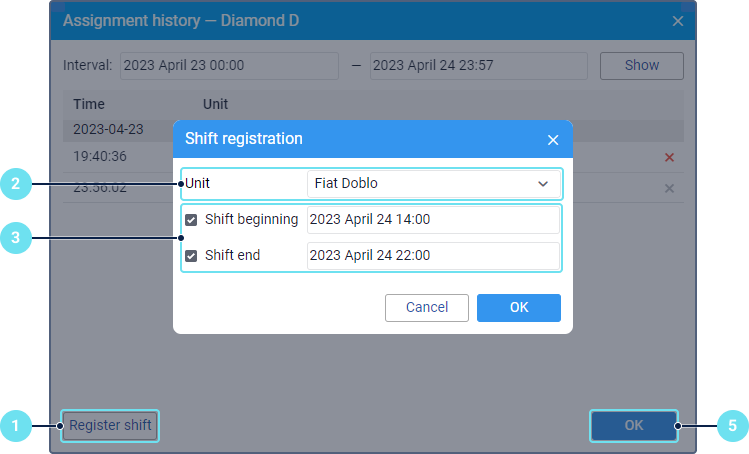

To create a record of the trailer assignment in the past, follow the steps below.
  1. Click Register shift.
  2. Select a unit in the drop-down list.
  3. Specify the time of the shift beginning and/or end. To enable the Shift end field, put a check mark near it.
  1. Click OK.
