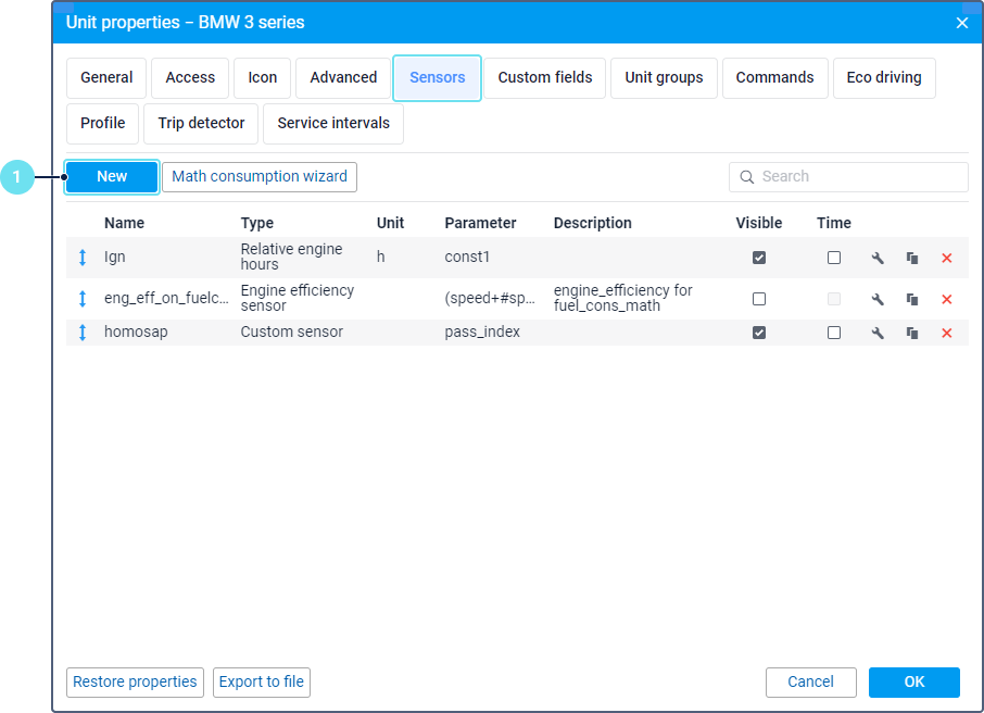

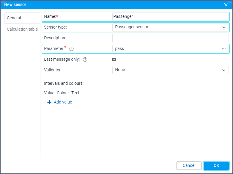

  1. For all the units, to which you want the passengers to be assigned automatically, create a sensor of the Passenger sensor type. The sensor parameter depends on the device you use and its settings.

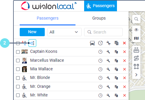

  2. On the Passengers tab, click on the icon .

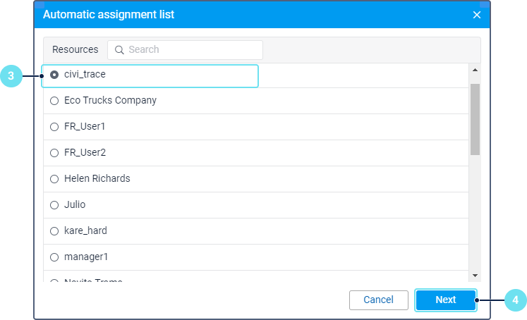

  3. Select the resource for the passengers of which you want to configure automatic assignment. To find out which passengers belong to a certain resource, apply filtering by resource to the list of passengers (displayed to the right of the New button).
  4. Click Next.

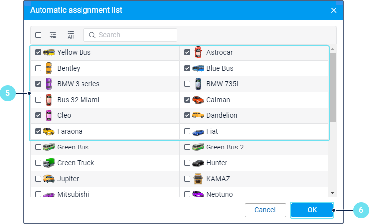

  5. Select the units or unit groups to which the passengers of the selected resource should be assigned automatically. To switch between the lists of units and their groups, use the icon /. For more information about the unit selection, see Creating jobs.
  6. Click OK.

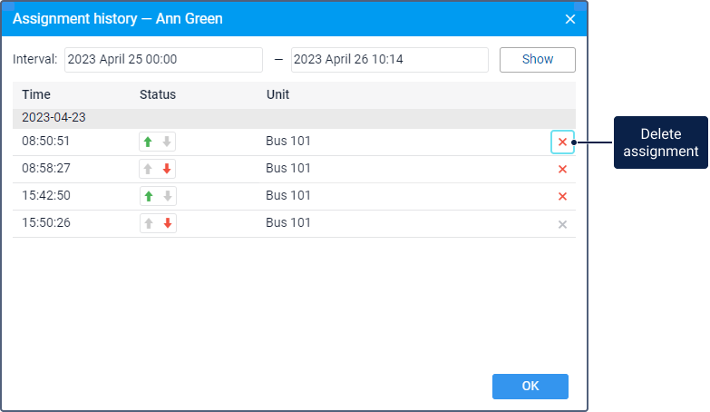

The Assignment history feature allows you to view the history of assignments and delete them if necessary. To perform these actions, click on the icon to the right of the passenger’s name.
To view the assignment history, specify the required interval and click Show. In the list of assignments, you can see the date and time of the passenger’s assignment or separation, the passenger’s status and the name of the unit.
The following icons are used for displaying the passenger’s status:
IconDescription
The passenger's assignment to the unit, that is, getting on the vehicle. To the right of this icon, you can see the icon  which allows you to change the passenger's status to Separated.
The passenger's separation from the unit, that is, getting off the vehicle. To the left of this icon, you can see the icon  which allows you to change the passenger's status to Assigned.
The automatic separation of the passenger from the unit, that is, getting off the vehicle when the period specified in the Automatic separation field of the passenger properties is over. You can't change this status.
You can delete an incorrect assignment or separation by clicking on the icon  at the end of the row. If an assignment is deleted from the history, it is not shown in reports either.
