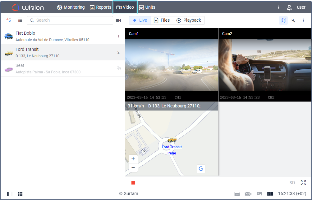

The monitoring system supports the H.265 codec. Ensure that both your browser and your system are compatible with this codec.
On this tab, you can receive live streams from the unit cameras, watch saved video files, request videos for the past period, and work with them.
To work with video, select the required tab.
Tab
Function
Live stream
Watching live streams from the unit cameras and monitoring the unit movement on the map.
