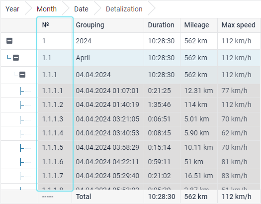

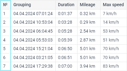

Row numbering
Numbering is an additional (always the first) column and can be added to the table of any type.
If grouping is used in the table, numbering becomes multilevel. The main level is the numbering of the main lines with the help of integers. The nested level is the numbering of hidden lines according to the number of the main line — point — number of the nested line scheme.

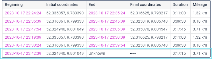

Incomplete interval
The Incomplete interval option does not apply to all intervals of the table, but only the last (trips, sensor operation, etc.), since its ending does not always coincide with the end of the reporting period. To display this interval, the following options are provided.
OptionResult
Show and cut off
The interval is displayed in the report. The End column shows the time of the last message in the reporting period.
Do not show in report
The incomplete interval is not displayed in the report.
Show and mark as incomplete
The interval is displayed in the report and has the Unknown label in the End column.

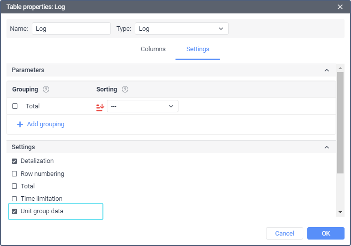

Unit group data
In the settings of the tables Log and Custom fields for a unit group, the Unit group data option is available.

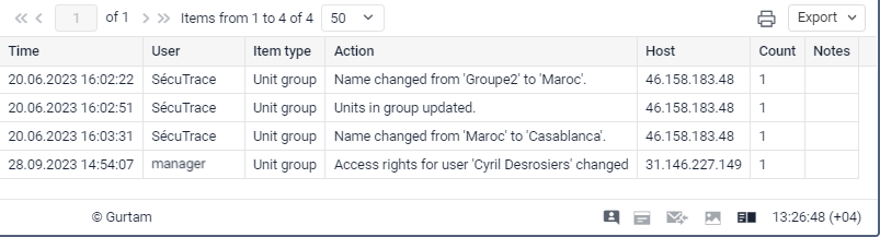

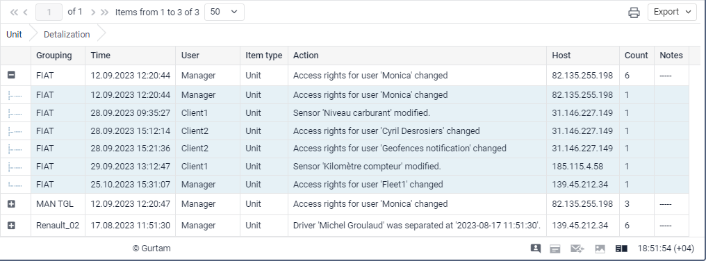

If it is disabled, the report shows the data for individual units that are part of the group or groups. To execute such a report, you should activate the Detalization option.
If the Unit group data option is enabled, the report shows the data concerning the unit group as a system object. The data is shown only for one unit group, even if several groups are selected in the Object parameter (only the first one in the list is taken into account).
