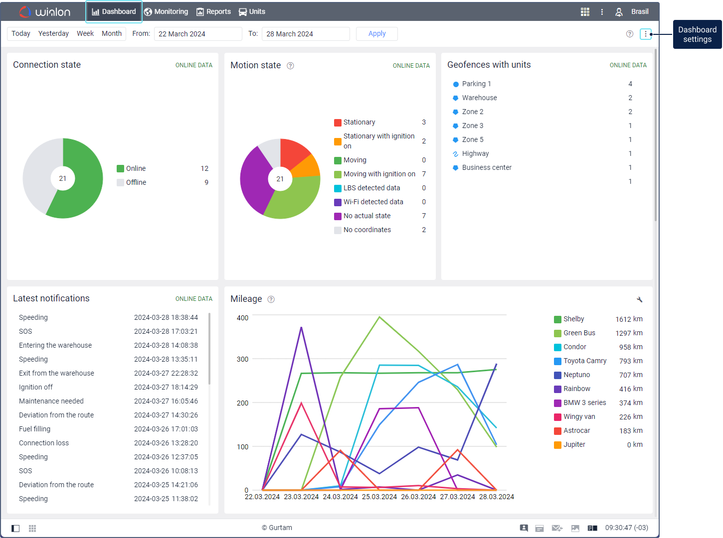

The Dashboard tab contains summary information about the units from the work list. Here you can quickly assess the status of devices installed on the units, see unit connection and motion state, view the latest online notifications as well as the geofences where the units are located, and so on. The information is updated as new messages are received from the units.
To open the Dashboard tab, click on the same name item in the top panel. The tab is displayed if the Dashboard item is selected in the main menu settings.
The Dasboard tab offers 19 information blocks. In the Dashboard settings (), you can select the blocks which should be displayed. You can change their order by clicking on the heading of the block and dragging it to the required place.

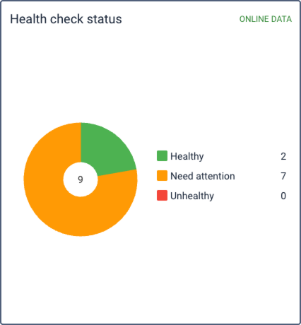

“Health check status” block
This block summarizes the overall health of your devices, depending on whether they meet the criteria configured on the Health check tab of the unit properties.
They unit devices can fall into one of the following categories:
Category Description
Healthy The device doesn’t meet any of the configured criteria.
Need attention The device meets one or more criteria for which a tracking period is selected.
Unhealthy The device meets all the configured criteria.

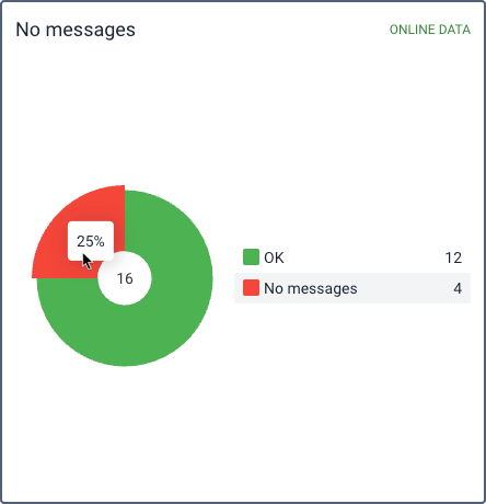

Messages Provides information about the units that have stopped sending messages.

All health check blocks contain a pie chart.
In the individual criterion blocks, devices are divided into categories indicated with green and red colors. Green indicates devices without incidents based on the health check criteria, while red indicates devices experiencing incidents in real time. The Health check status block also includes a third category, represented in orange, for devices that require attention.
When you hover over a sector of the chart, the percentage of the total number of devices that belong to the category is shown. To the right of the chart is a legend indicating which category each color represents and the corresponding number of devices.
To see which devices belong to a category, click on it in the legend. In the list of devices with incidents, hovering over a row shows which criteria the device currently meets.
To open the unit minimap, click on the icon in the row of the required unit.

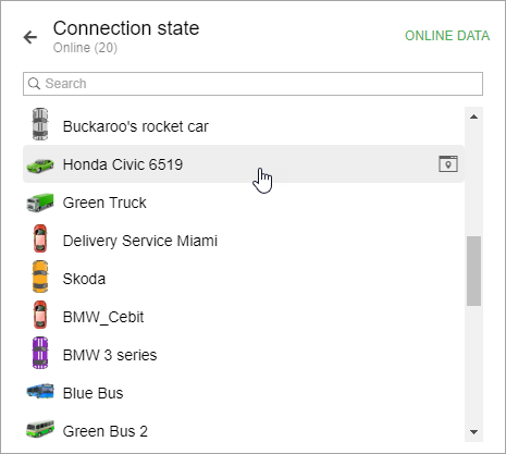

Connection state
This block contains a pie chart with information about the connection state of the units: online or offline. To the right of the chart is its legend, which shows what category is represented by each color and how many units belong to it. When you point to a sector of the chart, a percentage of units belonging to this category is displayed.
To see the list of units belonging to the category, click on it in the legend.
To quickly find units by name, use the dynamic search above the list. Click on the line with the unit to open its minimap.

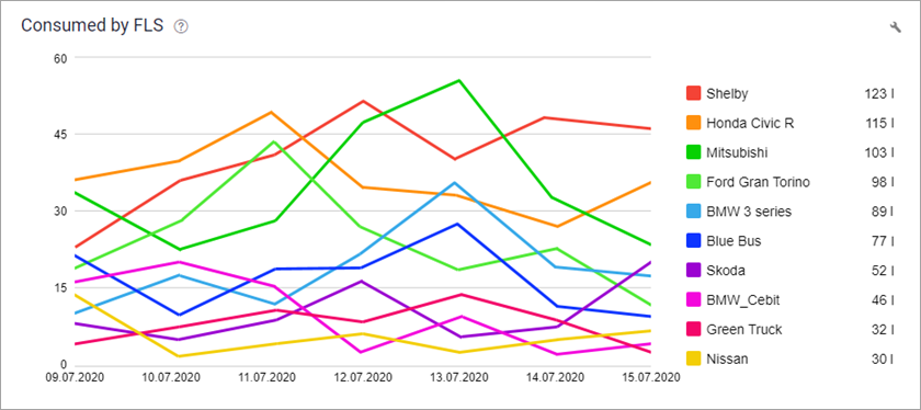

Consumed by FLS
Prerequisites
The Calculate data by the sensor option must be enabled in the settings of the fuel level sensor.
The line chart of this block displays how much fuel was consumed by units and detected by the fuel level sensor (FLS) for the specified interval (seven days by default). If the interval exceeds 14 days, the data in the chart is grouped. If it includes only one day, dots are displayed instead of lines.
The chart legend shows the volume of fuel consumed by the unit and the color that corresponds to it. If the unit has more than one FLS, the sum of their values is indicated. If you point to the unit in the legend, its line in the chart remains colored while the others become grey. To see how much fuel was consumed by the units on a certain day, point to the part of the chart corresponding to this day.
By default, the chart shows data on the first 10 units from the work list. To change them, click on the icon and select the required ones (no more than 10). To quickly find units, use the dynamic search. Then click on the icon to go to the chart. When you sign in the next time, the same units remain selected.

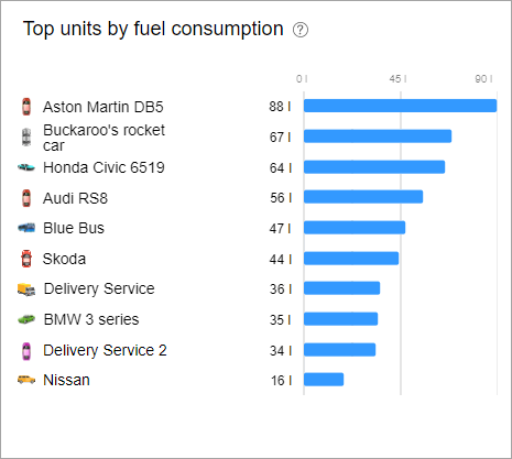

Top units by fuel consumption
The block displays units with the maximum fuel consumption detected by FLS for the specified interval (seven days by default). The volume of fuel consumed by the unit is shown opposite its name and is additionally displayed in the horizontal chart on the right.
