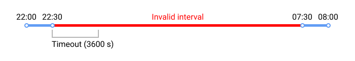

The Timeout option is used to search for invalid intervals during the sensor operation. It is applied to historical data (reports) and data processed in real time. If an interval between two messages with sensor readings is longer than the value indicated for the Timeout option, the interval is considered invalid. In this case, the message before the invalid interval becomes the end of one interval and the message after the invalid interval becomes the beginning of the next one. The timeout is specified in seconds.
Example. Suppose that data messages from a custom digital sensor were received at 22:00,  22:30, 07:30 and 08:00. If the Timeout option is disabled, the report shows one continuous interval from 22:00 to 08:00. If you specify a timeout of 1 hour (3600 s), several intervals are formed. Since the difference between the first and second messages is less than an hour, they form the first interval (from 22:00 to 22:30). The difference between the second and third messages is more than an hour, therefore this interval (from 22:30 to 07:30) is considered invalid and is not taken into account. The difference between the third and fourth messages is less than an hour, therefore they form the second interval (from 07:30 to 08:00).
