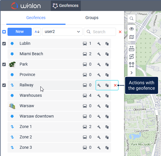

List of geofences
By default, geofences are listed in alphabetical order. To switch between the forward and reverse alphabetical order, use the button /. To quickly find the required geofence, use the dynamic filter or the filter by property (polygons, lines, circles) or by resource.
The list of geofences contains icons that show information about geofences and allow you to perform actions with them.
IconDescription
The types of geofences: polygon, line, circle. These icons are shown next to the names of the geofences for which no image is selected.
The number of units within the geofence. The list of these units is available in the geofence tooltip. If the Presence in geofences option is not enabled in the user settings, question marks are displayed in this column.
Open the geofence properties. If you have the Create, edit, and delete geofences access right, you can change the geofence size, type, location on the map, and other properties, except for the resource.
If there are more than 5000 points in a geofence, you can’t edit it.
Copy the geofence, that is, create a new geofence using the selected one as a template.
Delete the geofence. To see the icon, hover over the geofence row. The icon is active if you have the Create, edit, and delete geofences access right. To delete several geofences at once, select them and click on the iconabove their list.

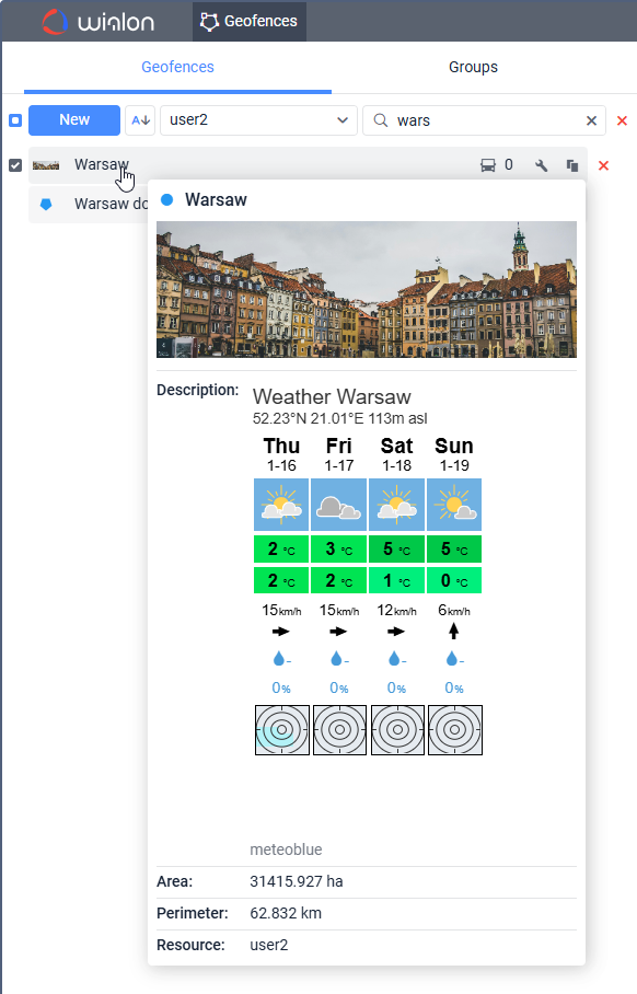

Geofence tooltip
To see the geofence tooltip, point to the name of the geofence in the list or to its icon on the map. You can also point to the geofence itself on the map holding down the Ctrl key.
The tooltip contains the following information:
  • geofence type (indicated with an icon);
  • geofence name;
  • enlarged image;
  • description (if specified);
  • area (for polygons and circles);
  • perimeter (for polygons and circles);
  • length (for lines);
  • width (for lines);
  • name of the resource to which the geofence belongs (if several resources are available);
  • list of units within the geofence.
If the description contains links to data from other sources, this data is also shown in the tooltip. Below is an example of a code which can be used to display the weather forecast.
Copied!
<iframe src="https://www.meteoblue.com/en/weather/widget/daily/madrid_espa%c3%b1a_3117735?geoloc=fixed&days=5&tempunit=CELSIUS&windunit=KILOMETER_PER_HOUR&coloured=coloured&pictoicon=1&maxtemperature=1&mintemperature=1&layout=light"  frameborder="0" scrolling="NO" allowtransparency="true" sandbox="allow-same-origin allow-scripts allow-popups"></iframe><div><!-- DO NOT REMOVE THIS LINK --><a href="https://www.meteoblue.com/es/tiempo/pronostico/semana/madrid_espa%c3%b1a_3117735?utm_source=weather_widget&utm_medium=linkus&utm_content=daily&utm_campaign=Weather%2BWidget" target="_blank">meteoblue</a></div>
