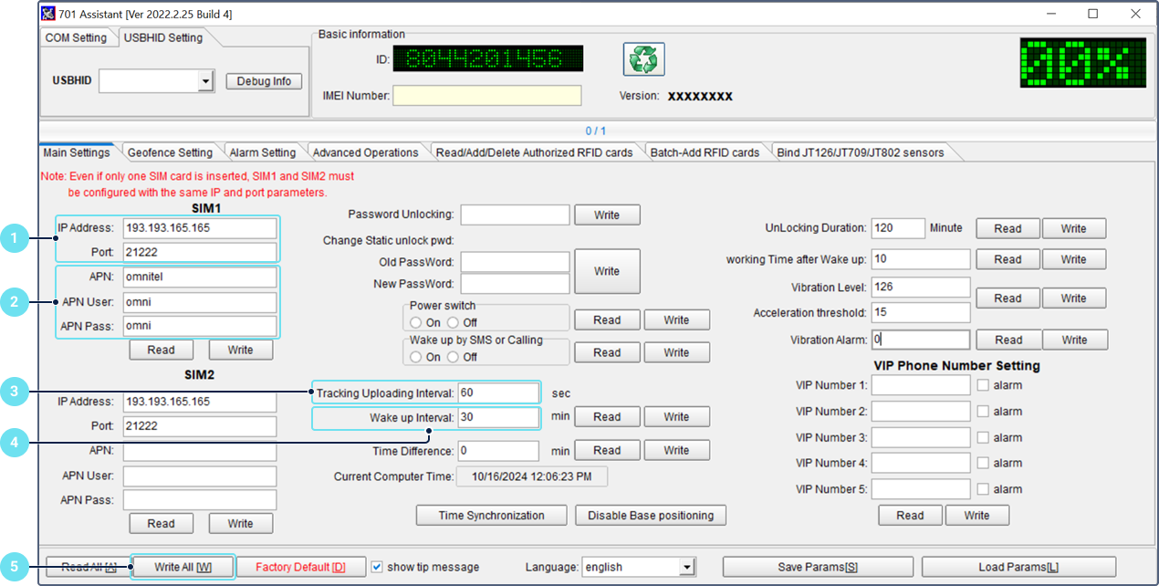

  1. On the Main settings tab, fill in the IP address and Port fields for SIM1 and SIM2. You can find the IP address and port in the unit properties.
    If the device ID starts with a 7, the device type is Jointech JT701 and the port is 21222.
    If the device ID starts with an 8, the device type is Jointech JT701D and the port is 22068.
  2. Specify APN settings in the APN, APN user and APN pass fields.
  3. In the Tracking uploading interval field, specify how often the device should send messages while not in sleep mode.
  4. In the Wake up interval field, specify how often the device should send messages while in sleep mode.
  5. Click Write all to apply the new settings.

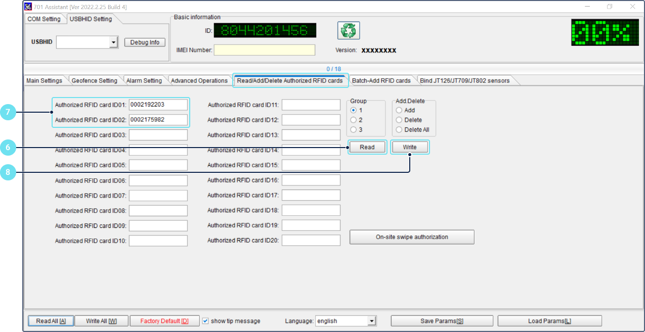

  6. On the Read/Add/Delete authorized RFID cards tab, click Read.
  7. Specify authorized RFID card IDs.
  8. Click Write to apply the new settings.

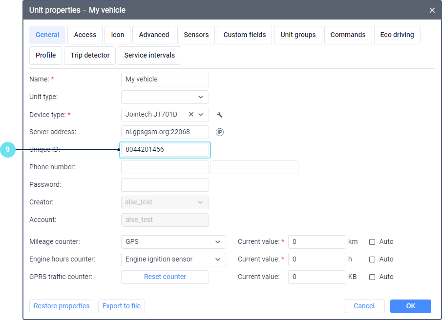

  9. Use the 10-digit ID from the Basic information section as the unique ID in Wialon. It is also specified on the device case.

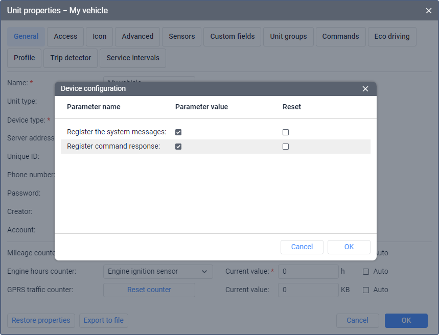

Additional device settings are available in the unit properties upon clicking on the icon  next to the Device type field.
The available settings are as follows:
SettingDescription
Register the system messages
Enable this option if you want to receive all the messages sent by the device. If this option is disabled, only the following packet types are registered: P45, P22, @JT, U02, WLNET, P35.
Register command response
If this option is enabled, the response to a command is registered in the cmd_response parameter. You can see it in the table of messages.

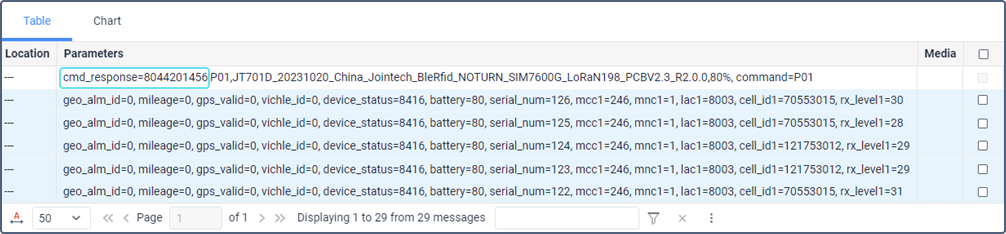

Query firmware version (query_fw_ver)
Request the current version of the device, including the device model, firmware version, hardware version, remaining battery, and other parameters.
Response example:
cmd_response=8044201456,P01,JT701D_20231020_China_Jointech_BleRfid_NOTURN_SIM7600G_LoRaN198_PCBV2.3_R2.0.0,80%

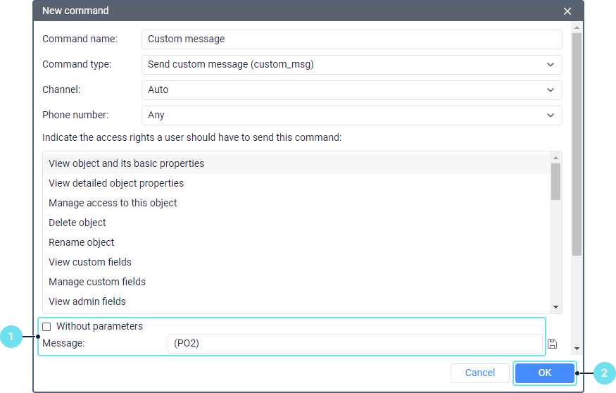

Send custom message (custom_msg)
Send a custom command, for example, (P02). To configure a command of this type, disable the Without parameters option, enter the message text, and click OK.
