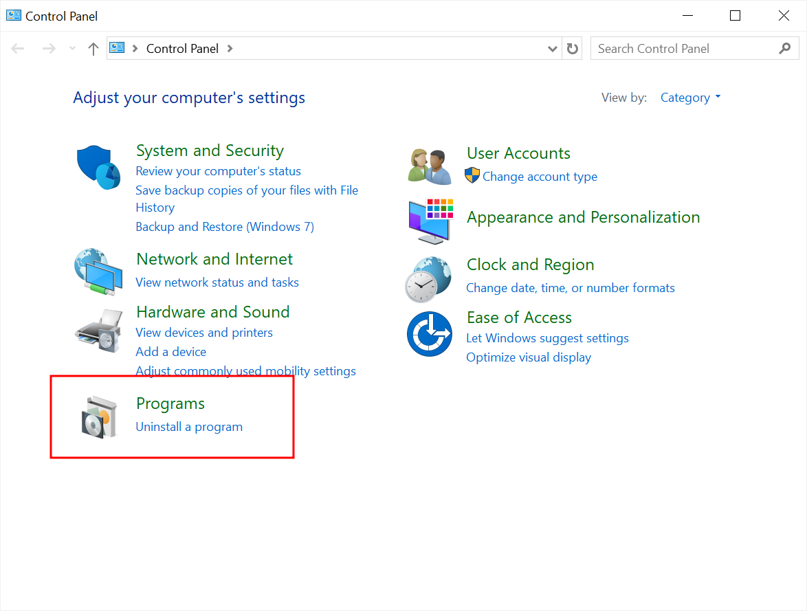

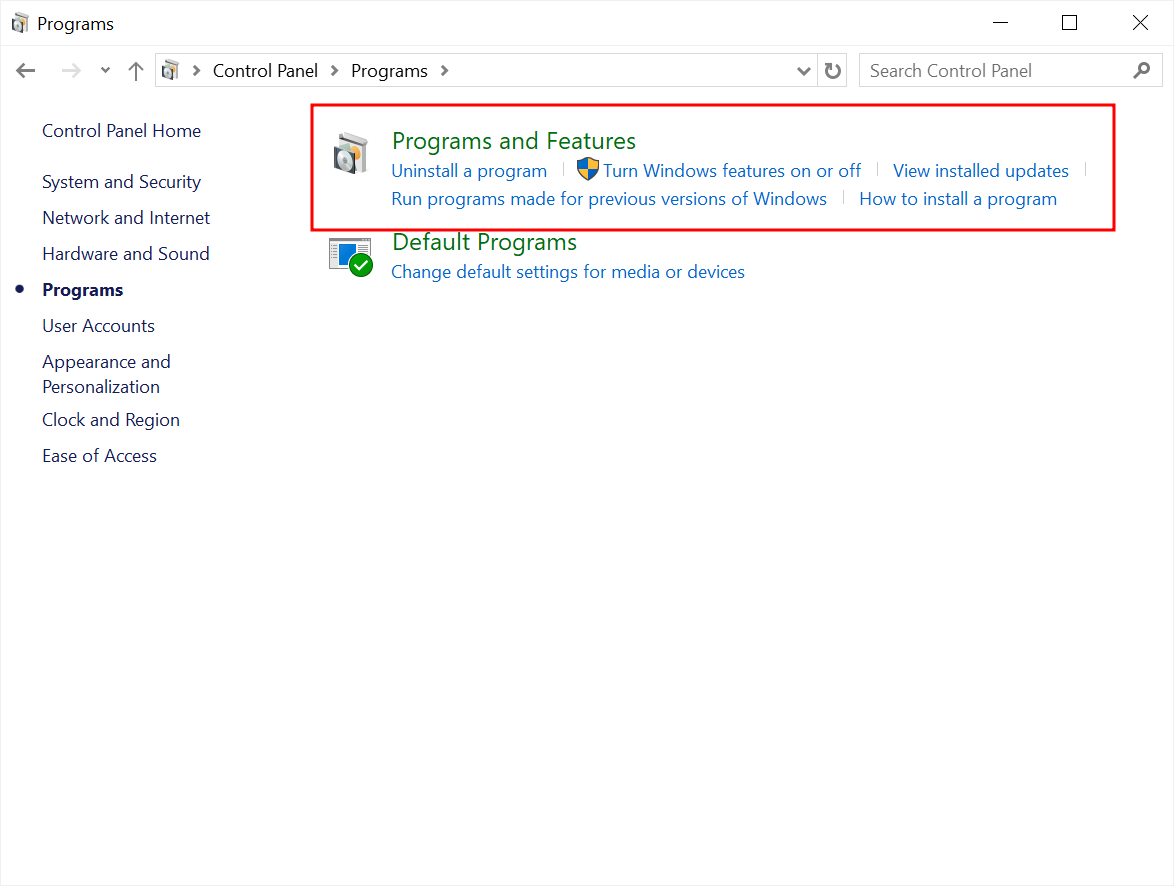

  1. Press Win on the keyboard and type ‘Control Panel’. Then click it in the search results.
  2. Select Programs.

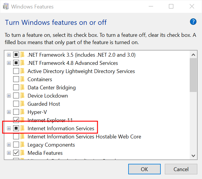

  3. At Programs and Features, click Turn Windows features on or off.
  4. In the new window, click the checkbox next to Internet Information Services and press OK.

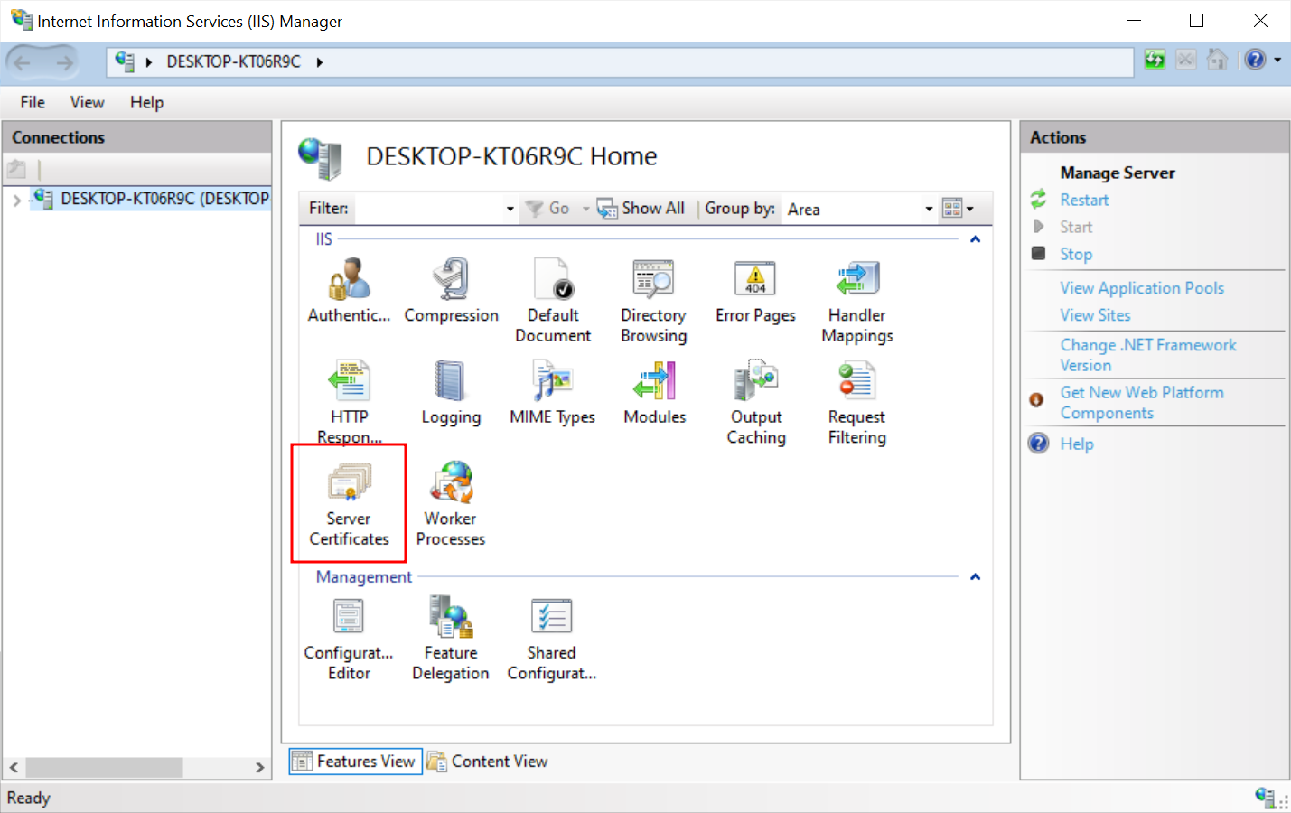

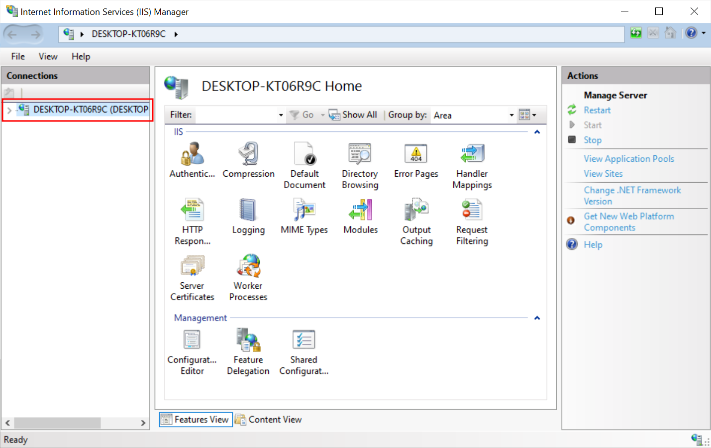

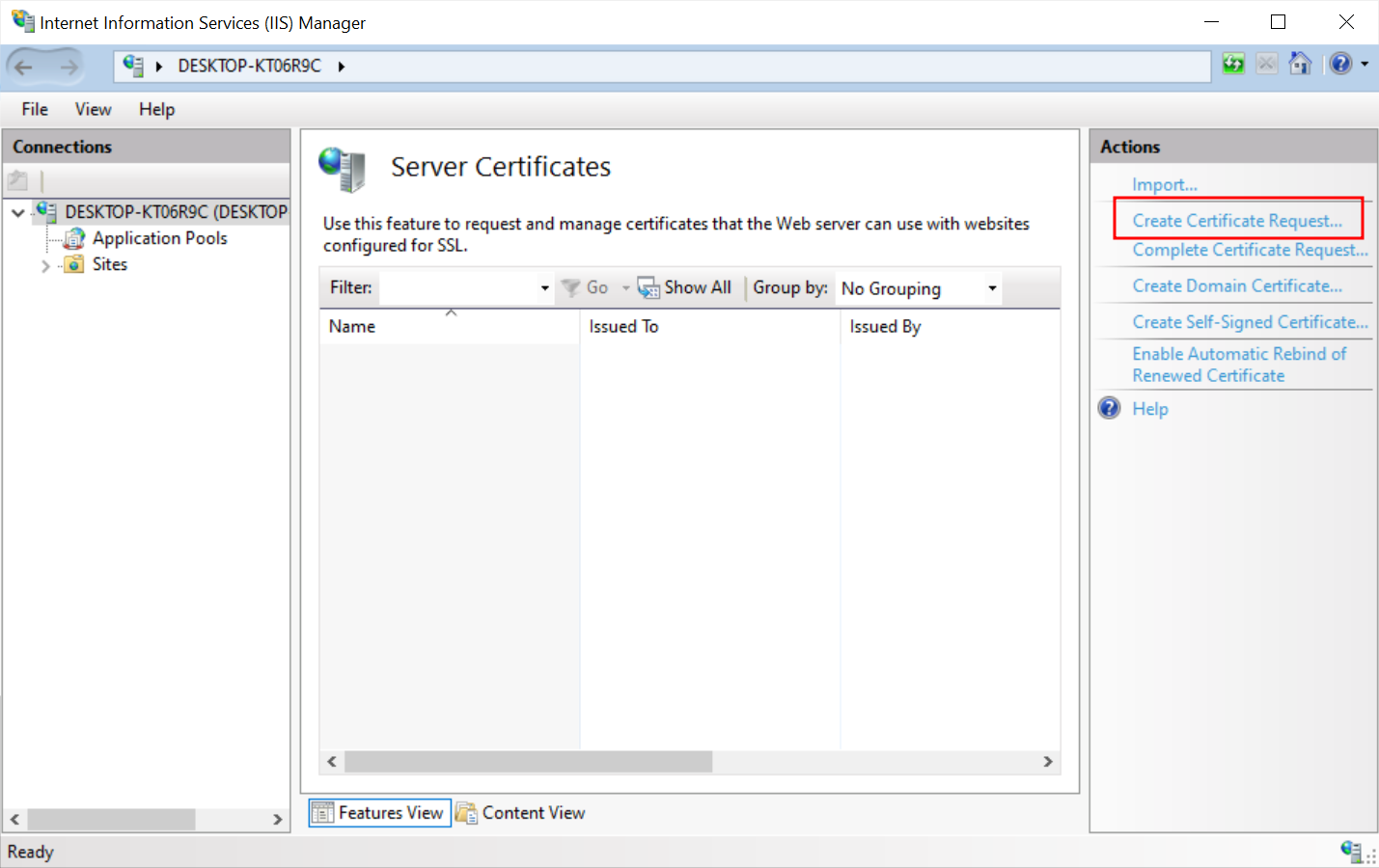

  6. Press Win on the keyboard and type ‘Internet Information Services (IIS) Manager’ in the search bar. Then click it from the search results to launch.
  7. In the new window, in the left column Connections, select the server.
  8. Double-click the Server Certificates icon in the center panel of the window.

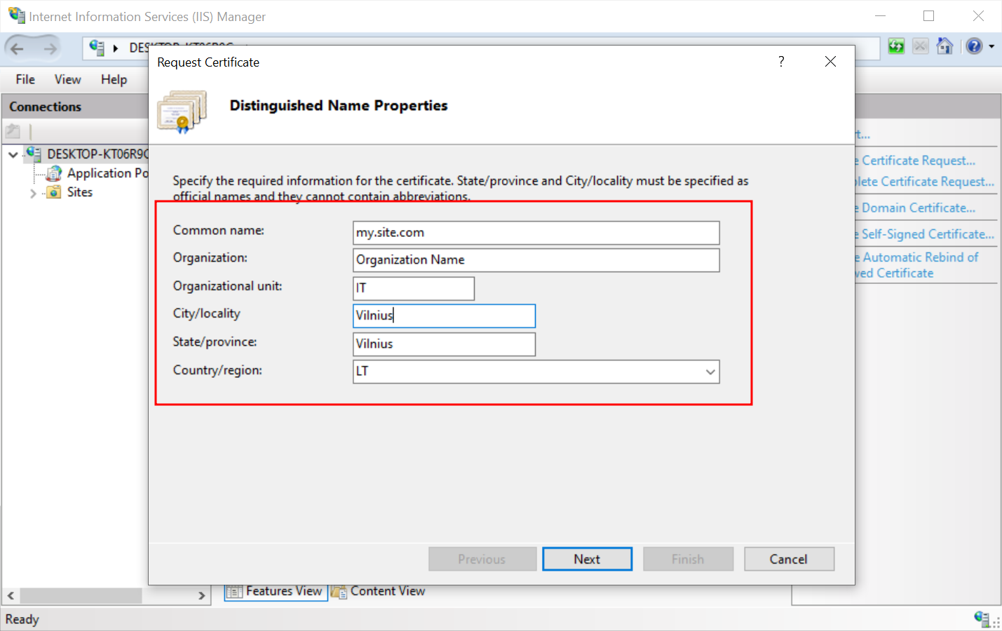

  9. Click the Create Certificate Request link in the Actions column on the right side of the window.
  10. Enter the required information and press Next:
    • Common Name field — the Fully Qualified Domain Name of the website the certificate will protect. It should be set the same way the client will address it. In most cases, this will be the entire domain name. You can also set a wildcard, like *.mydomain.com.
    • Organization — the name of your company or organization.
    • Organizational Unit — your unit or department name.
    • City / Locality — city or town where your company is located.
    • State / Province — your state or Province name, or use the Locality name if you have none.
    • Country/ Region Name (optional) — select from the drop-down list.

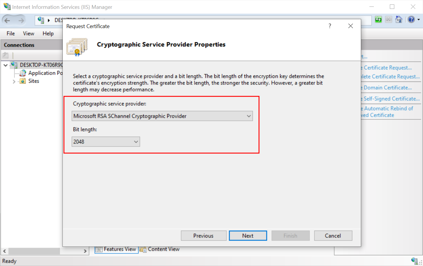

  11. Set Cryptographic Service Provider Properties. In the drop-down menu, select Microsoft RSA SChannel Cryptographic Provider as the cryptographic service provider, 2048 as the Bit length and press Next.

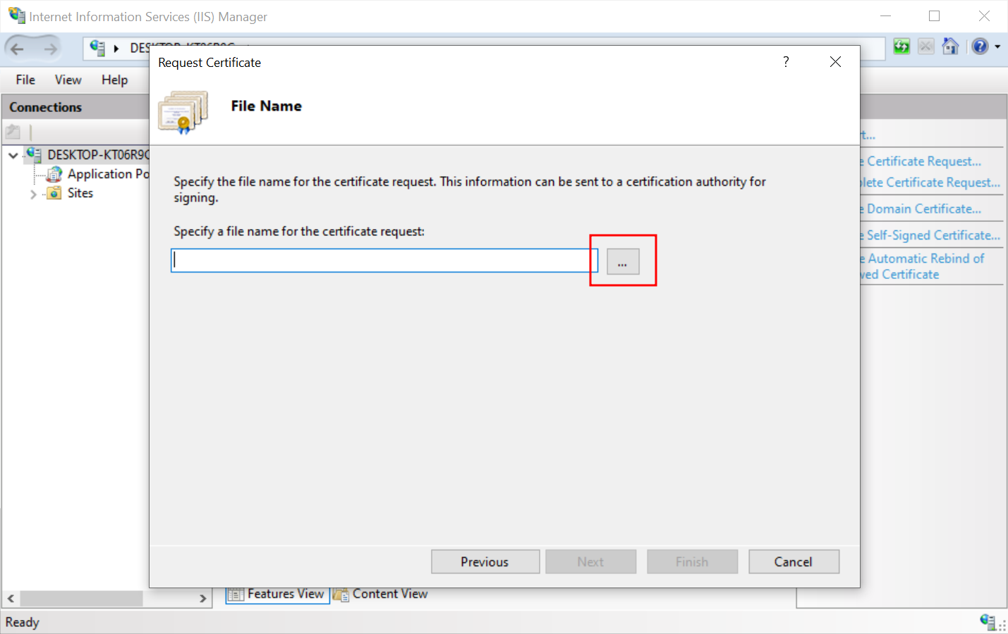

  12. Click the button with three dots to select where the CSR request should be placed and add its name. Press Finish.

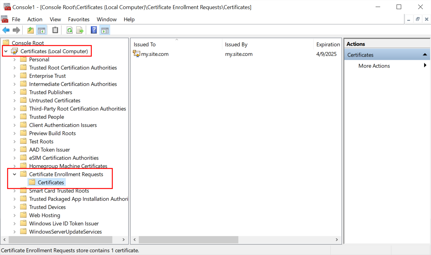

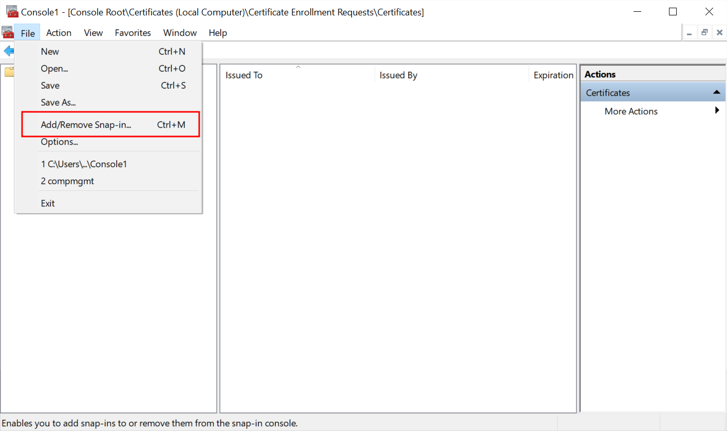

  14. Press Win on the keyboard and type ‘Microsoft Management Console’ or ‘mmc’ in the search bar. Then click it from the search results to launch.

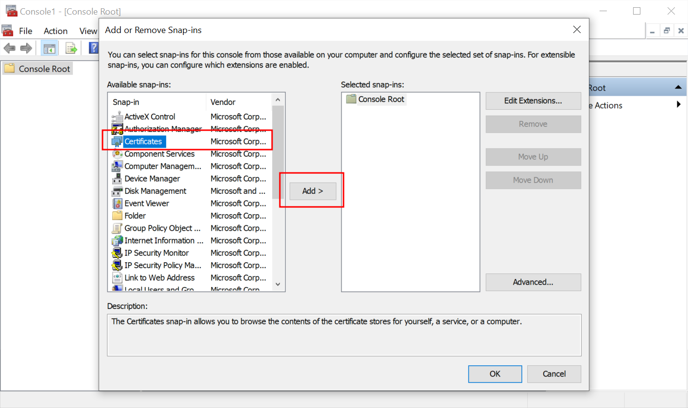

  15. In the new window, press File > Add/Remove Snap-in…
  16. In the new window, in the left column, select Certificates and press Add > button.

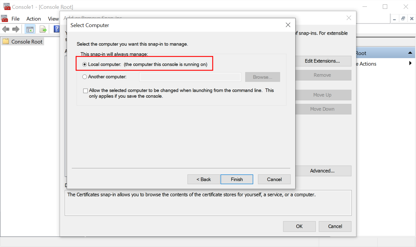

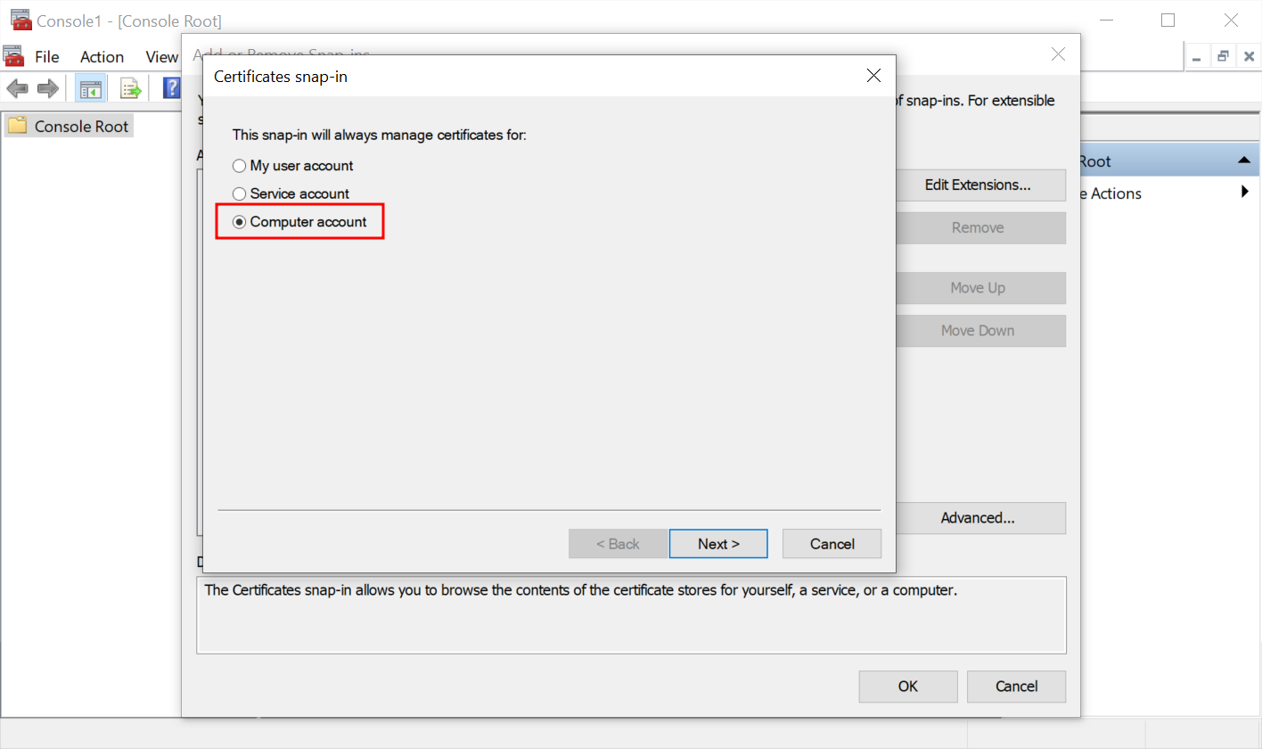

  17. This snap-in will always manage certificates for Computer account and press Next.
  18. This snap-in will always manage Local computer (the computer this console is running on) and press Finish.
  19. Press OK to save the changes.

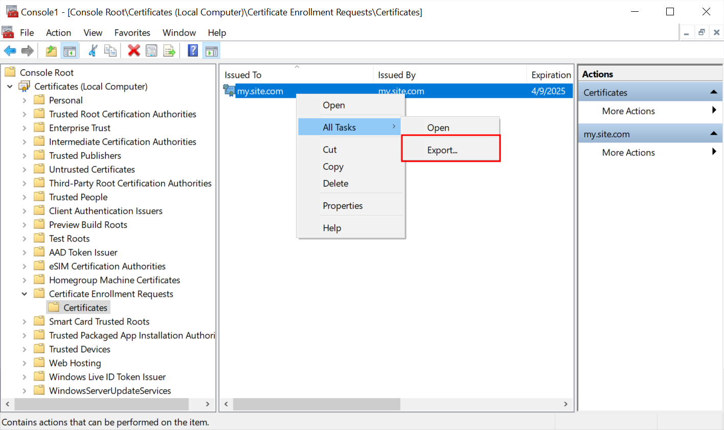

  20. In the left column, select Certificate Enrollment Requests and click Certificates below it.

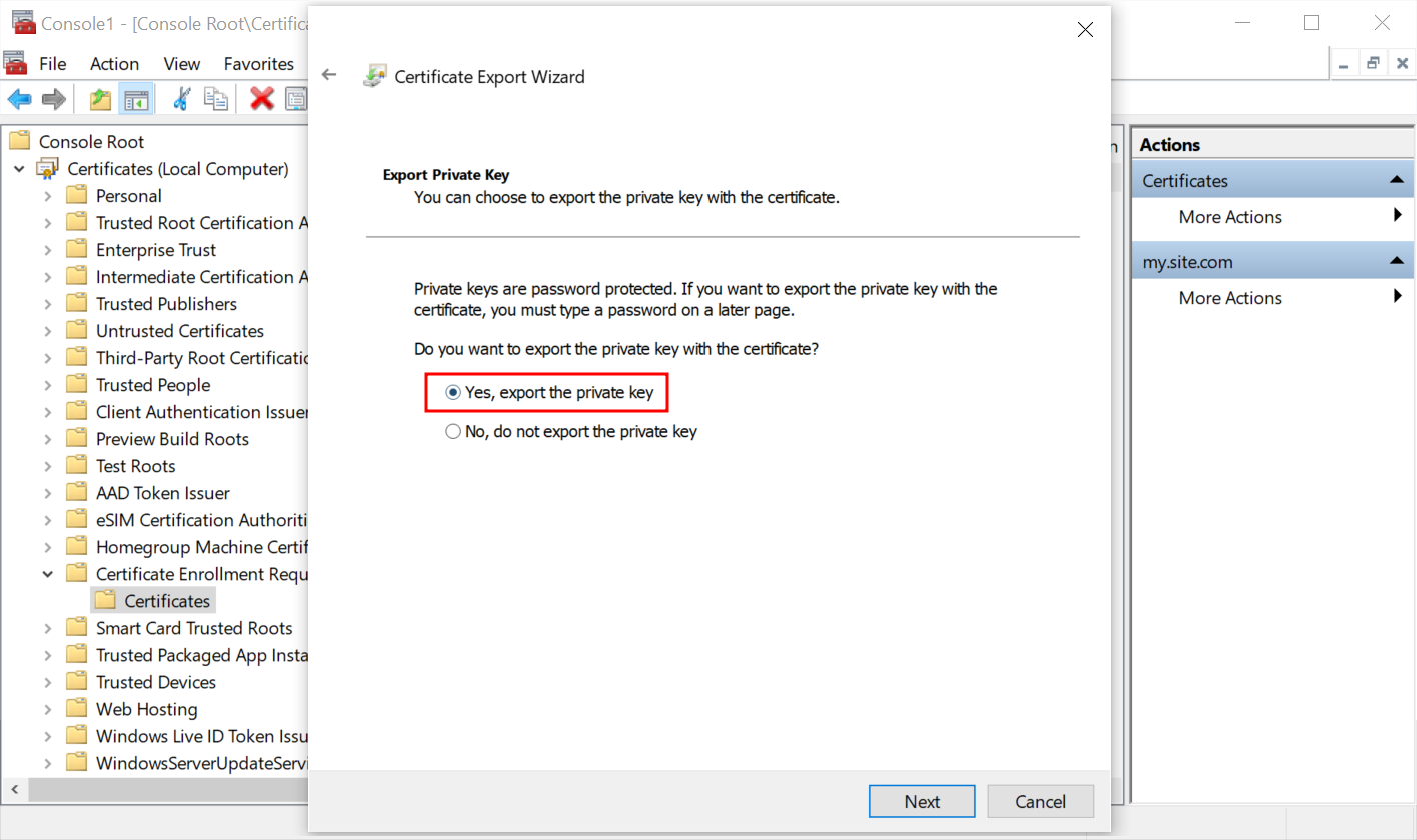

  21. In the center panel of the window, find the required certificate request and right-click it. Select All Tasks > Export…

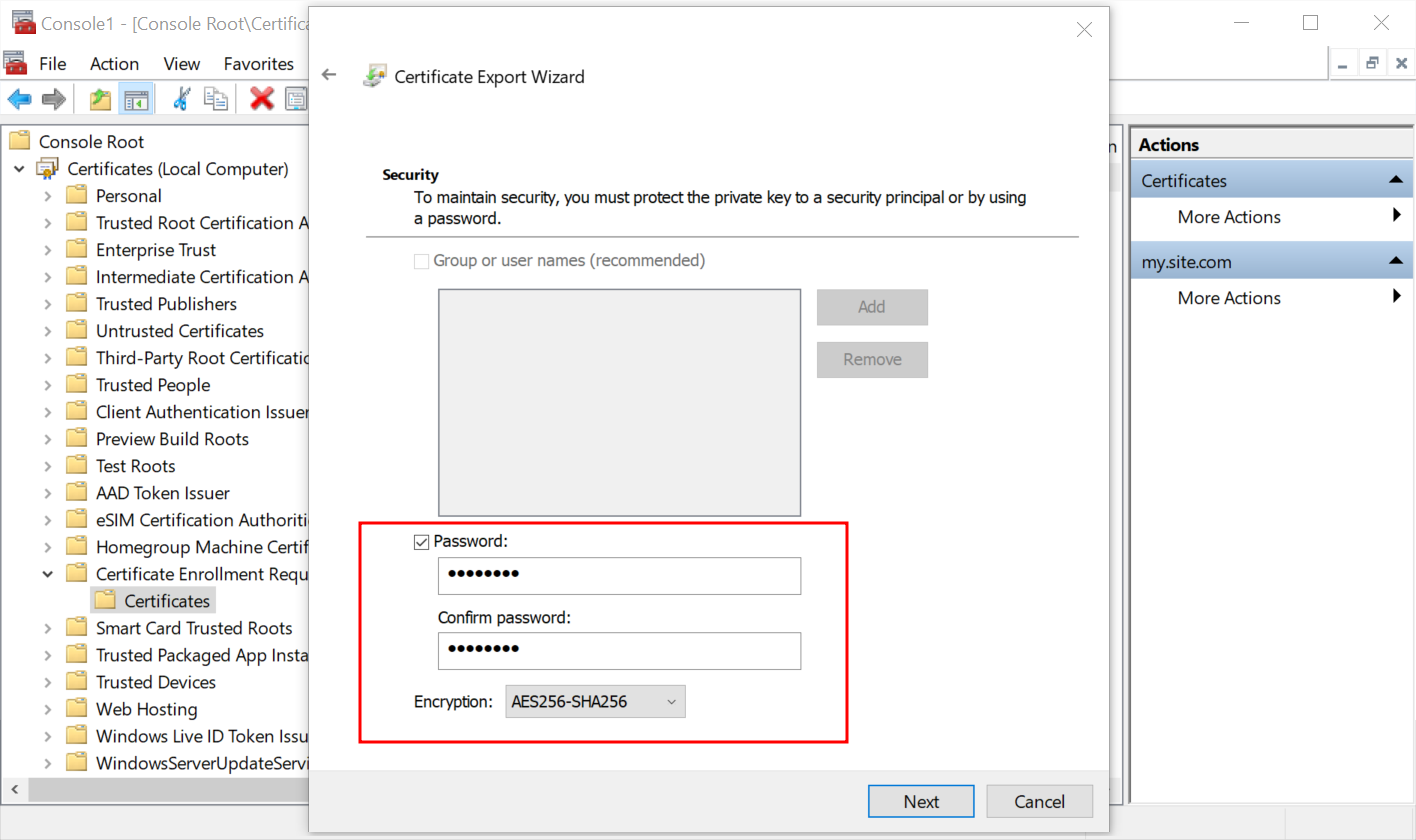

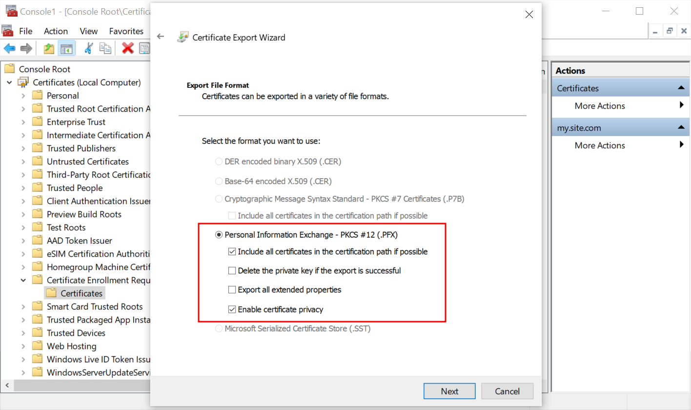

  22. Select the answer Yes, export the private key.
  23. Select the format Personal Information Exchange - PKCS #12 (.PFX).

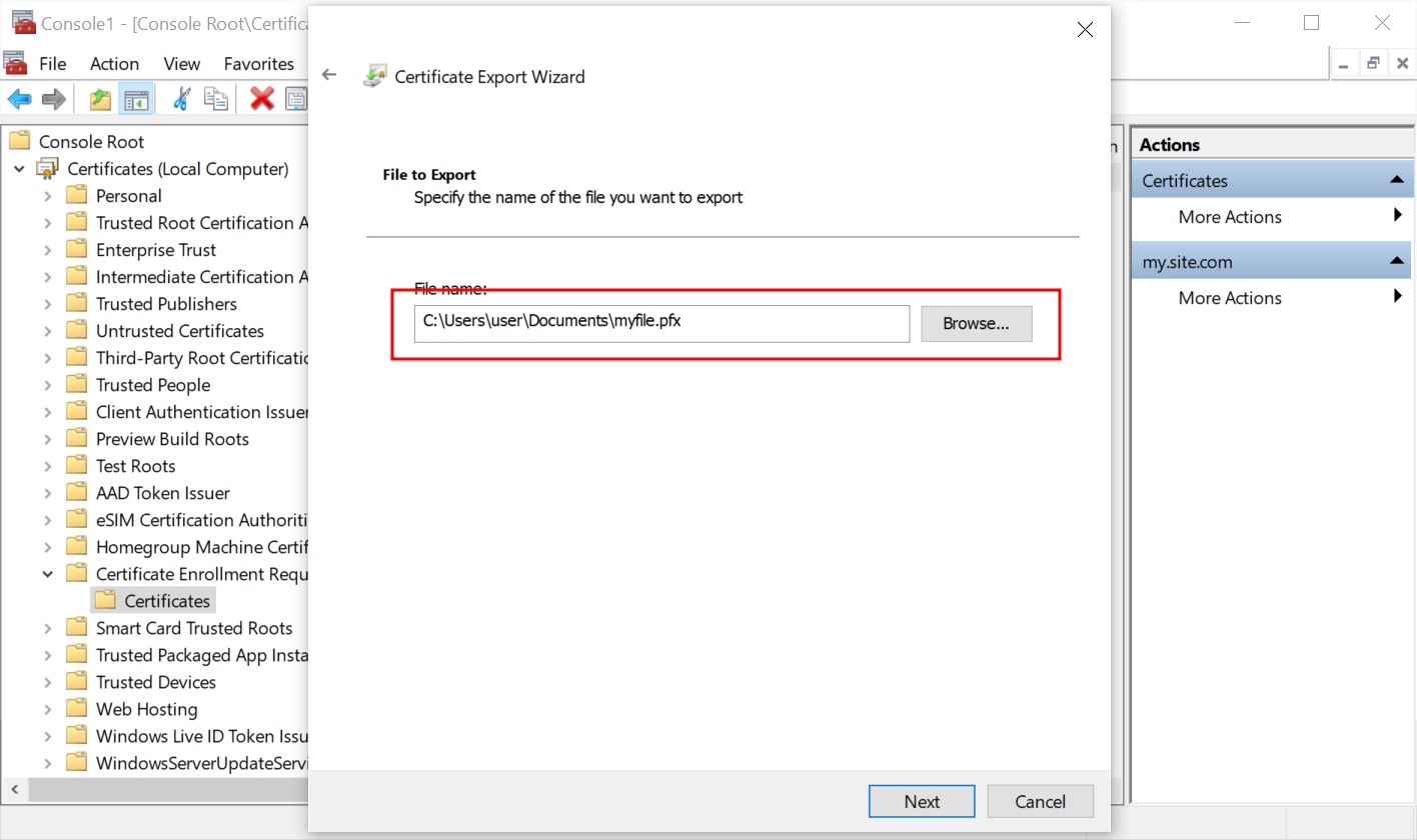

  24. On the next step, mark the Password option. Enter the desired password in the Password and Confirm password fields and press Next.

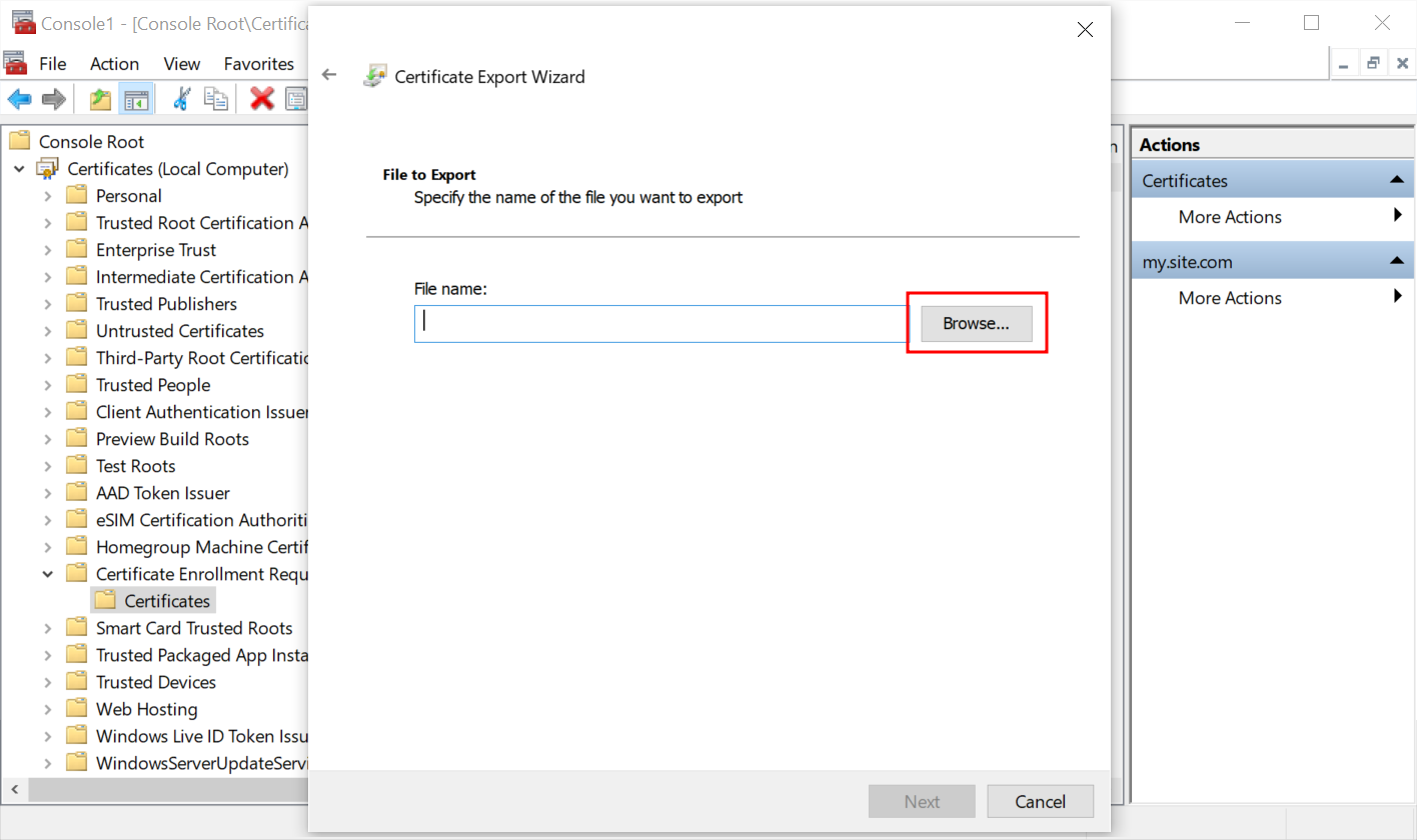

  25. Click the Browse… button to select where the files should be saved and set the filename. Press Next.
  26. Check the displayed data and press Finish.

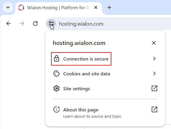

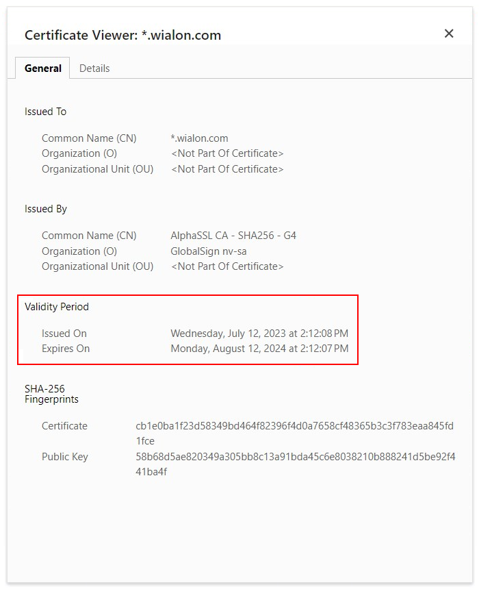

How can I know when the certificate expires?
The easiest way is to visit your site by following the instructions:

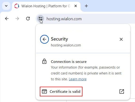

  1. Open your site in the browser.
  2. Click on the icon near the address bar of the browser.
  3. In the pop-up window, click on the Connection is secure.
  4. Then click on the Certificate is valid.
  5. Check the field Expires On in the new window.
