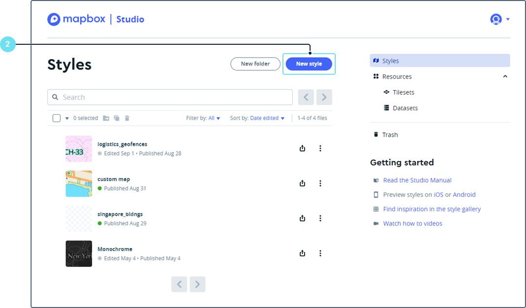

  1. Sign up at www.mapbox.com

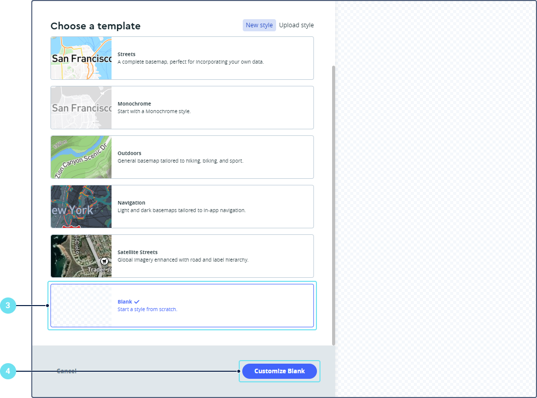

  2. Go to studio.mapbox.com and click New Style.
  3. Select the style Blank.
  4. Click Customize Blank.

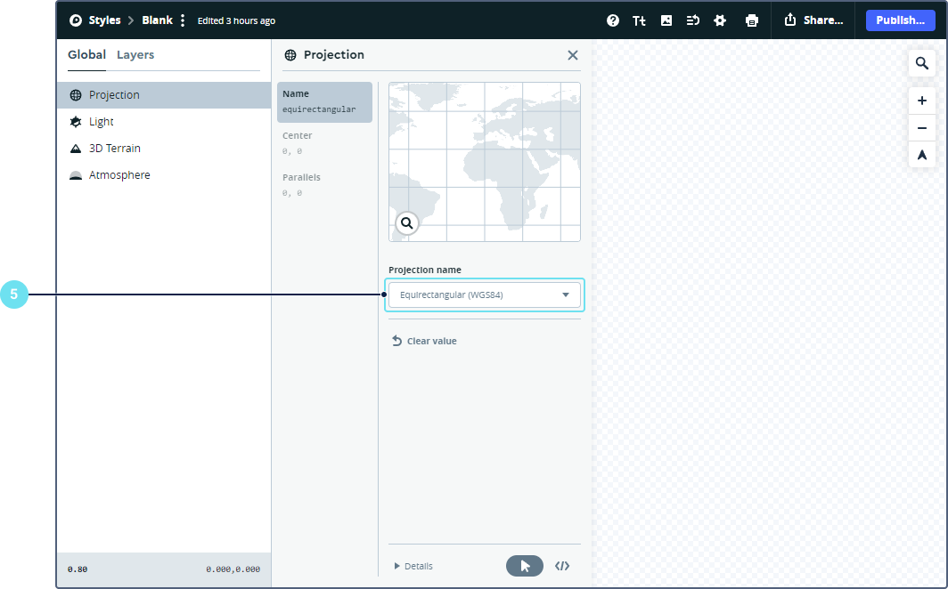

  5. In the Projection section of the Globe tab, select the Equirectangular (WGS84) projection.

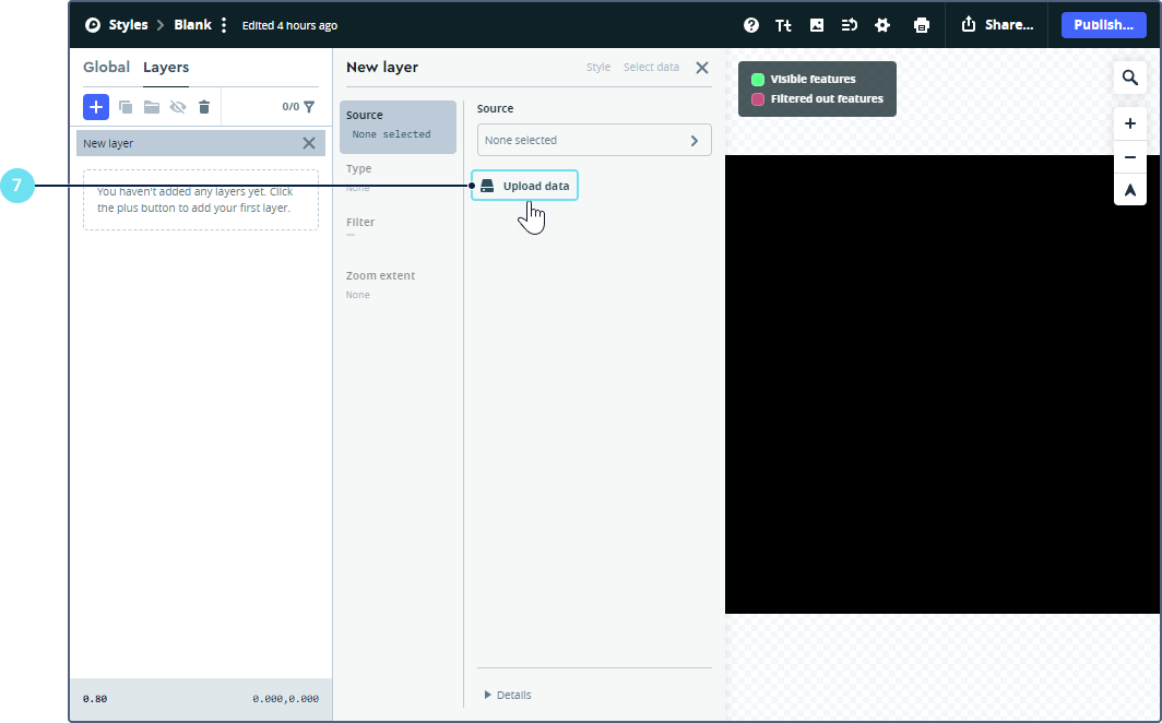

  7. Click Upload data and upload your data.

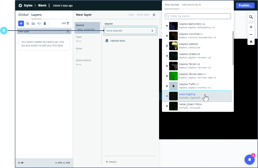

  8. Select the uploaded file in the Source list.

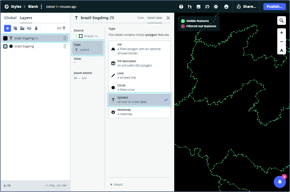

  9. In the Type section, select the data type, if necessary.

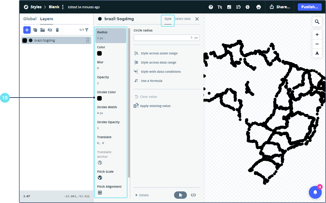

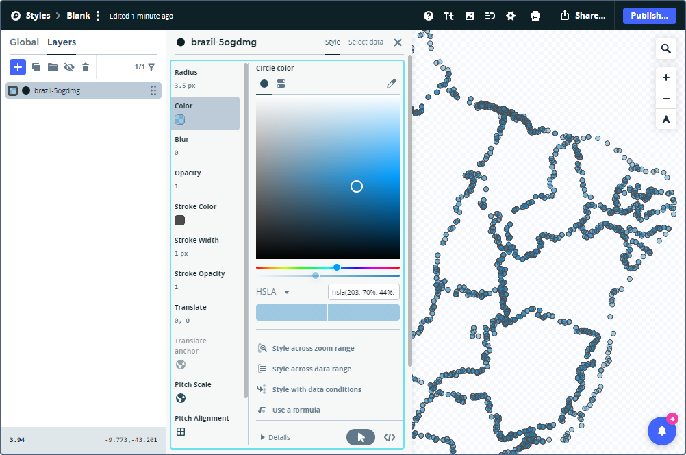

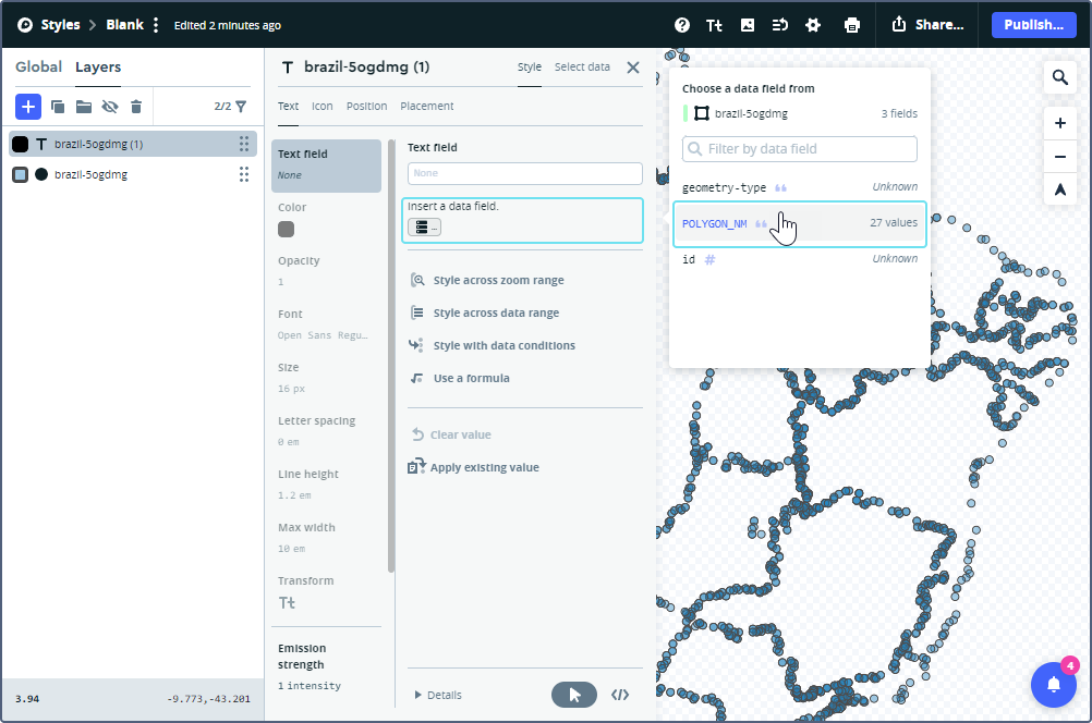

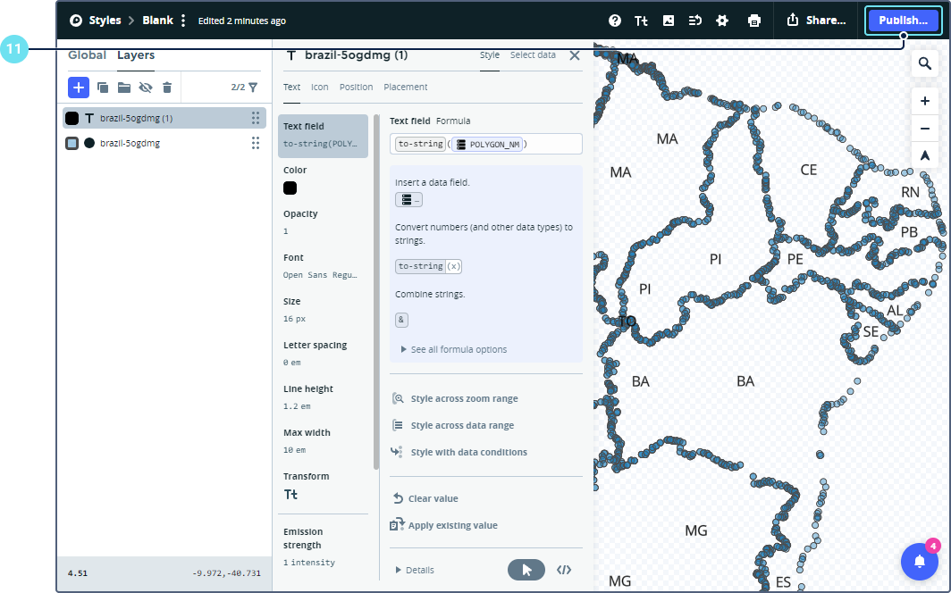

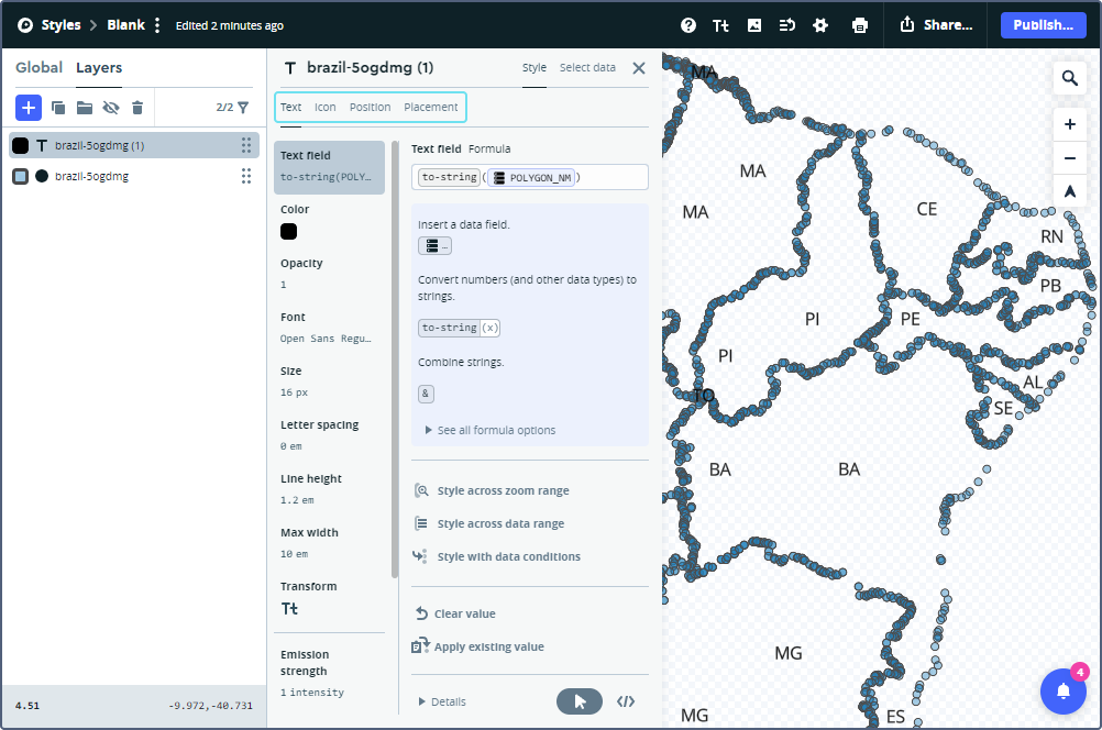

  10. If necessary, edit the style of the selected layer on the Style tab. You can add multiple layers, captions, adjust color, stroke, borders, font, etc.
    Example of customizing the style of a point layer
    Example of adding and customizing captions Add the same or a different layer which contains a table of attributes with the fields required for captions. Select the Symbol type. In the Text field section of the Style tab, click Insert a data field and select the required field (in the example, this is POLYGON_NM). Customize the captions on the Text, Icon, Position and Placement tabs.
  11. Click Publish to save the changes.

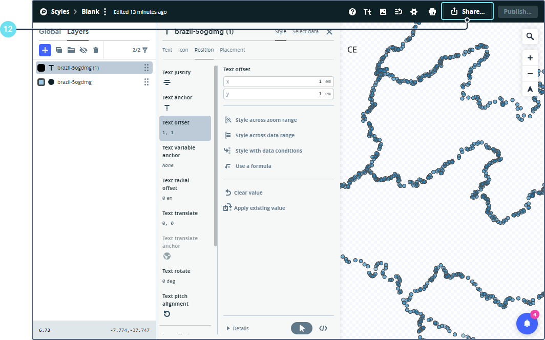

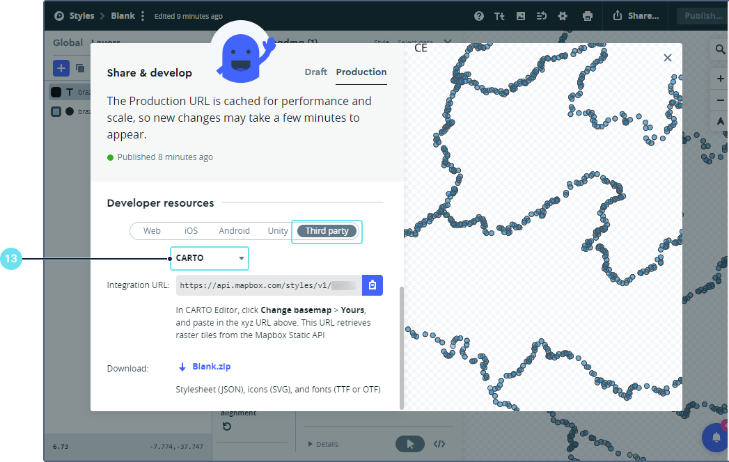

  12. Click Share…
  13. In the Developer resources section of the Third party tab, select CARTO.
  14. Copy the link.
    The link should have the following format:  https://api.mapbox.com/styles/v1/user_name/ID/tiles/256/{z}/{x}/{y}?access_token=TOKEN  where user_name, id, TOKEN are custom parameters.

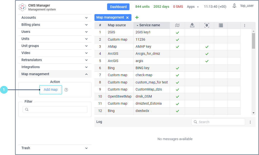

Adding a custom map in Wialon

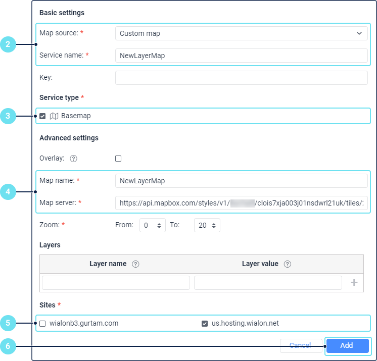

  1. In the Map management section of CMS Manager, click Add map.
  2. Specify the following basic settings:
    Setting Description
    Map source Select the Custom map source.
    Service name Specify a custom name (for example, NewLayerMap).
  3. Select the Basemap service type.
  4. Specify the following advanced settings:
    Setting Description
    Map name Specify a custom name (for example, NewLayerMap).
    Map server Paste the link copied from Mapbox Studio.
  5. Select the sites where the new map should be available.
  6. Click Add.

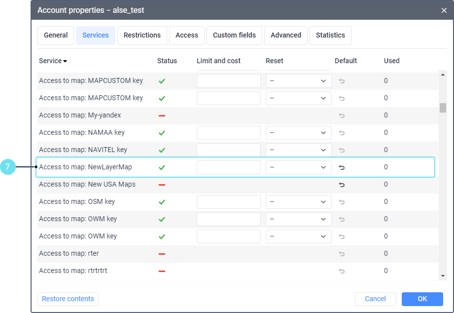

  7. Make sure the Access to map: NewLayerMap service is activated in the required account and all the parent accounts.

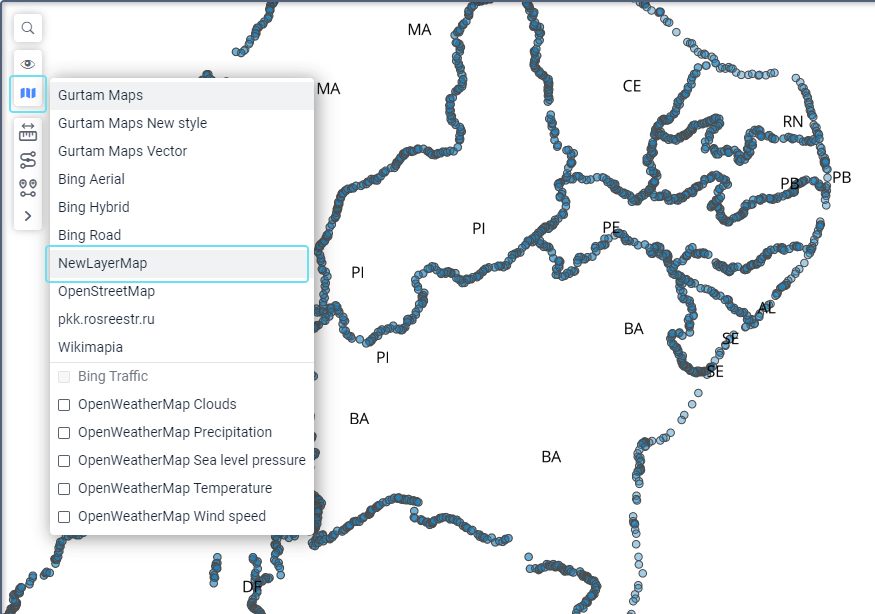

  8. Log in to the monitoring system using the site selected in step 5.

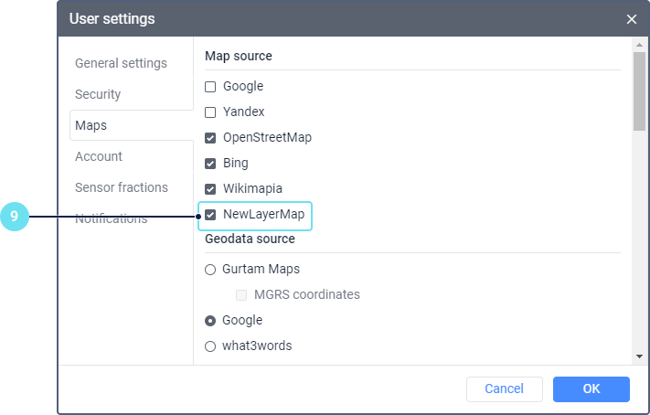

  9. Enable the new map in the user settings.
The configuration is complete. To use the custom map, select it in the map selection menu.
