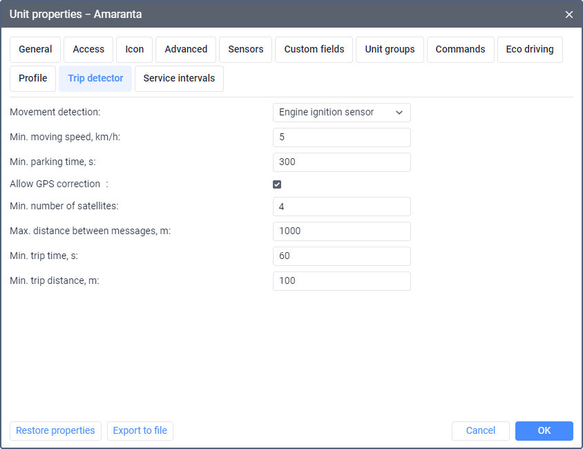

Movement parameters
After you select the movement detection method, specify values of parameters which should be taken into account in trip, stop and parking intervals.
ParameterDescription
Min. moving speed
The minimum speed value which should be considered as the beginning of movement. It is specified so that the outliers of GPS coordinates and device errors are not considered as movement when the unit is parked.
If you specify 0 for this parameter, the unit stops are not detected. In this case, the system detects only trips and parking intervals.
Min. parking time
To detect parking intervals, specify the minimum number of seconds during which the unit should be motionless in order for the system to consider it as parked. If the unit has been parked for less than the specified time, it is considered as a stop within the trip.
If during a trip the time between two successive messages is greater than or equal to the specified value, the trip ends.
If the Allow GPS correction option is enabled, the minimum value of this parameter should be 10 seconds.
The Allow GPS correction option is always enabled for the Speed and GPS coordinates movement detection methods. If you use another method, you can disable this option. If the option is enabled, you should specify the values of the following parameters:
Min. number of satellites
Specify the minimum number of available satellites to detect a trip. The recommended number is at least four.
Max. distance between messagesSpecify the maximum distance between two messages after which the current movement interval should be stopped and a new one started. This value should be indicated in meters.
Min. trip timeSpecify the minimum movement time in seconds which should be considered as a trip. This is required to exclude false detections of trips, for example, during short movements in a car park or a traffic jam. This parameter is applied to a sequence of messages.
Min. trip distanceSpecify the minimum distance in meters which the unit should travel so that its movement is considered as a trip. This is required to exclude possible equipment errors when determining the unit location. This parameter is applied to a sequence of messages.
