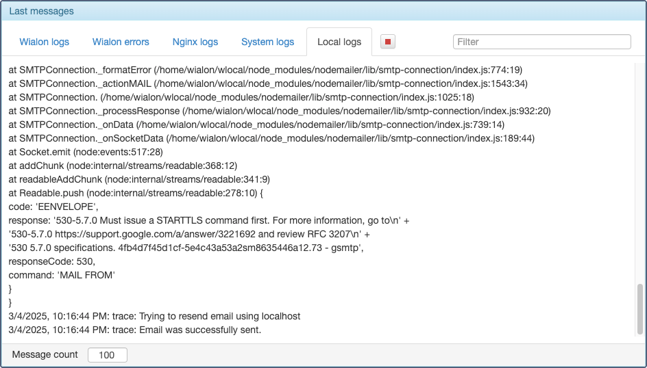

Logs
On this page, you can observe different kinds of logs kept in the system. The last hundred messages are available for (in parentheses you can see their physical location on your server):
  • Wialon Local logs (/home/wialon/wlocal/logs/trace.log*)
  • Wialon Local errors (/home/wialon/wlocal/logs/error.log*)
  • Nginx logs (/var/log/nginx/error.log*)
  • System logs (/home/wialon/wlocal/logs)
  • Wialon Local logs of the administration site (/home/wialon/wlocal/logs/lcm/lcm.log\*)
New messages are added to the bottom.
In the upper right corner, there is a dynamic filter that allows sorting the log’s contents according to the introduced value (corresponds to the grep utility).
You can also adjust the number of lines shown in the log. To do this, enter the necessary number in the line Messages cont below (corresponds to the tail utility).
It is possible to stop or start the log using the buttons red square and green triangle pointing right, respectively. If the log is stopped, the two options described above cannot be applied to it.
