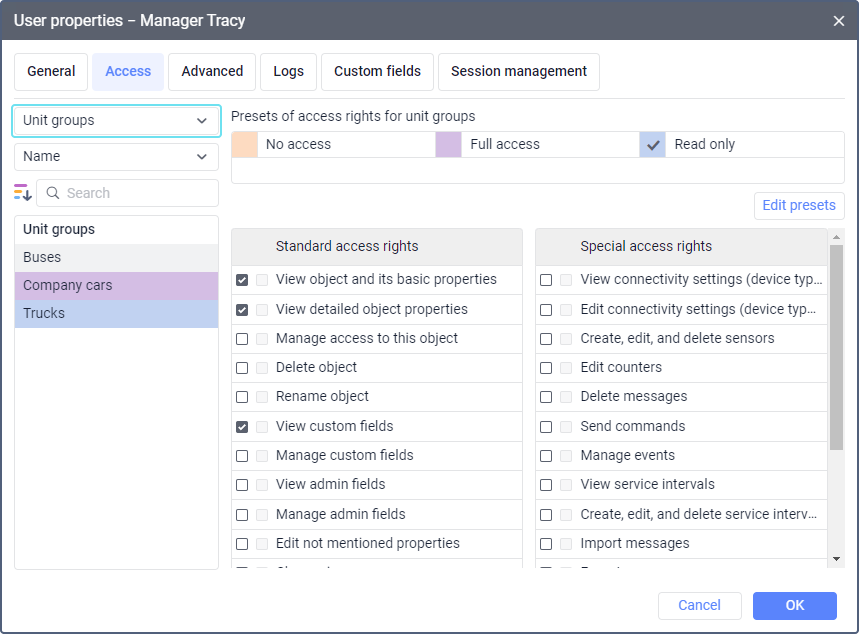

You can change access rights to a unit group in two ways: in the properties of this group or in the user properties. In the user properties, you should select Unit groups in the filter, mark the required group in the list and select the rights the user should have to this group. Read more about granting access rights here.

Access right Description
View object and its basic properties Allows seeing the group and its units on different lists and tabs, tracking the unit movement on the map in real time, and, if route access rights are granted, allows tracking the unit movement along the route.
If this access right is granted, the General tab is displayed in the unit group properties. The right also allows seeing data in the unit properties, unit tooltips and extended information.
