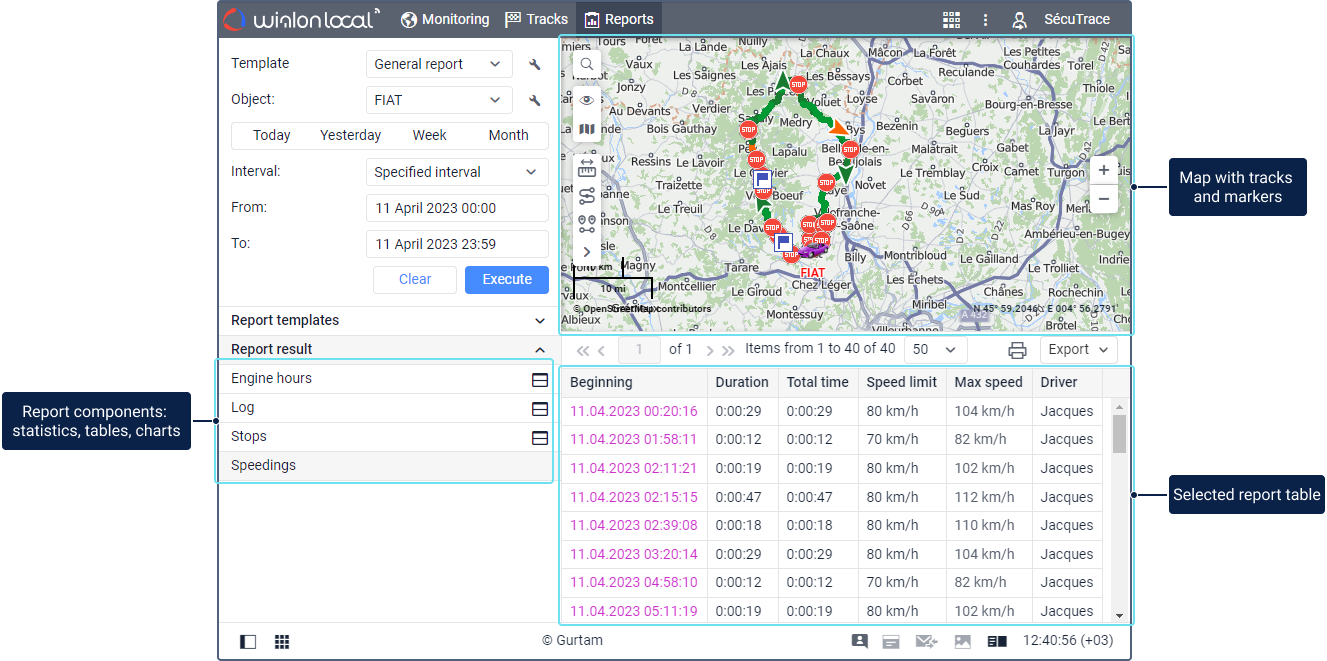

Below are the components of the report executed in the monitoring system. It includes several tables, a chart, a map with tracks and markers.
The image shows one of the report tables (Speeding) and a map.
The image below shows the same table and the speed chart.
