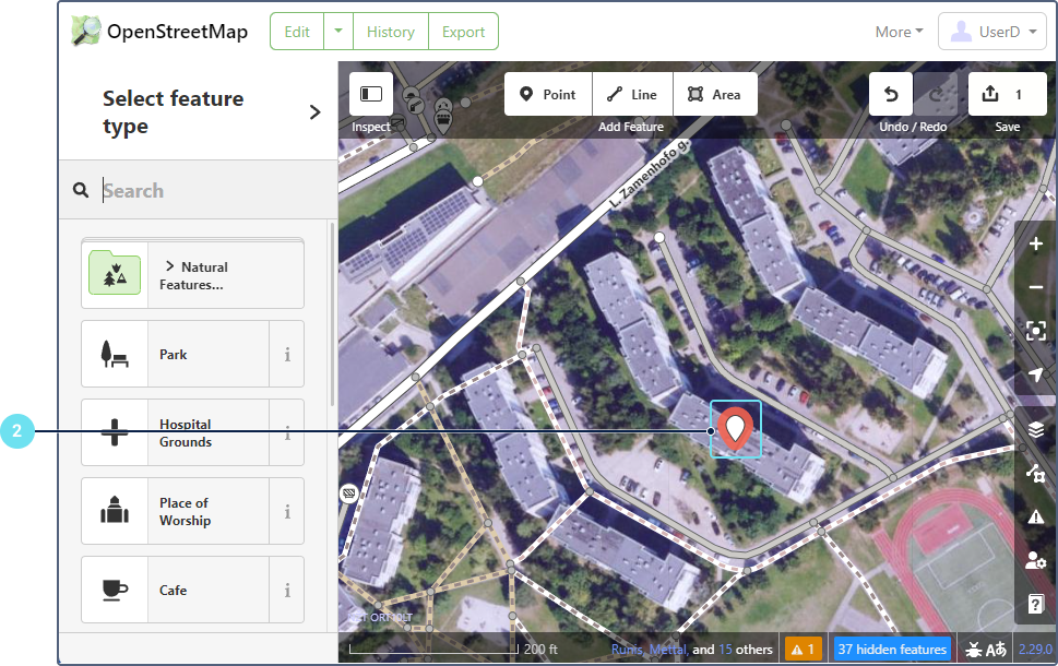

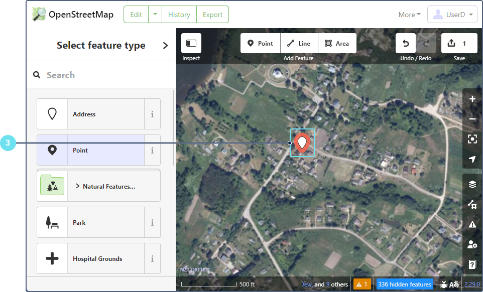

Adding an address point
To add an address point, follow the steps below.
Zoom in on the required location.
Select the Point tool.
Click where you want to place the address.
Select Address in the sidebar. To find this item, you may need to type Address in the search field.

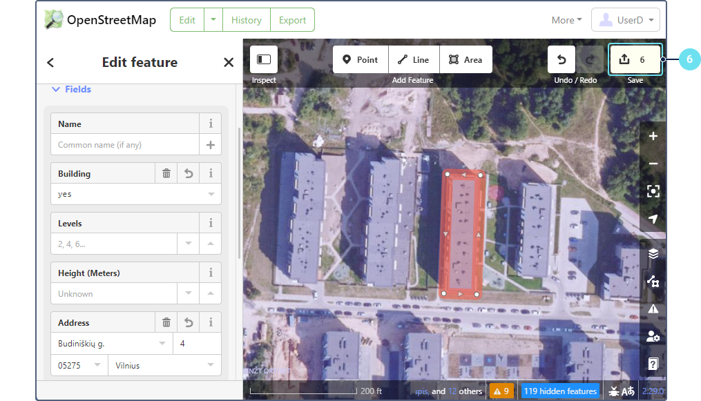

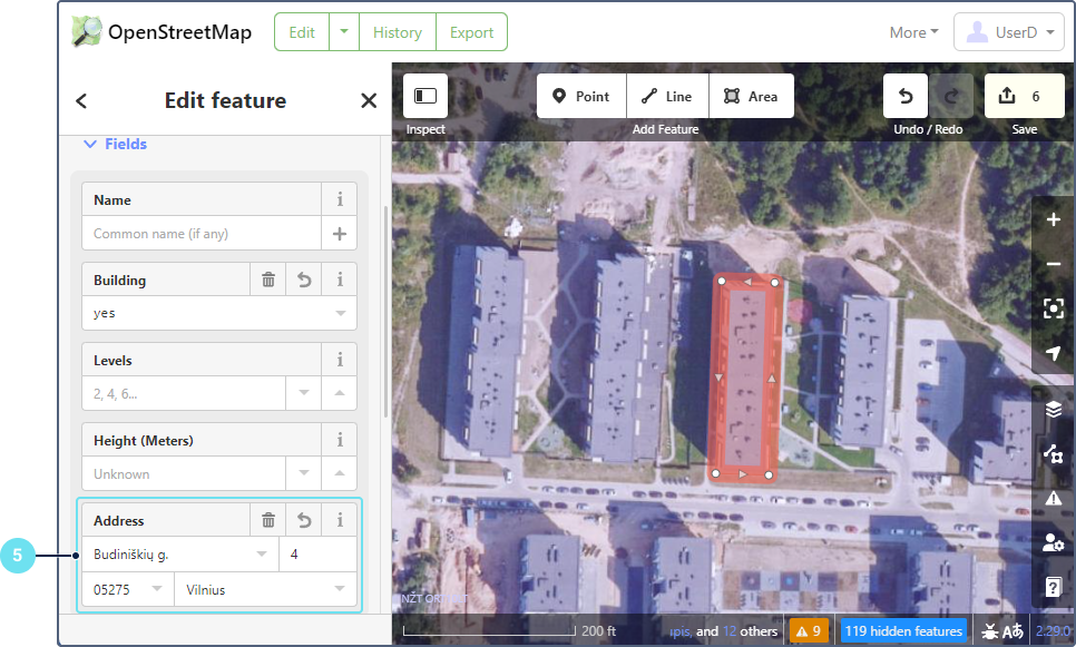

Adding a building polygon
To add a building polygon, follow the steps below.
Zoom in on the required area.

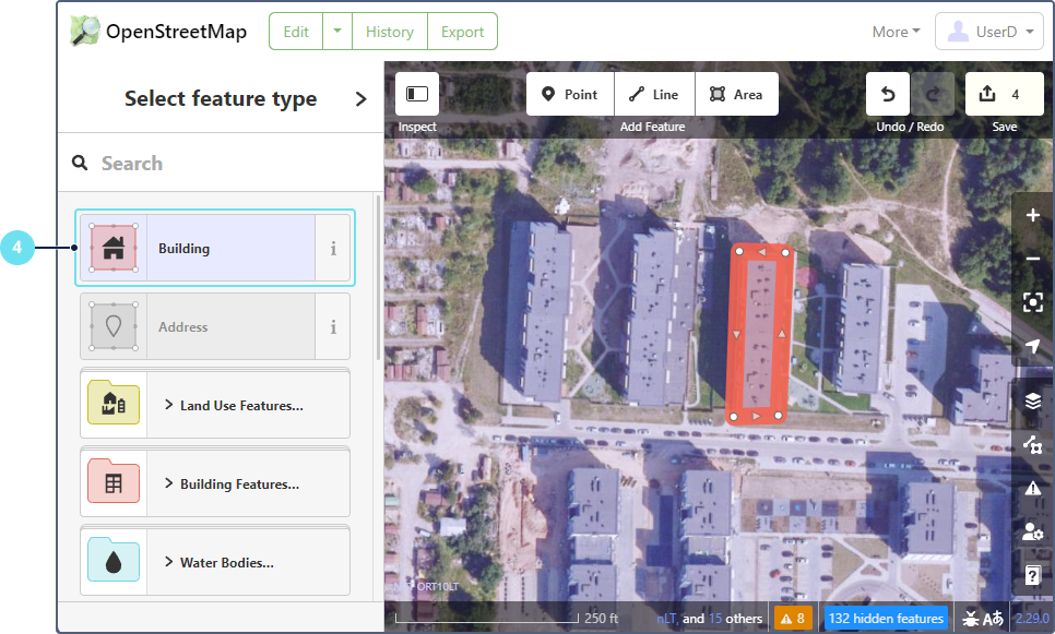

Select the Area tool.
Outline the building. Press Q on the keyboard to square the corners.
Select Building in the sidebar.
Fill in the address details.
Click Save (or press Ctrl+S on the keyboard).
Review the changes and upload them. See Reviewing and completing.

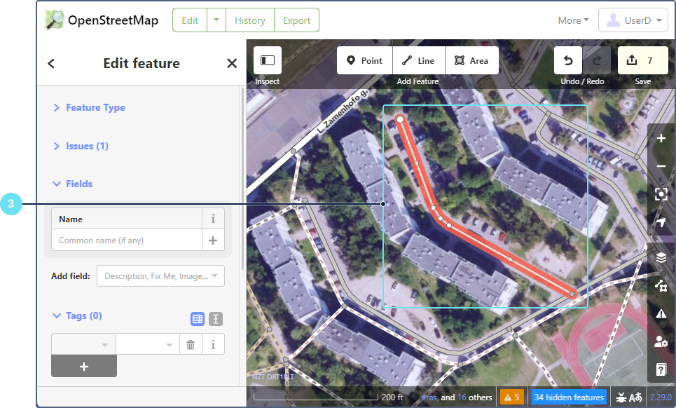

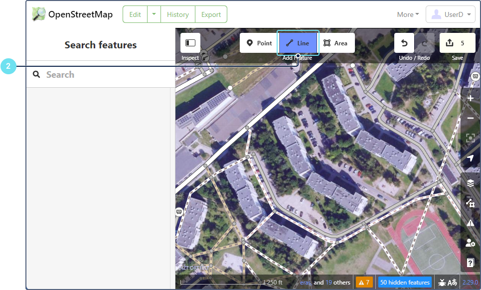

Adding a street
To add a street, follow the steps below.
Zoom in on the street location.
Select the Line tool.
Draw the street path.

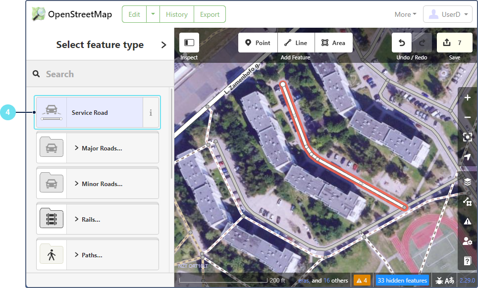

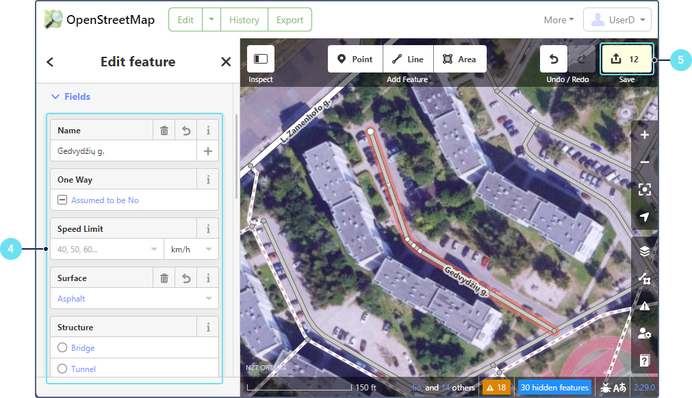

Select the appropriate highway tag. Read more about highway types here. In our example, it is a service road.
Add the road name and other tags if needed.

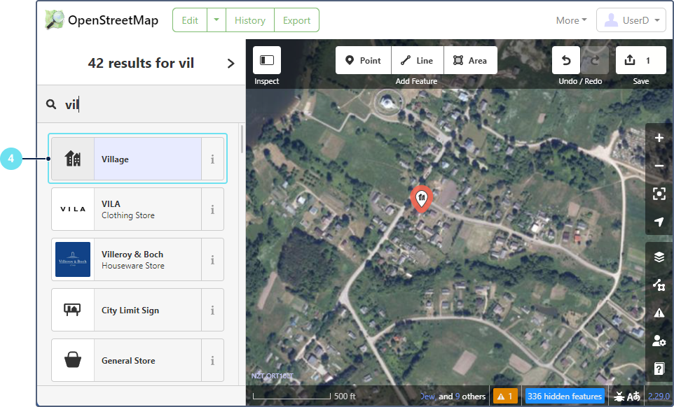

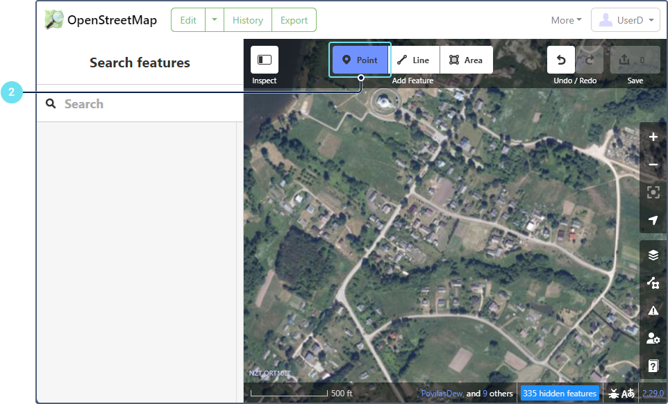

Adding a place of the point type
To add a place of the point type, follow the steps below.
Click where the place should be located.
In the sidebar, select the place type (for example, hamlet, town, city, village).
Specify the relevant details, such as the name and additional tags.

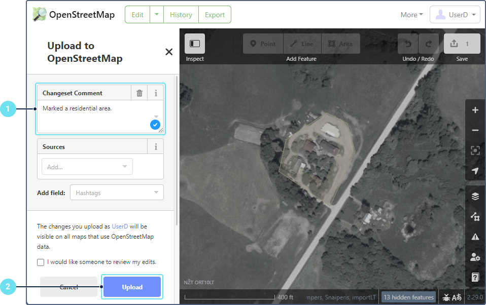

To finish adding address information, follow the steps below.
Carefully review your changes and write a comment so that other OpenStreetMap users can understand what has been changed.
Click Upload.
Copy the link that is shown after uploading and send it to support@wialon.host. If you have made several changes, you can report your OpenStreetMap username and coordinates of the places you have edited.
After we check the changes you have made, we will add them to Gurtam Maps. The updated address information will be available for all users.
