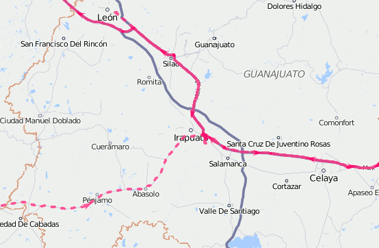

A point-to-point track that is built according to the preset parameters will appear on the map (if the unit has any messages with the coordinates for the period). If it takes too long for the track to appear on the map, it means you either indicated an interval that is too long or your Internet speed is too low.
If within the indicated period the unit was not moving, there will be no track on the map. However, it can be found in the list of tracks below, and the distance traveled will be 0 km.
A track or its part can be displayed on the map as a dashed line. Such a situation indicates that the data in this part of the track might be inaccurate. For instance, the maximum interval between the messages is exceeded (see the Advanced tab) or the number of satellites is less than 4 (if the validity filtration of messages is disabled).
When the private mode of the trip is detected (if the unit has the Private mode type sensor with the Do not show unit location option enabled), the work trips are connected with the straight dashed line.
