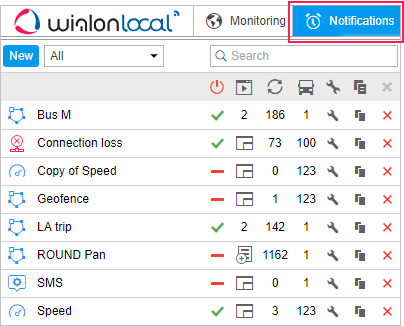

To create, edit, and view notifications, open the Notifications panel by choosing a corresponding name in the top panel or clicking on the necessary item in the main menu customizer.

  1. Click the New button.

  8. Click OK. The created notification appears in the list in the left part of the window.
