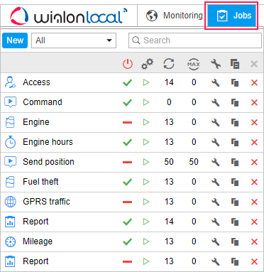

To configure jobs, open the Jobs panel by selecting a corresponding name in the top panel or clicking on the Jobs item in the main menu customizer. Here you can see the list of all created jobs and information on their state.
In the list, the jobs are sorted by name. For the convenience of search, use the dynamic filter. Input job name or its part into the search box and observe the results. You can also filter jobs by the resource they belong to. To do so, use the drop-down list above the list.
The tooltip that appears when you pause the mouse cursor on the job name displays the complete information about the job: job type, parameters, schedule, time of the last attempt of job’s execution, resource (if there is access to several), and other parameters depending on job configuration. In columns on the right, you can see the job’s state (on/off), the number of executions already made, and the number of maximum executions allowed.

In the panel, the following icons and buttons are used:
Job type
Different kinds of jobs are marked with special icons in the first column:
 : command execution;
 :  sending report by email;
 : sending information about fuel by email or SMS;
 :  access management;
 :  job on mileage counters;
 : job on engine hours counters;
 :  job on GPRS traffic counting.
Click on the job state sign in the header of the table to enable or disable all jobs at once (if you have access rights to them).
Icons and enable and disable the job.
Job's test execution column. Test execution can be run for a particular job only. To run it, click .
The first (left) column shows how many successful executions took place; the second (right) column shows the maximum number of executions allowed.
Buttons to view and/or alter job properties (depending on your access rights).
Create a new job on the basis of the selected one.
Delete the selected job.
If the job belongs to some resource to which you do not have the Create, edit, and delete jobs access right, enabling and disabling, editing, or deleting of the job will be unavailable.
