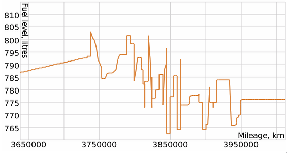

The chart with the disabled filtration:

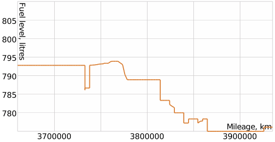

The chart with the enabled filtration:
