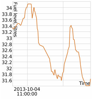

This is the chart with no ignoring:

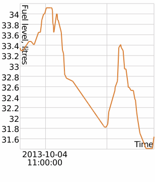

The chart with the ignore option turned on:
