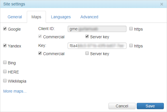

Maps are connected for each site individually. By default, users get access to WebGIS Maps and OpenStreetMap. You can also use other maps: Google, Yandex, Bing, HERE, WikiMapia, OpenStreetMap, Visicom, Regio, 2GIS, Luxena, MyIndia, Kosmosnimki, ArcGIS, Geoserver, GoMap.Az, OpenSeaMap, Mapbox, what3words, OpenWeatherMap, AerisWeather, AMap, Namaa. Most of them require an activation key.
Verify that you have activated the maps in the user settings in the monitoring system.
Specify the required maps. Depending on the type of a selected map, you may need to set up additional parameters.
Google
Indicate the activation key. For Google Maps, you can specify a personal or a commercial key (the Commercial option). If the settings of the keys for server requests have already been specified, the Client ID field is automatically filled in once you activate the Server key option. To make the map operate using a secure protocol, activate the https option.
Yandex
Indicate the activation key. For Yandex Maps, you can specify a personal or a commercial key (the Commercial option). If the settings of the keys for server requests have already been specified, the Client ID field is automatically filled in once you activate the Server key option. The Yandex key for the Logistics application is sent from the site specified in the Base URL field of the general settings. To make the map operate using a secure protocol, activate the https option.
