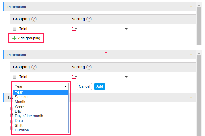

When adding a new grouping, click Add grouping, select a time interval in the appeared drop-down list and click Add.
From the available time intervals (year, season, month, week, day of the month, day, date, shift, duration), select those based on which you want to group the tabular data. Grouping can be either single- or multi-level. Multi-level grouping implies that there are several groupings for different time intervals. When using it, it is required to assign a hierarchy (specify nesting). For example, the grouping can be as follows: tabular data is grouped by year, within each year by months, and within months by days. Nesting is adjusted by dragging the intervals in the Grouping column up or down, with the elements above in the list containing the ones that are located below.

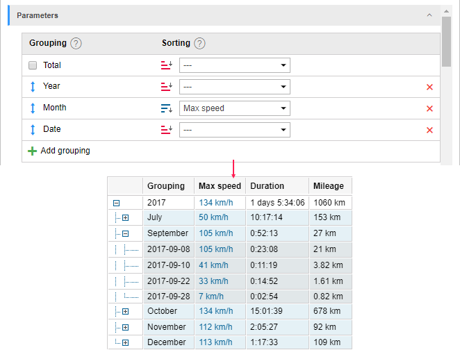

Example
Let us consider the example of grouping and sorting use.
We create a report on trips. In this report, we are interested in maximum speed, duration, and mileage. Mark these columns. In addition, the information should be grouped by years, months and dates; the dates, in turn, should be sorted by the maximum speed (from high to low).

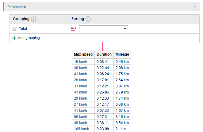

By default, there is no grouping, i.e. without adding grouping or sorting settings, we would get a detailed report where an individual line would correspond to each criterion. These lines would be arranged in chronological order or according to the sorting, indicated next to the Total grouping.
In order to get the result that corresponds to our task, we need to add the Year, Month and Date groupings. If necessary, we can move the grouping criteria to the desired position in the list (we need the Year –> Month –> Date sequence).
Next, we determine the sorting criteria and the direction. Since we want to set sorting for the level nested in months (for dates), we select the corresponding criterion from the drop-down list of months. Then click the icon of sorting direction to adjust it from a bigger to a smaller value.
By default, the data is sorted in chronological order.
The report looks as follows:
Compared to the table for which the grouping and sorting settings are not specified, this table has two additional columns. The first one is a column containing the ‘+’ and ‘-’ buttons, which help show/hide nesting levels. The second is the Grouping column, which shows the levels themselves. The information in the table is grouped by years, and by clicking on the plus the next levels of grouping (months, dates) are opened. The dates are sorted by the maximum speed (from high to low).
