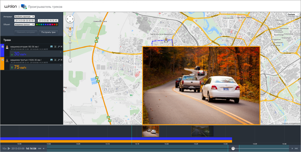

There are the following elements in the Track Player interface:
ElementDescription
MapUsed to display the built tracks of units. Located in the central part.
Track building barUsed to indicate the initial parameters for building a track. Located at the top of the map to the left.
List of tracksUsed to display general information on tracks. Located below the track building bar.
Player control barUsed to control the playing of tracks. Located at the bottom.

Unit name, mileage, date and time of the first and the last message are displayed on the track list. Using the Go to the first message/Go to the last message arrows, you can place a unit in the beginning or in the end of a track on the map correspondingly. If you click on a unit icon, the map is centered on the current location of the unit. There are up to four control buttons opposite to every track: show/hide photos, follow the unit on the map, settings, delete unit. Their purpose is described below.

The upper part of the player control panel is the chronological scale corresponding to the indicated time interval. Trips on the scale are displayed by colour stripes. If you click on the Show/Hide photos button, smaller-sized photos sent by a unit are added to the scale. This button is available if the equipment supports the photo sending function and there are photos sent during the indicated interval. Point to a photo to enlarge it.
White marks on the scale stand for events registered in the unit history. If you point to such a mark, a tooltip with event description appears. Corresponding marks are displayed on the track as well.
