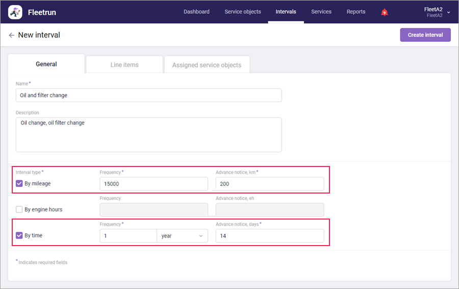

Example
A unit has a service interval for which two types are indicated: by mileage (every 15 000 km) and by time (every year). For each of the types, values 200 km and 14 days are indicated in the Advance notice field.
The service for such an interval should be created either 14 800 km (15 000 - 200) or 351 days (365 - 14) after the previous service.
Suppose a unit traveled 14800 km in 7 months. In this case, the upcoming services are created on the basis of the mileage value. After the service is complete, a new period starts (data from the Starting point field of the unit properties is used).
