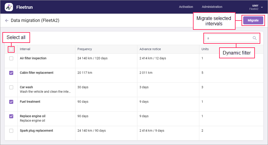

To open the migration page, click on the button in the upper right corner of the fleet administration window.
The table shows the list of service intervals available for migration, as well as basic information on them:
- name and description (if available);
- frequency;
- the number of kilometers/miles, engine hours and/or days that must serve as a signal for the advance creation of services;
- the number of units for which the intervals can be migrated.
A number greater than 1 in the Units column signifies that identical service intervals were created for several units.

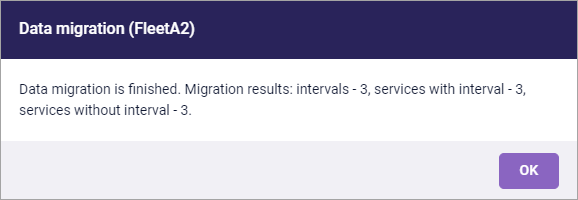

Check the service intervals that should be imported into the application and press Migrate. To quickly find the required intervals, use the dynamic filter above the table. After the migration is complete, a message with its results is displayed.
